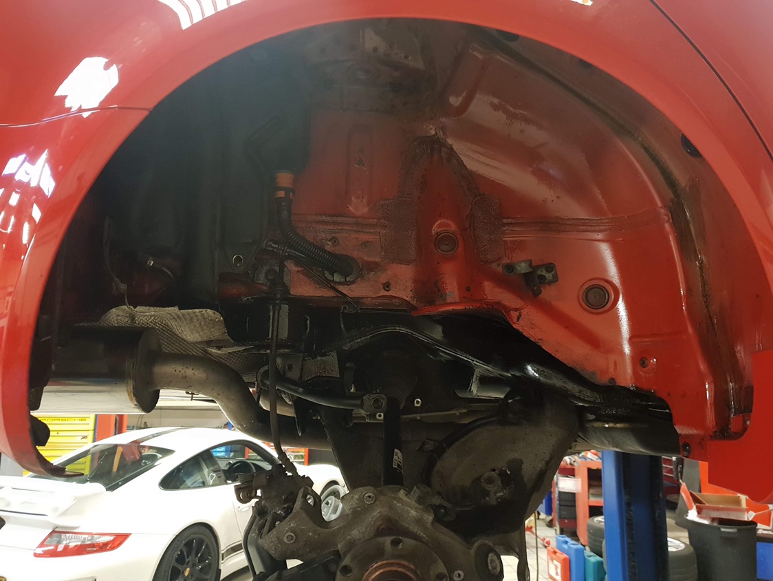

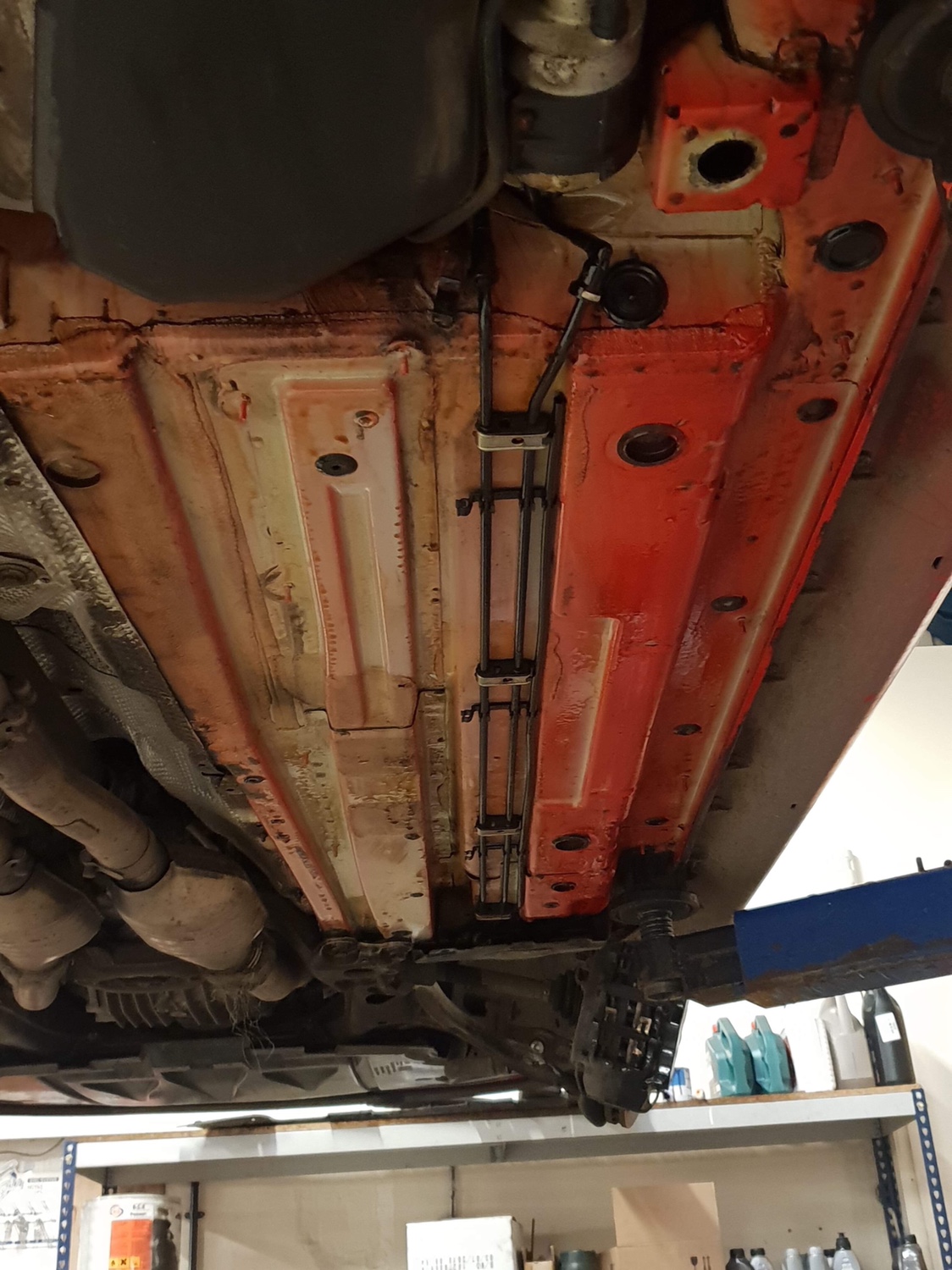

Back end built up now. All cleaned and wax oiled.

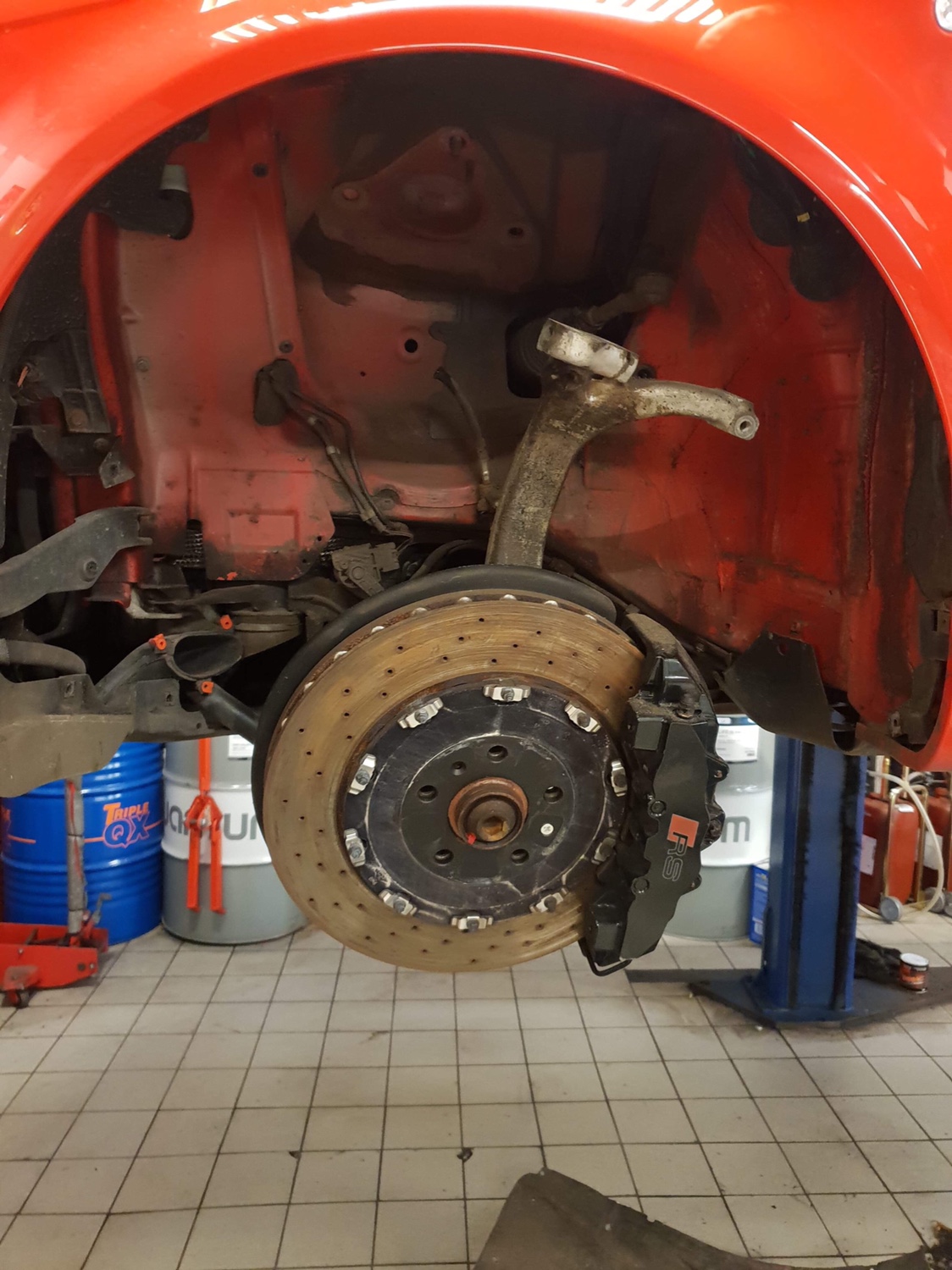

Front end tomorrow. Nice to clean everything and get rid of all the debris collecting behind those arch liners and under body trays.
Amazed at how good the brake lines are compared to the stuff I work on.

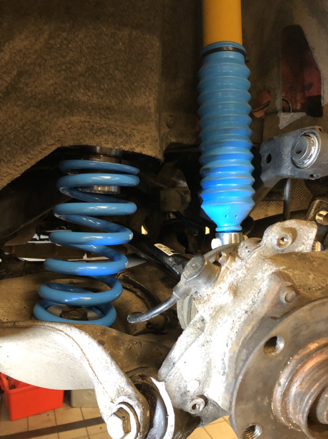

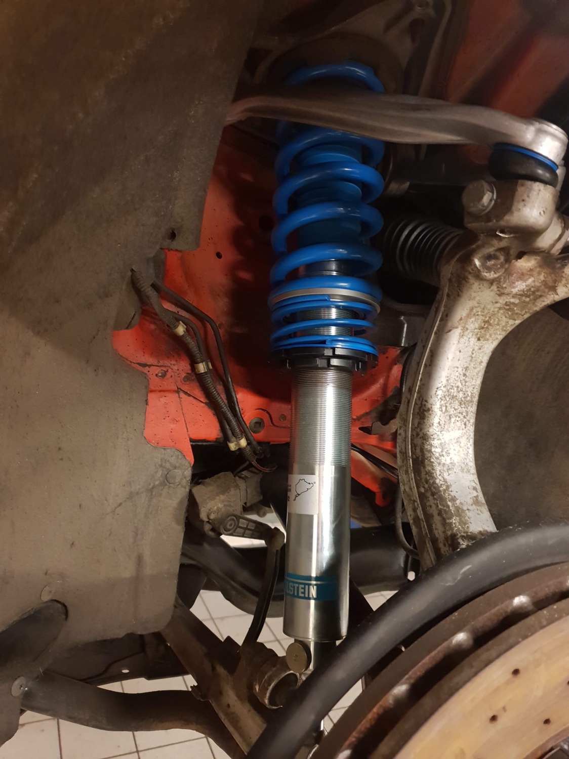

It’s almost completed! All arches cleaned out and wax oiled. Suspension almost fitted. Just need it to settle on the springs for a few days and then corner weight/ride height setup and a 4 wheel alignment on our Hunter aligner. Image
Looks so good in red against the black trim now.

I'm pricing up a suspension upgrade. Bilstien PSS9 seem to be favoured over the K&W V3 for those mortals simply " driving" a B7 RS4 as opposed to racing or tracking one.
Unless of course you go down the Koni route.

jamiej wrote:I'm pricing up a suspension upgrade. Bilstien PSS9 seem to be favoured over the K&W V3 for those mortals simply " driving" a B7 RS4 as opposed to racing or tracking one.
Sent from my ONEPLUS A6013 using Tapatalk
I have KW club sport dampers and springs on my GT3 which are brilliant for track use. For rod use the PSS9 kit like I have just installed is very good.
