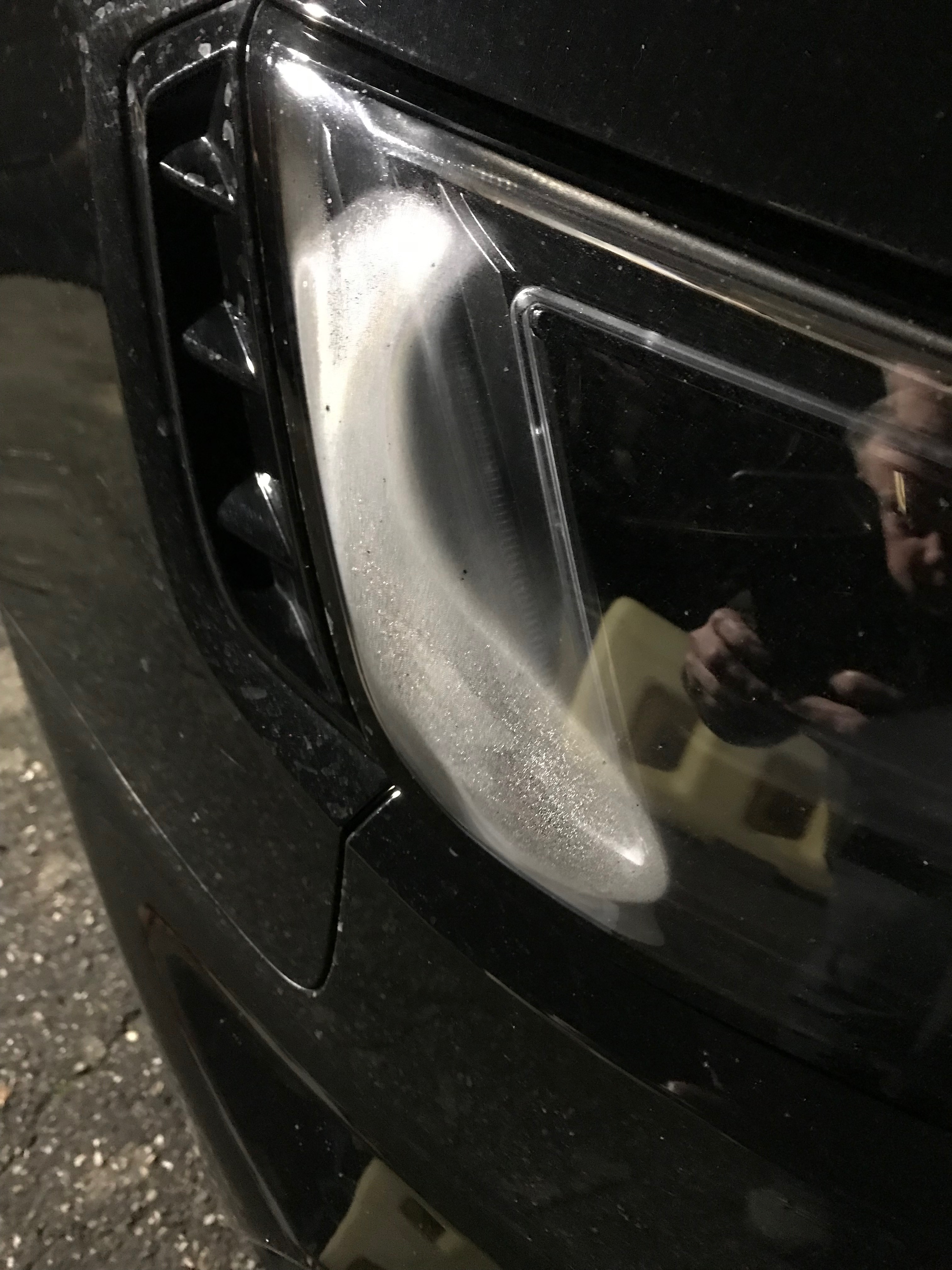

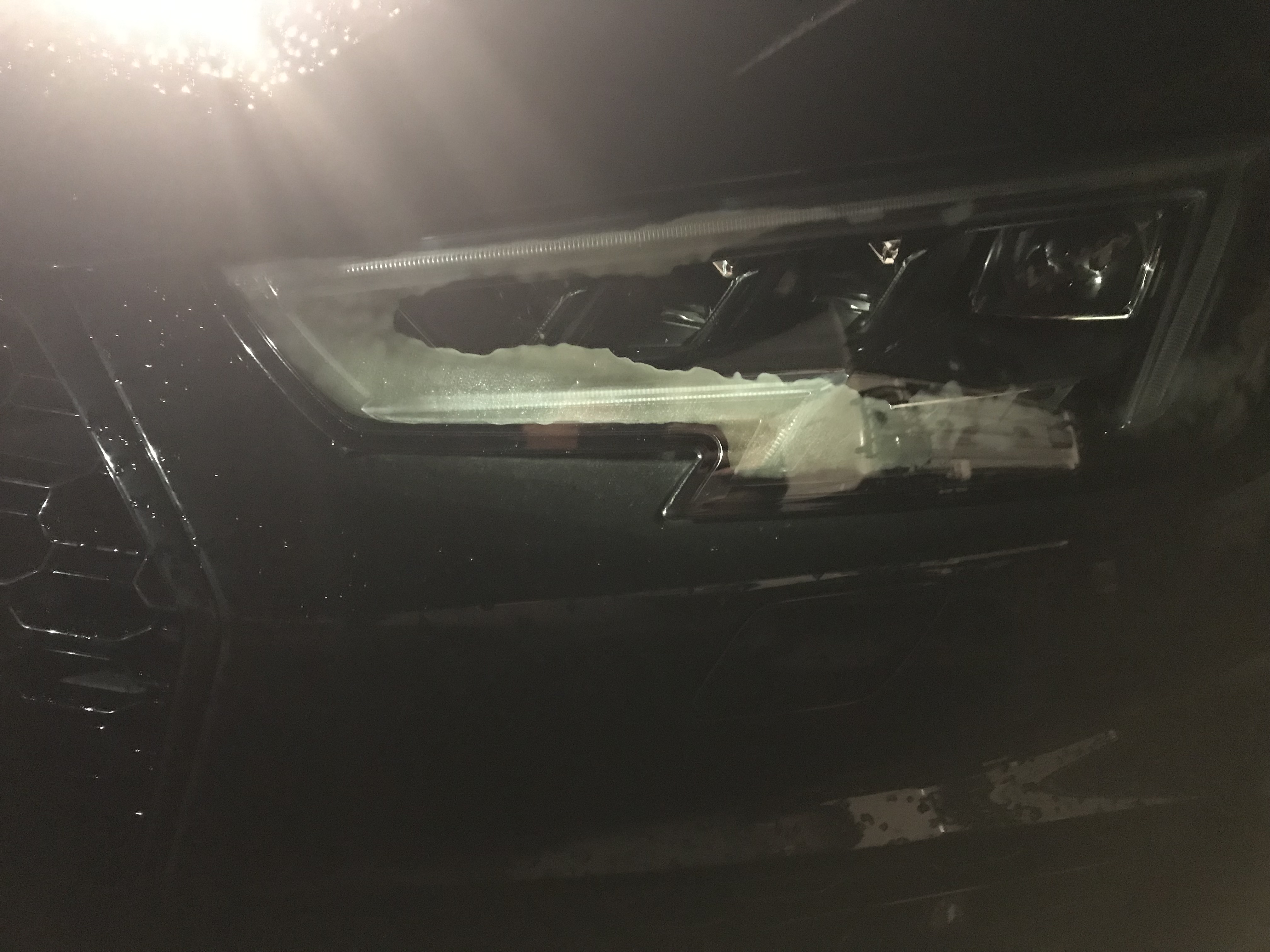

On a rainy day my headlights look like this, anyone else with the same issue?
It disappears after a short while when you drive, but imo it is far from ideal.
Second picture is extreme. At night when I came home, it rained.
After a short while the headlight fogged up inside on the exact place where the raindrops were on the outside of the light.
That part of the lamp cooled down more due to the raindrops on it and thus caught the humidity in the headlight.

I'd be going back to the dealer and having a discussion because that means there is water moisture in there with all the electrical gubbins - sure to invite corrosion and premature failure.

I've contacted them. I was told light condensation was normal.
Only thick droplets was not ok.
Usually it isn't as in the last pic. That happened after a long drive, and ot was still raining.
Condensation appeared where the rain sat.
Do you have condensation on yours when it rains?
They replaced the thermostat and removed the bumper, may that have caused it? Are the lights attaced to the bumper?
I never noticed this before, but it hasn't rained a lot before either...
Anyhow, I have an extended warranty should <beep> hit the fan after a few years.

I had a bit of condensation in mine just one time then never again. If it gets colder I guess it may return.

Mine stay dry - that said it lives in a dry garage with an electric radiator (used to keep the motorcycle warm in Winter) on a time-switch barely a metre away so I'm not really a good example.

Correct, mine's 24/7 outside.
Thanks for the reply Terminator_X. Over here it's around 5°C and rainy.
I just checked, lights are free of fog at the moment.
I drove 2x about an hour yesterday, lights on. Maybe the heat dried it out fully now?
Still something to keep track of.
