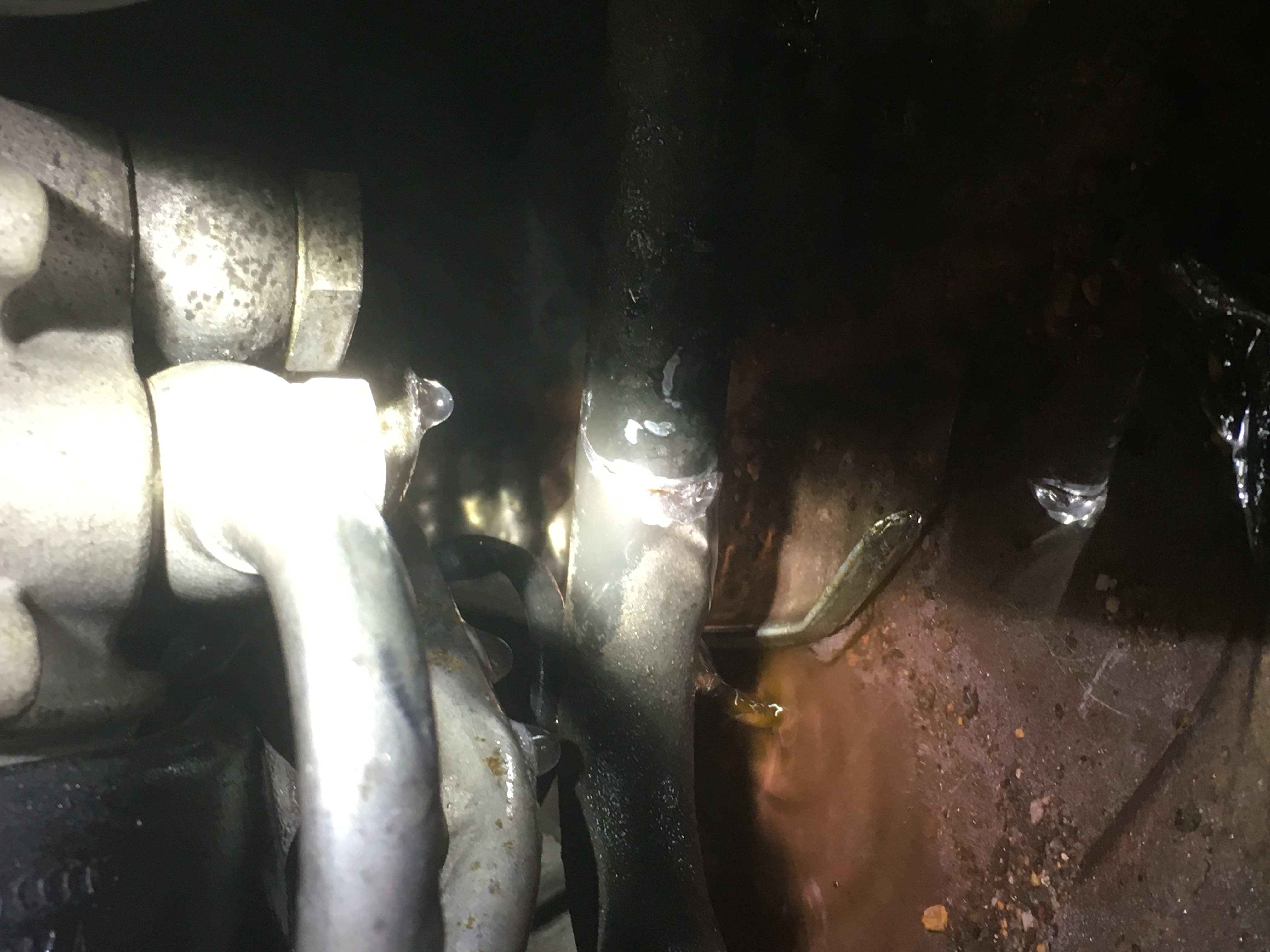

We are up to 2 hours 40 mins so far and I am ready to start refitting now

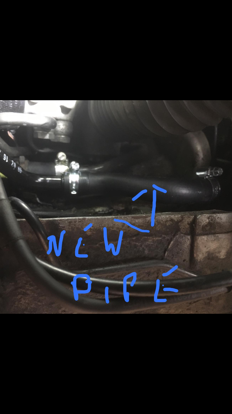

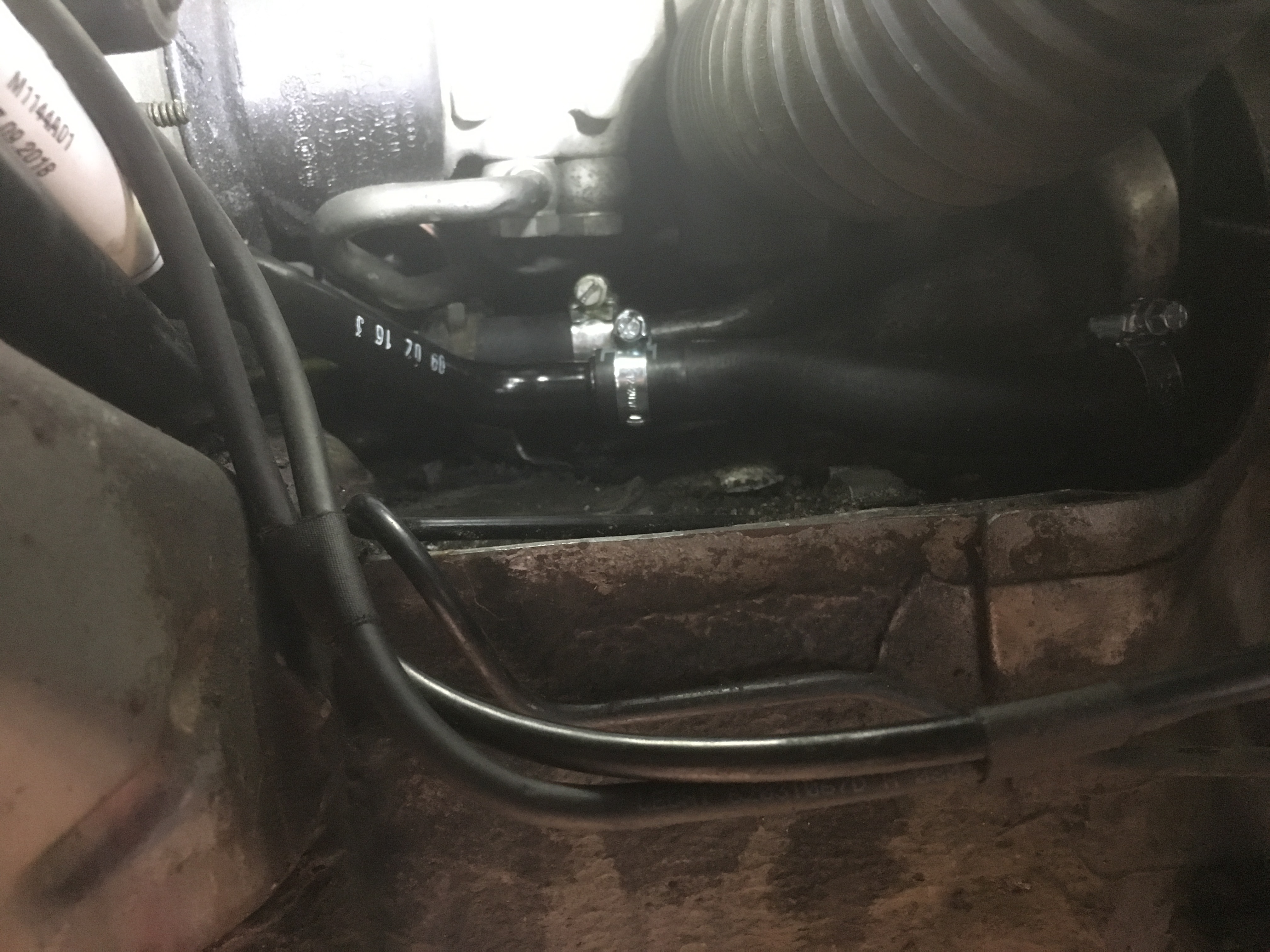

Pipes are on looking good so far

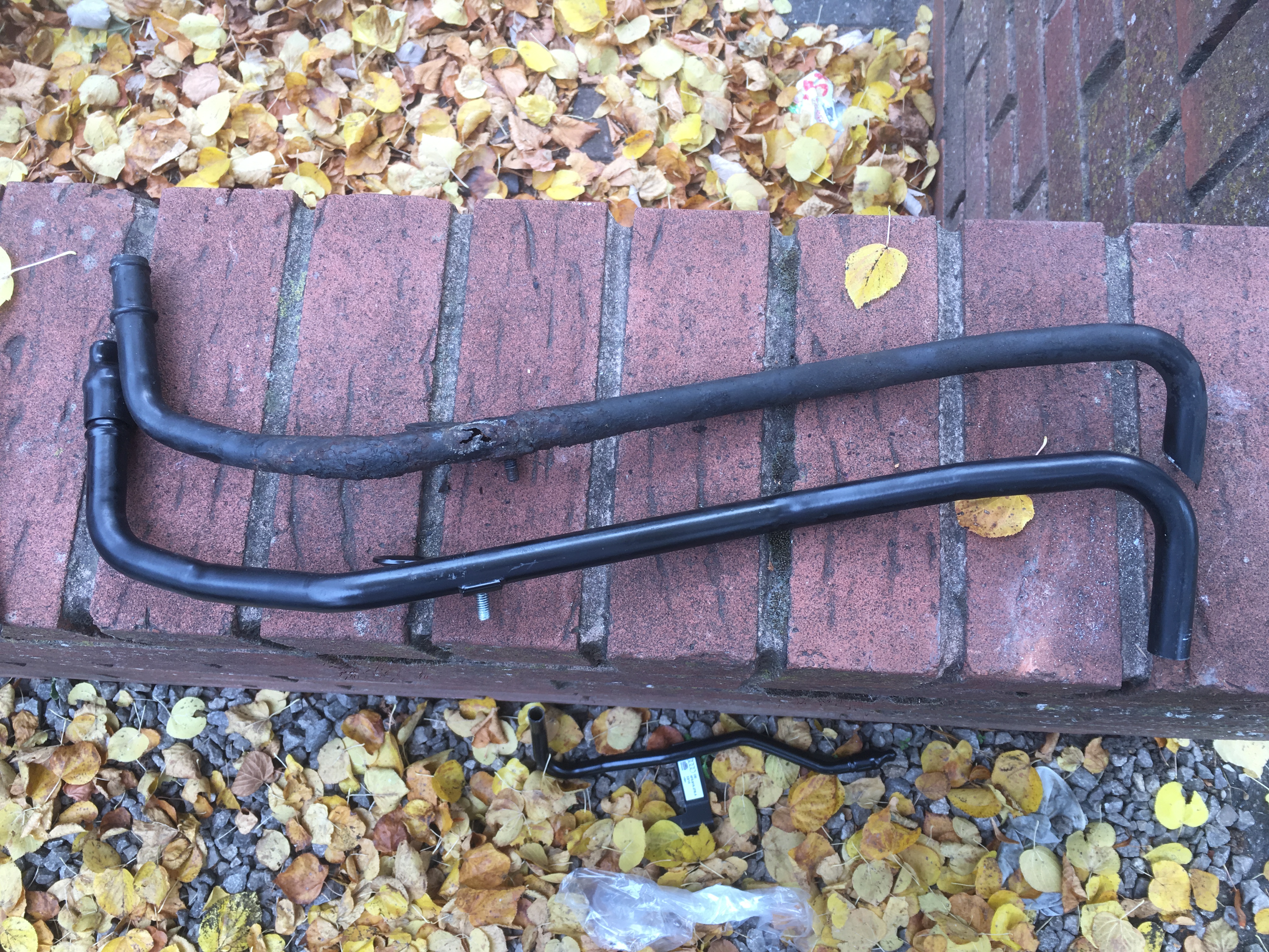

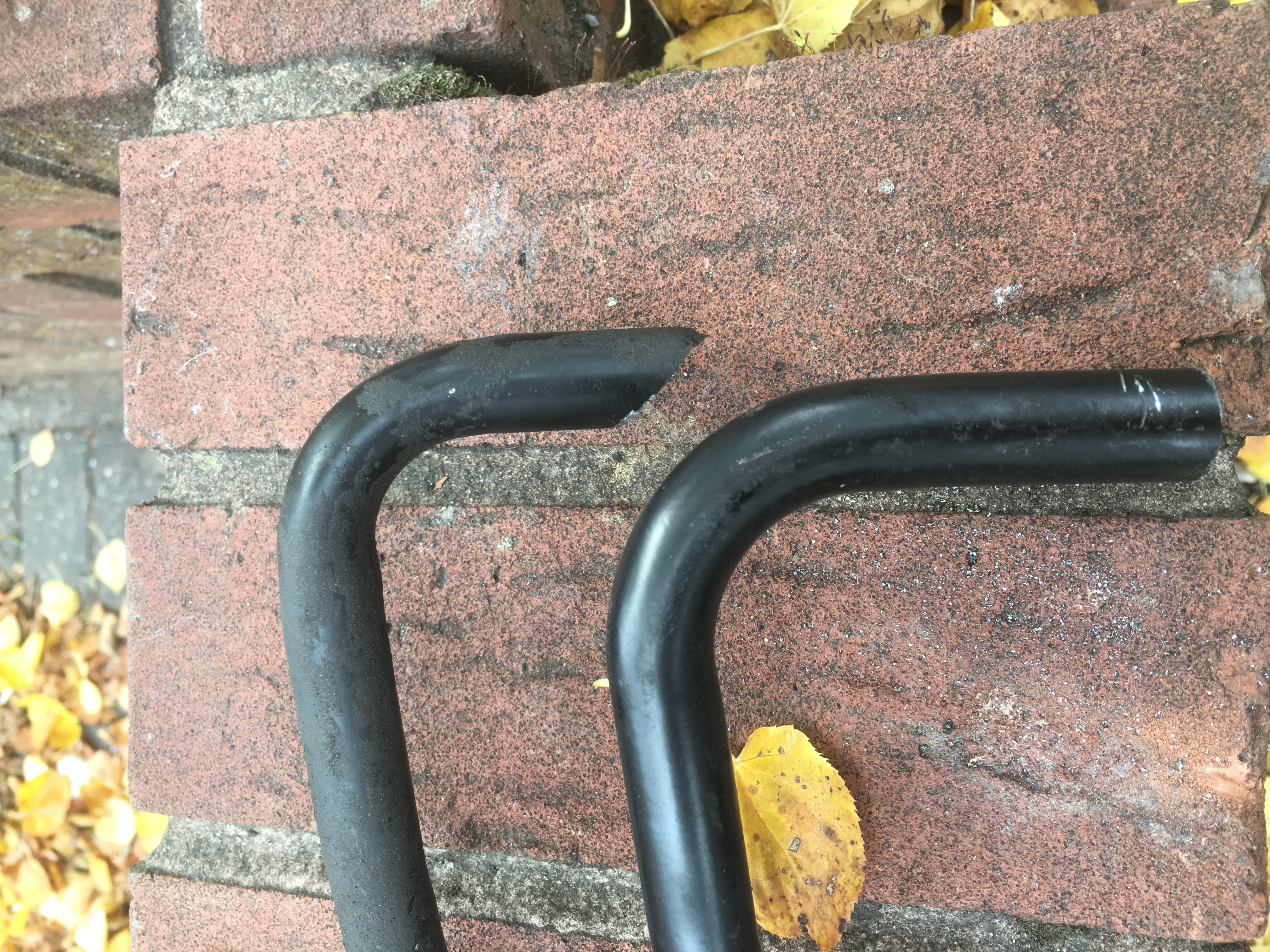

The picture with link pipe is the cut and join pipe the other small pipe I changed the other rubber pipe just in case of any wear under the hose only £13.00 from Audi
Right so that’s all done now refiled antifreeze and water run car up to all most temperature ran out of time as had to pack away tools so will run up to full temperature tomorrow and check for any leaks 👍

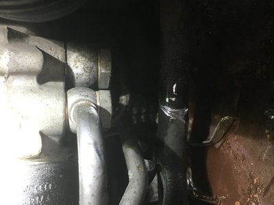

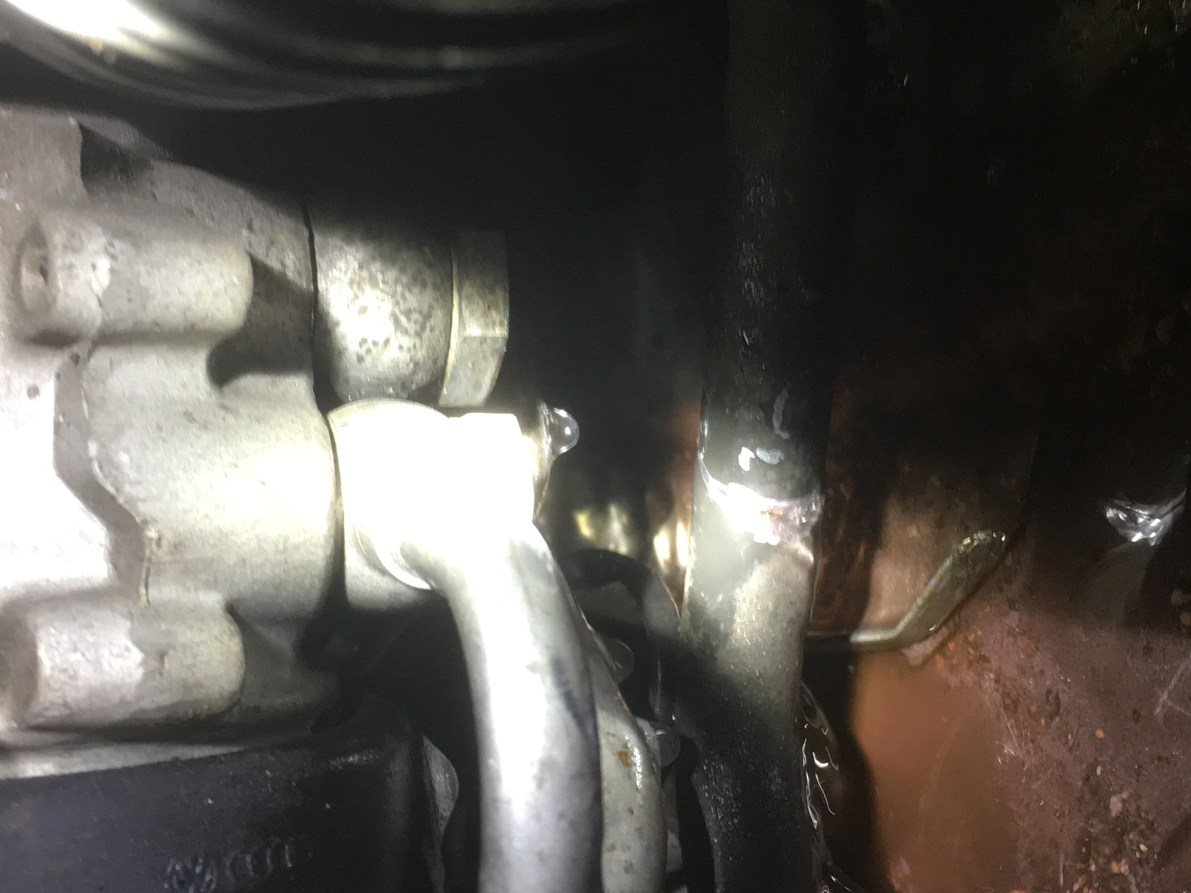

Update lost a bit of coolant so had look and looks like the cut joint pipe leaking it's clip just needs tightening as I was very concerned about over tightening them but I was very nice yesterday driving it 😃😃😃😃😃
