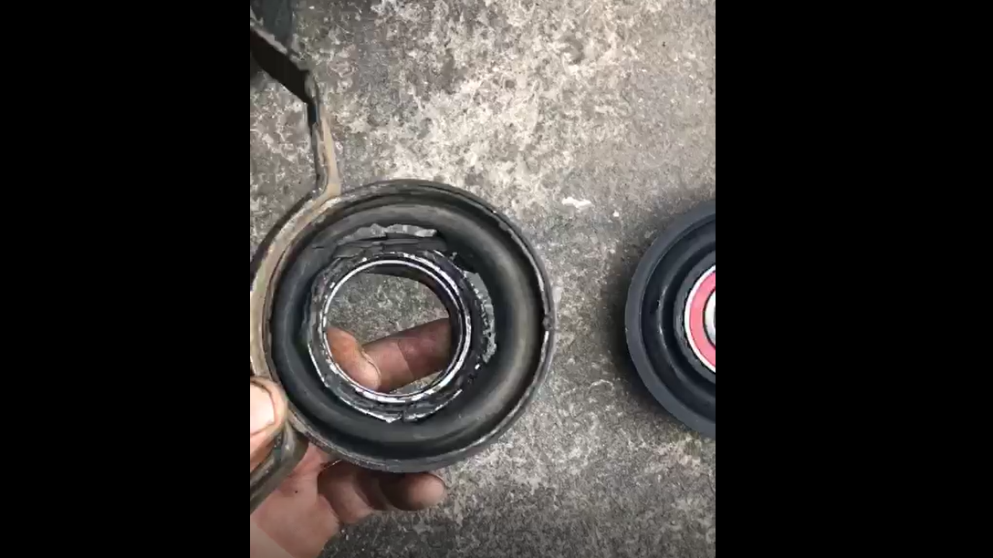

So finally got to the point where I need to replace the carrier bearing, took a punt on a £40 ebay part and annoyingly the centre part of the bearing has been put together the wrong way round, as a result it will not fit against the gearbox end of the propshaft correctly. Bit of a sh!tter when you've already go everything stripped down.
Anyway, long story cut short, theres a propshaft company in St Neots called Bailey Morris that seem to have these brand new on the shelf (http://baileymorris.co.uk), managed to get a complete new propshaft delivered next day for £650ish having spoken to Andy in parts & service. The price I got is trade due to an existing relationship through a mechanic colleague of mine but would have thought you could still save a few quid compared to TPS price of around £1200.
