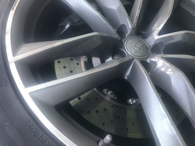

Post by tartan_rob » Thu Oct 04, 2018 8:01 am
Excuse the very unclean wheel.... :bowdown:
You can see the brake pad residue on the disc surface...

21” wheels...
