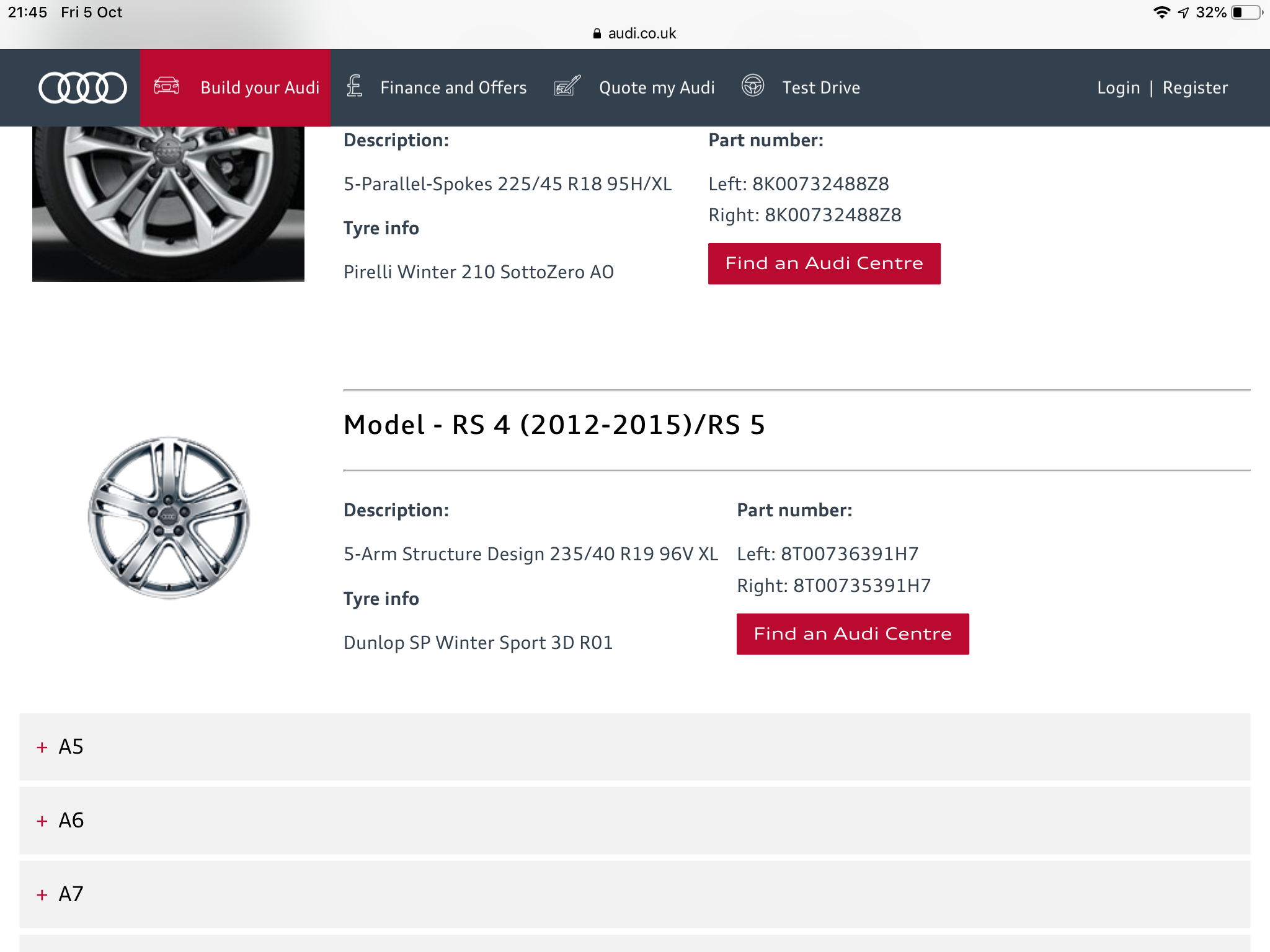

Standard tyres are Dunlop SP Winter Sport 235/40 R19
Wheels 8J 19 et 26
Part number 8t00736391h7
19 inch wheel, option with summer tyres are 265/35 on a 9j rim

Went to see the alloys and looks like they will not fit as they are 8.5J 19H2 ET43, so the wrong offsetImageImage

Grittle wrote:
Tue Oct 02, 2018 7:23 pm
Wheels 8J 19 et 26
I have a used set of these available.

John_vts wrote:
Wheels 8J 19 et 26
Hi.
They definitely fit B8 RS4? I've not seen these before at all. Reminiscent of old Q7 alloys maybe.
Madelvic
Posts: 304
Joined: Tue Feb 08, 2005 9:14 pm
Re: Winter Alloys Question
Post by Madelvic » Fri Oct 05, 2018 9:45 pm
Same as mine just different colour. Check the part nimber

Post by John_vts » Fri Oct 05, 2018 9:48 pm
These are standard Audi RS4 winter wheels and tyres.
I ran them on my B8 RS4 for the last two winters.
