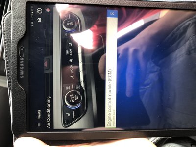

Post by Woodygo » Tue Aug 28, 2018 8:20 am
Morning all well epc light come on again yesterday I put on my hand scanner there’s no dtc store so I need Vagcom is the anyone local in Birmingham hallgreen shirley that can help me on here please thanks steve

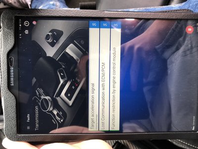

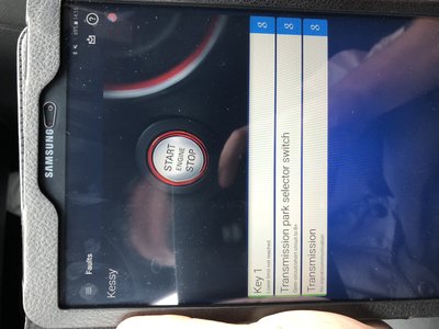

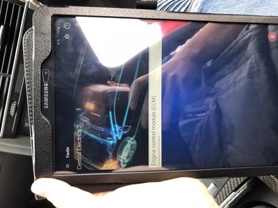

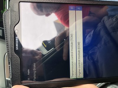

Post by Woodygo » Tue Aug 28, 2018 4:22 pm
Well been on there scanner this is what came up clean it all up went for drive come back rescanned it all clear but I bet it’s back in the morning if anyone can help in anyway please let me no thanks steve ( o and there is no dtc store )🙈

Post by Woodygo » Sat Sep 22, 2018 10:40 pm
Hi all just to let you no my epc light problem was down to my car battery on it’s way out and it must of not been coded to the car to new battery and coded to my car now and all good now
