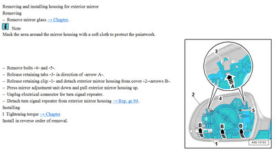

Post by Surrey Sam » Wed May 09, 2018 10:05 am
This is what ElsaWin has on it, if that's any use?
Click image to enlarge:
Elsawin Mirror housing

Post by PaulHH » Thu May 17, 2018 7:49 pm
I got the screws all out but cover was rock solid. Went to my local Audi paint Shop and they want £170 to spray the mirrors gloss black. Going to go with that, I returned the carbon covers which were £179 so now waiting for dealer to do job.

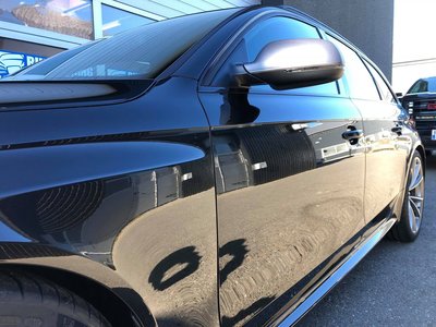

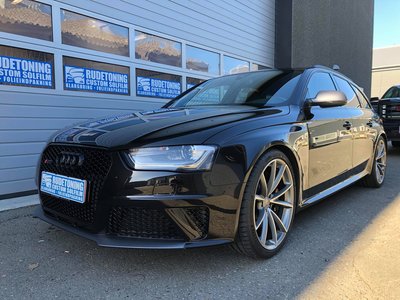

Post by JBNRS4 » Sat May 26, 2018 6:23 pm
What about vinyl instead of paint? I had mine wrapped to match the wheels...

Well - these guys in Copenhagen got it perfected, with few “seams” at the side-assist indicator towards the window. But I guess that doesnt help you that much.
With the right prep I would also assume they could be painted...
