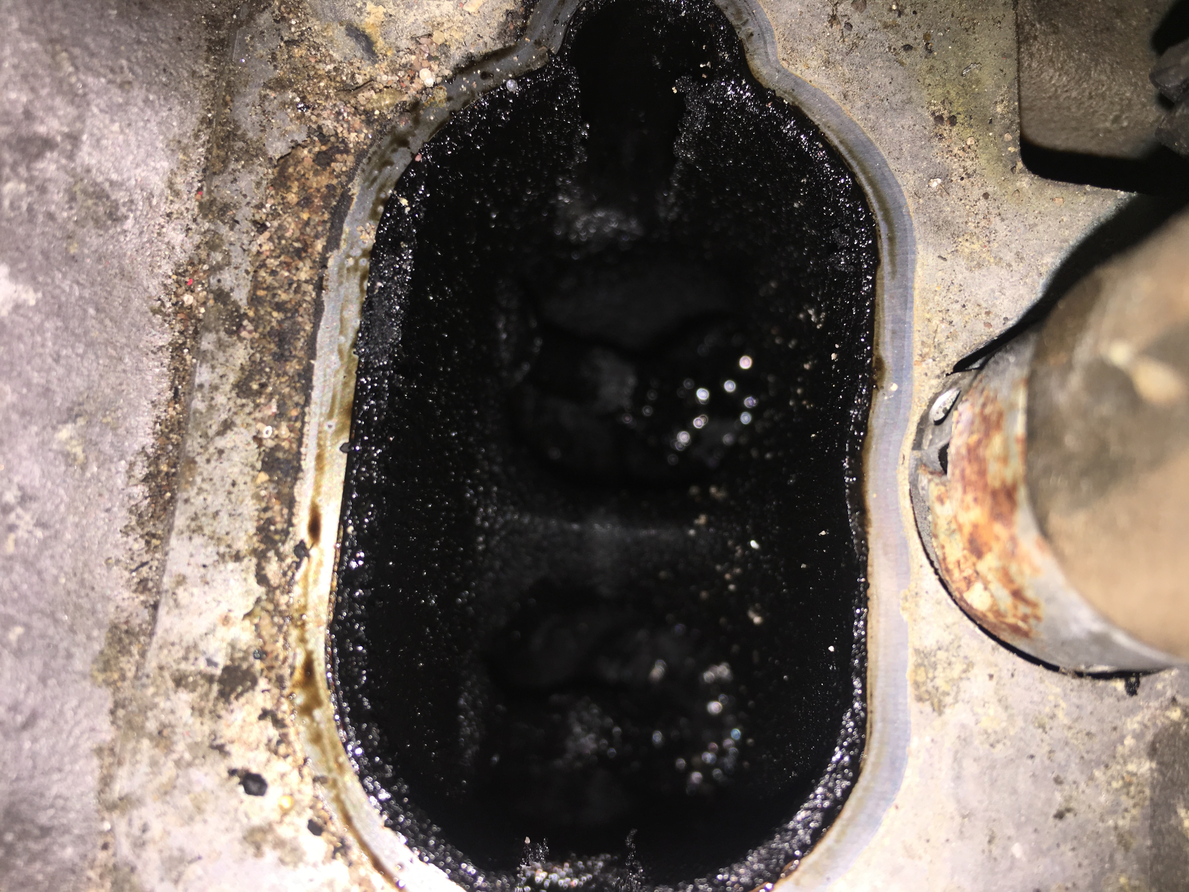

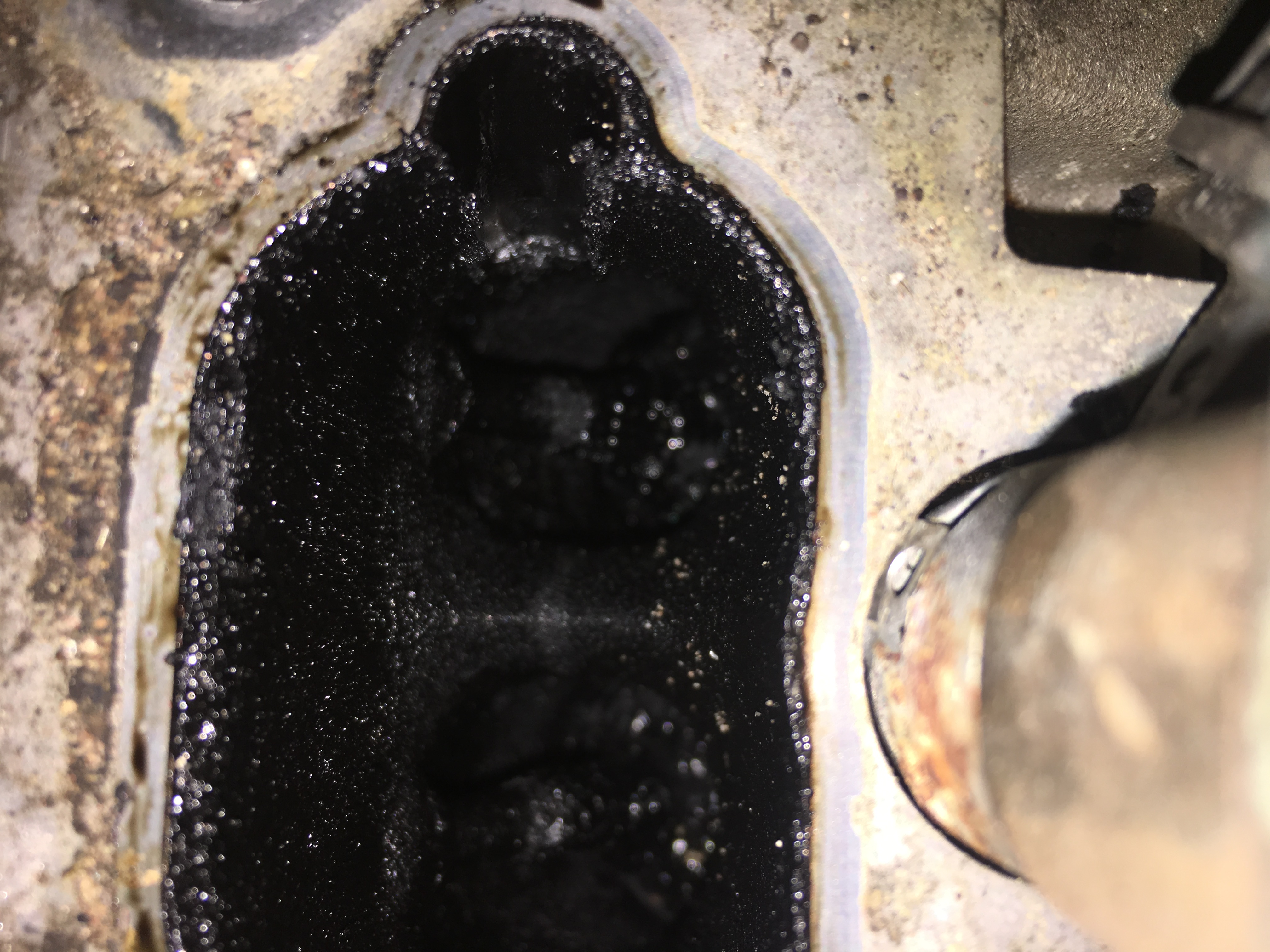

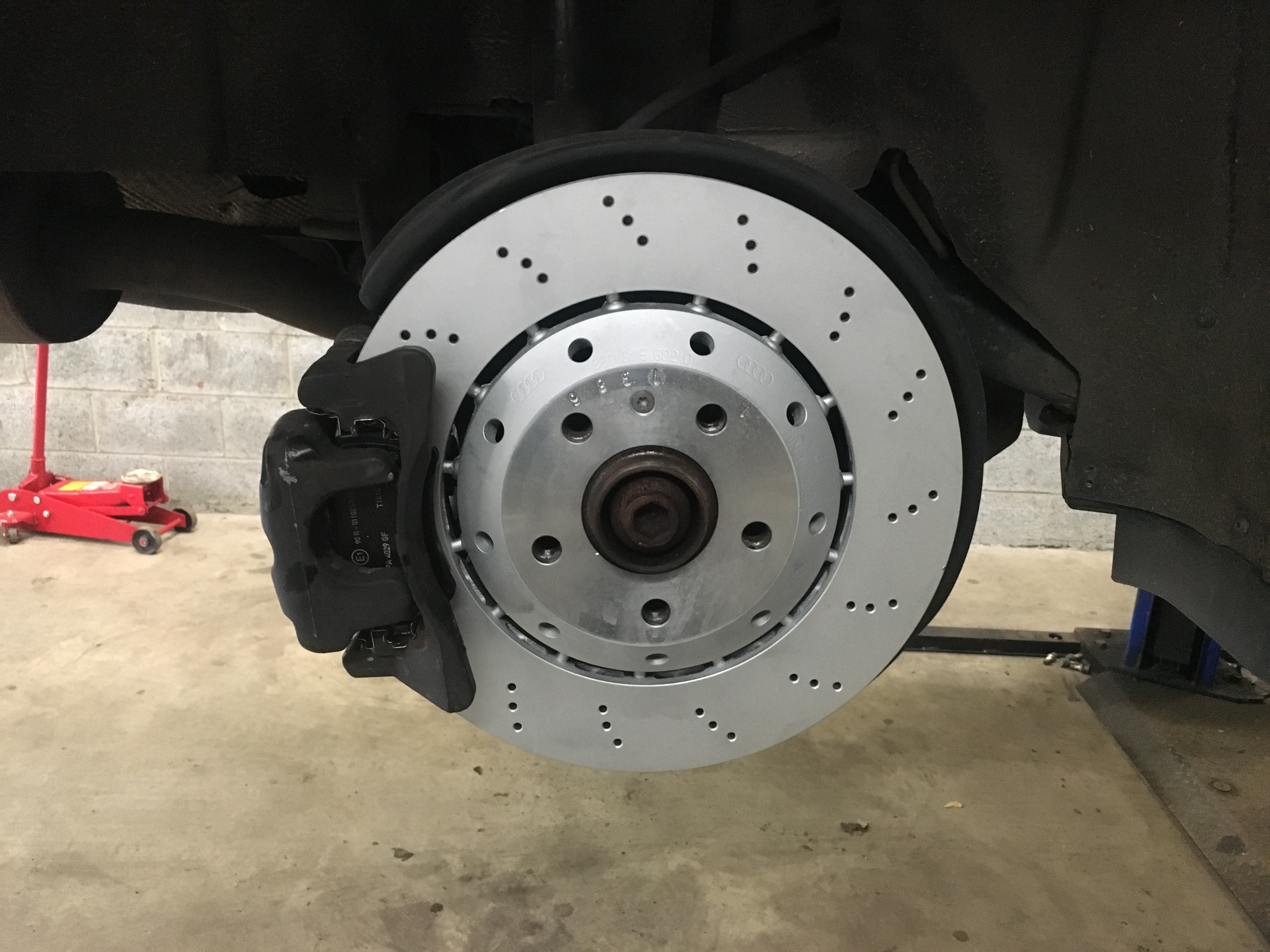

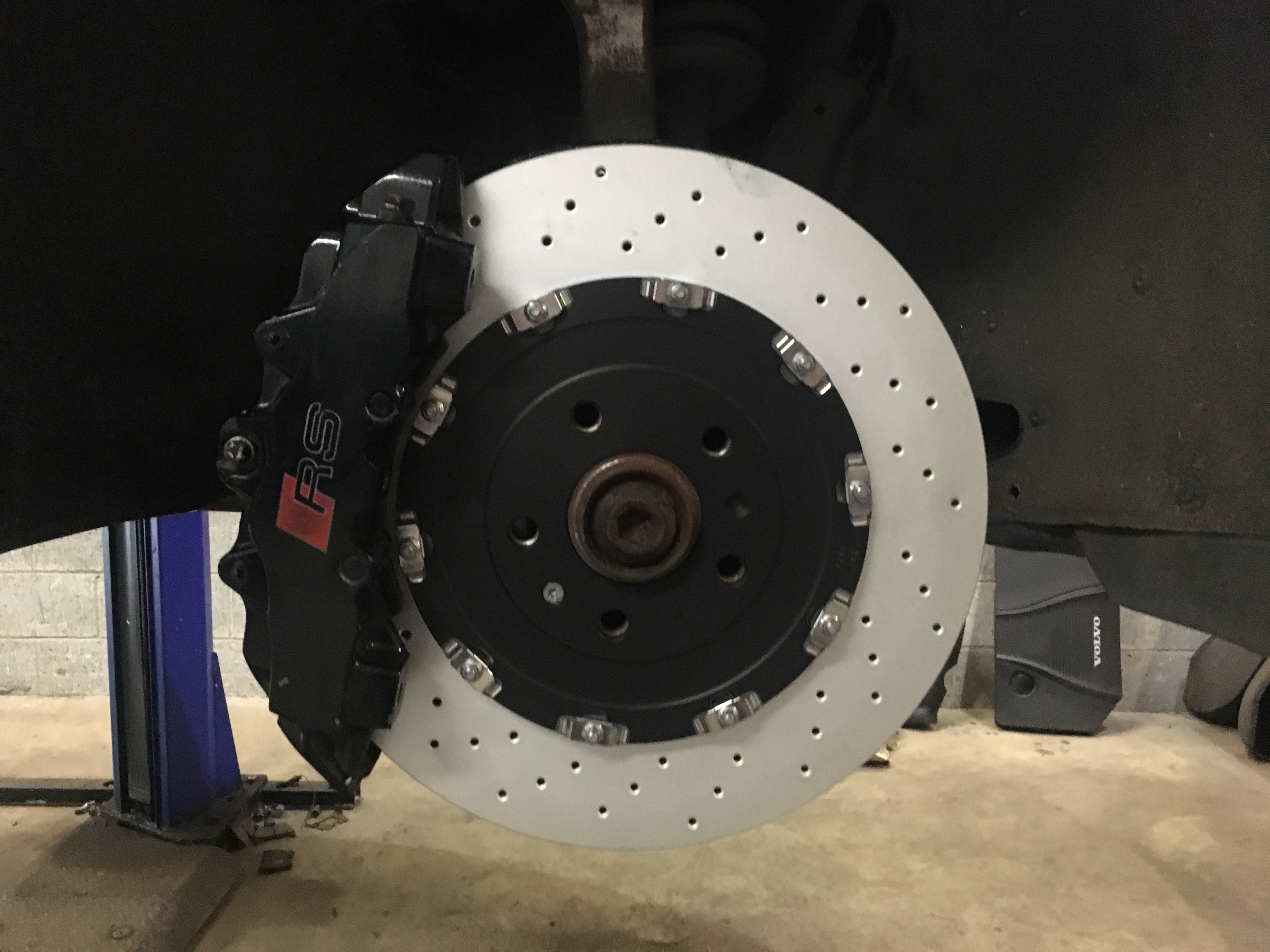

Took my motor to my local independent on Thursday for discs and pads all round (previously purchased from a couple of sources).
Also got it in for a carbon clean.
Here’s some photos of the front and rear brakes and the pre-carbon clean. Looks like it’s never had one to me.

Looked like mine, absolutely caked. Wait til they show you the after pictures. Then put your foot down and enjoy the kick up your arse at 5500rpm.

Don't get too excited. Mine idled smoother and was smoother in traffic. Other than that it pulled a little harder at the top of the rev range. Not a big difference though. A lot of people see a big difference because a vac leak is fixed as the engine is reassembled. Personally, I think it is a waste of time and money.

My car was at 70k miles, never had it done and was running 400ps with mods. After the clean it was 438ps.
Was it worth it? Nope.
Would I do it again? Nope.
I'd be happy running 400ps and not have to worry about cleaning it once a year. You know that it comes back very quickly? If you regularly thrash it, it will help prevent it but it doesn't take long to look like the photos above.

You don't have to listen to me, I'm just giving you my opinion from many years owning one and too many days spent wasted on this forum. I think too much emphasis has been put into the decoke and many people have confused the benefits of fixing a vac leak to the benefits of a decoke as they often get fixed buly removing and replacing the head. When the car was first released and people started to test them on dynos there was a panic that they were never capable of 420ps but they soon realised the engines do produce this power but only when they are coke free. Yes decoking will give you the big ps numbers for bragging rights down the pub so if that's what you are interested then go for it, but in real world driving difference an MRC stage 2 remap is a much better investment and is a permanent upgrade whereas a decoke is only temporary and the benefits are not as great as the remap. And personally I'd rather remap it when coked up intead of clean as I'd rather it was performing at it's peak in the condition it will spend most of its life rather than remap when clean for max ps but be performing non optimally for most of its life.

I don't think that they coke up as quickly as people seem to think, and again I think I've enough experience to offer that view. But for me it's not just headline figures or bragging rights, I think a coked engine feels less exuberant, for want of a better word, and that does matter (to me at least).
