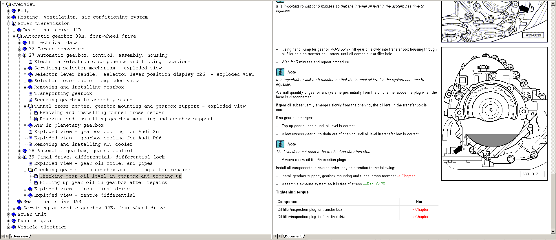

Did you manage to get both the transfer box and final drive drained and filled? Did you have to remove the tunnel crossmember and the gearbox support to be able to access the fill plug at the transfer box? I'm asking as I'm going to be changing the transfer box and final drive oils with Motul 300 LS next month. Elsa is showing that the fill plug is at the bottom of the transfer box and to get to it the crossmember and gearbox support have to be removed, whereas ETKA is showing it to be at the side of the housing. I know that the final drive fill plug is located next to the driveshaft so at least that's easy to get to.
