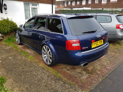

Not sure on the wheels. Someone on Facebook suggested they were off a later model RS4. They are 20". I like the way they look but they do rub so I am going to lift the car up slightly when I am next under there. Its on Bilstein C/O so should be easy enough. I did think about going aftermarket but I like the factory look so would rather get this one working properly.

Look like A8 wheels (although possibly a later model than the D2 if they’re 20’s?)
I wonder if they need spacers to fill the ‘6’s arches - and if so, you could get away with smaller spacers to resolve the rubbing?

D2 S8 Final Edition came with 9jx20. Very rare wheels. I think the D3 10 spoke 20s were 9.5j and an off-set that didn't work for the C5RS. Where are the tryes rubbing? What profile/width are the tyres?

They only rub on full lock (outside edge on the arch) so 10mm higher and it should cure it.
