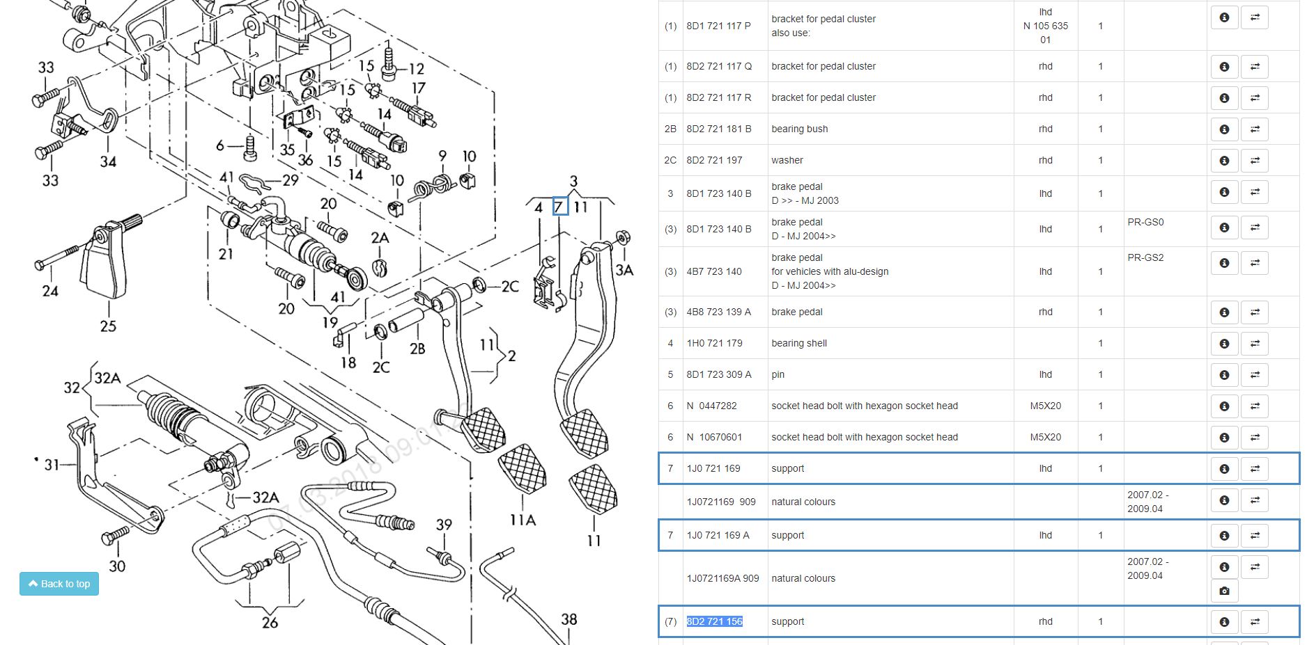

I wonder how difficult it is to dismantle the brake pedal all together. It might be easier for me to just remove it so I can easily access these parts and see what's happening. Thankfully the BLS is easy to replace, is this bloody clip that's bugging me - it's number 7:

Ok, so the image above was wrong, as I suspected.
Here is a link to the part in question - https://www.ebay.ie/itm/Audi-RS4-RS6-A4 ... Sw9qJagtzp
Below is the parts catalogue image, it is part 7 and not 4 as the image suggests. I suspect though, that the bearing shell is also missing, so I would require both parts.
Has anyone had to work on this part before? I have an idea as to how to go about getting it out but I am not sure how it actually secures itself into the brake pedal. So before I go replacing the parts, I need to figure out how they should seat first - maybe mine isn't broken but just not secured.
