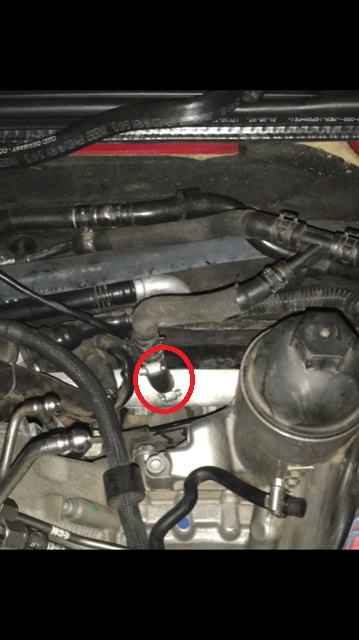

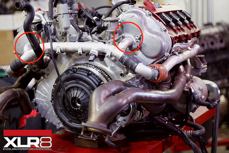

I would look at the below Pipe fittings first. It's a drastic move to remove the engine before knowing where the leak actually is. I had this pipe leaking on me due to clamp failure. Not a major leak but irritating as hell. A mate of mine had the same problem but his just dumped all the fluid, similiar to yours, and it turned out to be the same problem, in his case the clamp just failed completely.
See pic's below, tricky to get to it but definitely don't need the engine to be removed. If that's not your problem then perhaps it's something more serious that might require an engine pull but I would need some serious convincing that there is absolutely no other way.

Thanks for all the replies peeps it turns out it was a coolant pipe at the back of the engine between the firewall and engine which had failed the guy at the garge had said he had done a fair few RS4's with coolant issues and he had it all repaired within 2 hours at a cost of £140 including parts and labour a bargain considering the alternatives .
The original garage which had diagnosed the engine removal was shocked and a little embarrassed when i turned up a couple of days later with the car as he was convinced it was a engine out job . :thumbs:

FWIW I had a different kind of coolant leak that resulted in an engine pull. After living with slow coolant loss over many winters and after many dealer pressure tests that said everything was fine, I asked another dealer one more time to take a look. An older tech figured out it was the short coolant pipe (parts 079-121-071-CT and 079-121-071-DA and their seals) that runs through each rear cylinder covers that failed. They connect to the rear coolant manifold, behind the covers - not visible from outside. The small coolant would leak would be consumed by the engine or exhausted out and I would never see it on the engine nor would it drip to the floor. (I hope this is not the same pipe and that my engine didn't need to be pulled!)
