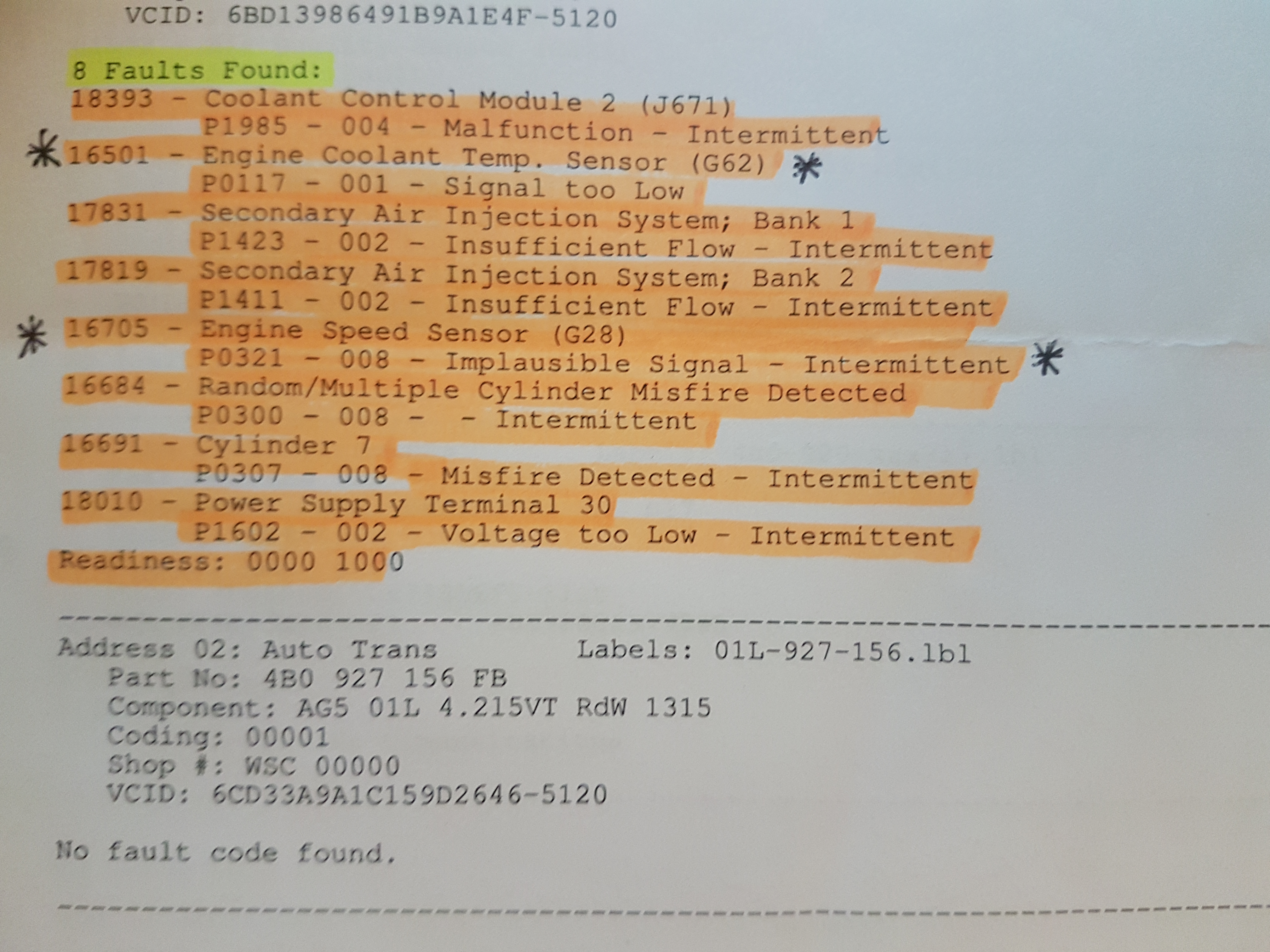

Also now the engine management light has come on after a poor start yesterday. It's not the EPC light, but the little starter motor looking thing.... After some research it's linked to running poorly ? Bad fuel ? Emisions etc.... Which would make sense if it runs like crap for a while on most start ups ?
Here are a few pics of the paperwork.... And faults...

Could be the temp sender again. They fail often. If it was replaced with an ebay special it wouldn't surprise me at all that it failed again quickly.

It'll be throwing a code because the MIL is on. Probably just misfires though. Still, without checking who knows?
An OBD2 reader that can do live readings might help. If it's just a code reader then it'll be of limited usefulness.

This sounds like pretty much the exact issue I had a while back. Turned out to be a coolant sensor. Replaced it with a oem part and it cured the problem. It’s only £40 from TPS as well. The previous sensor fitted was a cheap one, it was corroded in as well and was a pain to take out. Like shopp said, avoid the eBay specials.

There may be more than one temp sensor. Also engine speed sensor is crank sensor and can cause similar starting issues particularly on warm engine.
