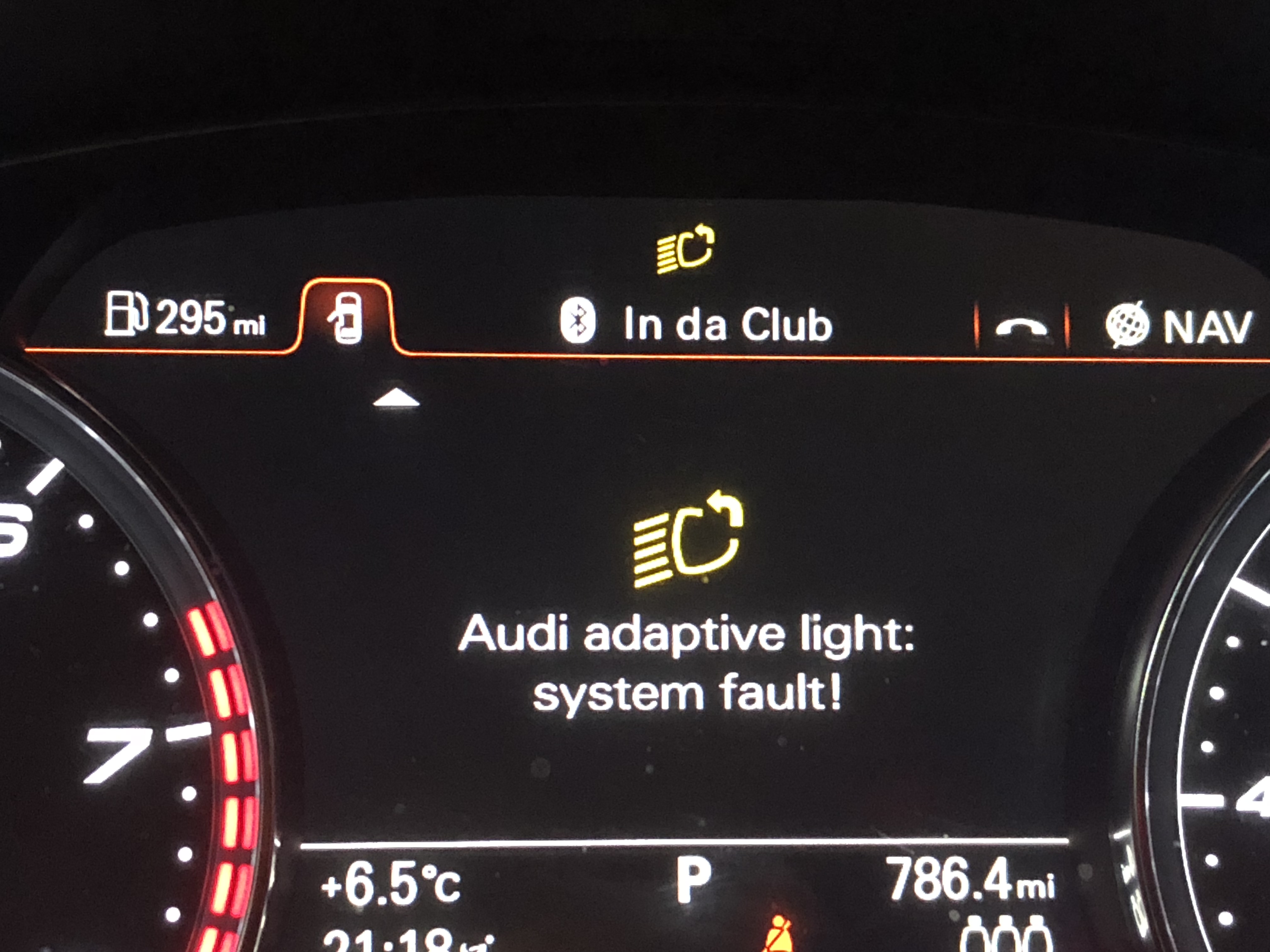

Hazards used to be used on daytime lights so it’s more than just the calibration I believe will go take a pic of error I get on dash now
boss1.89
Posts: 22
Joined: Fri Jan 05, 2018 12:22 am
Re: adaptive headlight fault?
Post by boss1.89 » Wed Jan 24, 2018 10:20 pm
Error on dash

Windscreen calibration should be free - when I had screen changed by Autoglass, calibration was included.
