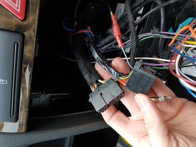

Re: Aftermarket head unit to replace RNS-D
I think yours sounds very different to mine. The block that plugs into the back of my stereo has all the regular speaker wires.
I do have a couple of RCA outs, but they are to directly feed an amp. I see no signs of any RCA leads behind my dash at all.
This block on the left is the main one from the Audi head unit which I assume contains all the speaker wires, but the adapter kit I bought, which was linked in this thread also has nothing that appears to attach to it with enough cables to feed any of the speakers.
download/file.php?id=45118&t=1
I'm pretty sure it's not standard and has been messed around with. I'm going to have another look tomorrow as long as the weather is nice, but then I think I will have to get someone who knows what they are doing to finish it off
That's correct. If my memory's right, you need this connector, which plug into the pair of black connectors you've got. One runs the amp (the blue wire you can see in the pic runs the amp alongside the RCA plugs), and the other runs the main unit.
http://www.connects2.co.uk/Product/ProductItem/CT20AU11
There's no RCS lead I can see in that. The pioneer only outputs to the amp via RCA.
Does anyone know off hand which wire is the power for the AMP ? I'm thinking now that the AMP is not powering as it should....
See Page 12, Blue/White wire - http://catalogs.pioneer-car.eu/Manuals/ ... l/?page=12
And I'm sure you need to the lead I linked to above - no RCA connectors = no power amp inputs.
There should be a white wire coming out of the RNS-D harness to tell the amp to power up.
Thanks guys !
All working now. Was the amp not powering after all !
