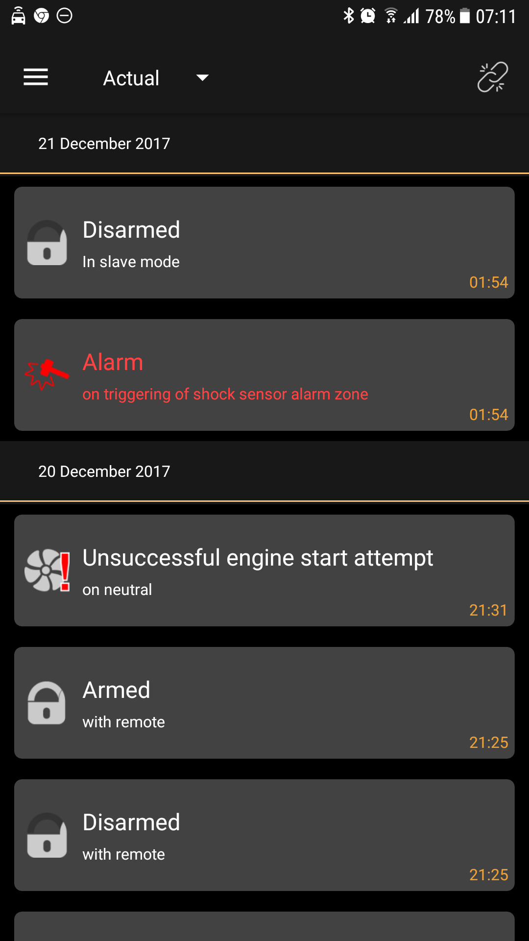

That is what mine is at the Moment from last night.. showed up as a rear quarter bang. 3 times so far. Had to leave the car unlocked last night as i am unsure if it can all be disarmed and and only locked

Post by Neilb76 » Thu Dec 21, 2017 10:08 am
Tbis was my false alarm.. sure ot will be sorted

Mine has been great since the false alarms. Adjusted the shock sensors to 50 and the other to 30 and it has been fine. Also using the standard remote now. Put the pandora one away.
So hopfully all is well. Still made the right choice and the customer sopport from anthony is brilliant.

Use your standard key pal mine.is fine now.reduce your shock sensors to 50 and 30 amd try that of they are the shock sensor

Mine only works within bluetooth distance. Inwent for the silvet oackage so mine will be different. I have spoken to ant today and been given his personal number. With false alarms i am having. Disabled the shock sensors today and he is returning new year to relocate the sensor. Said some cars. Have things still active ie vents closing which could trigger the sensor at different times. Who knows lets see what happens
