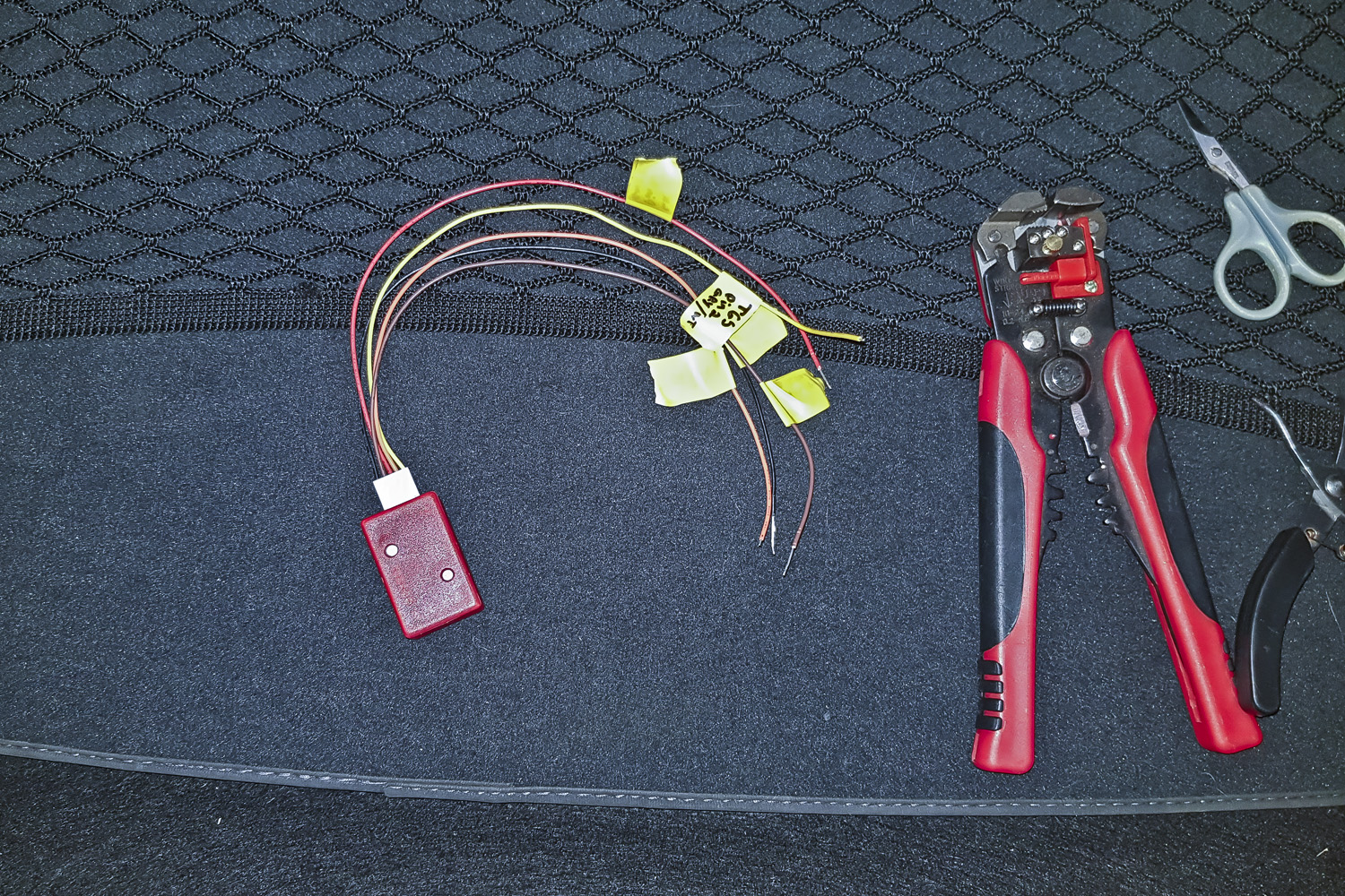

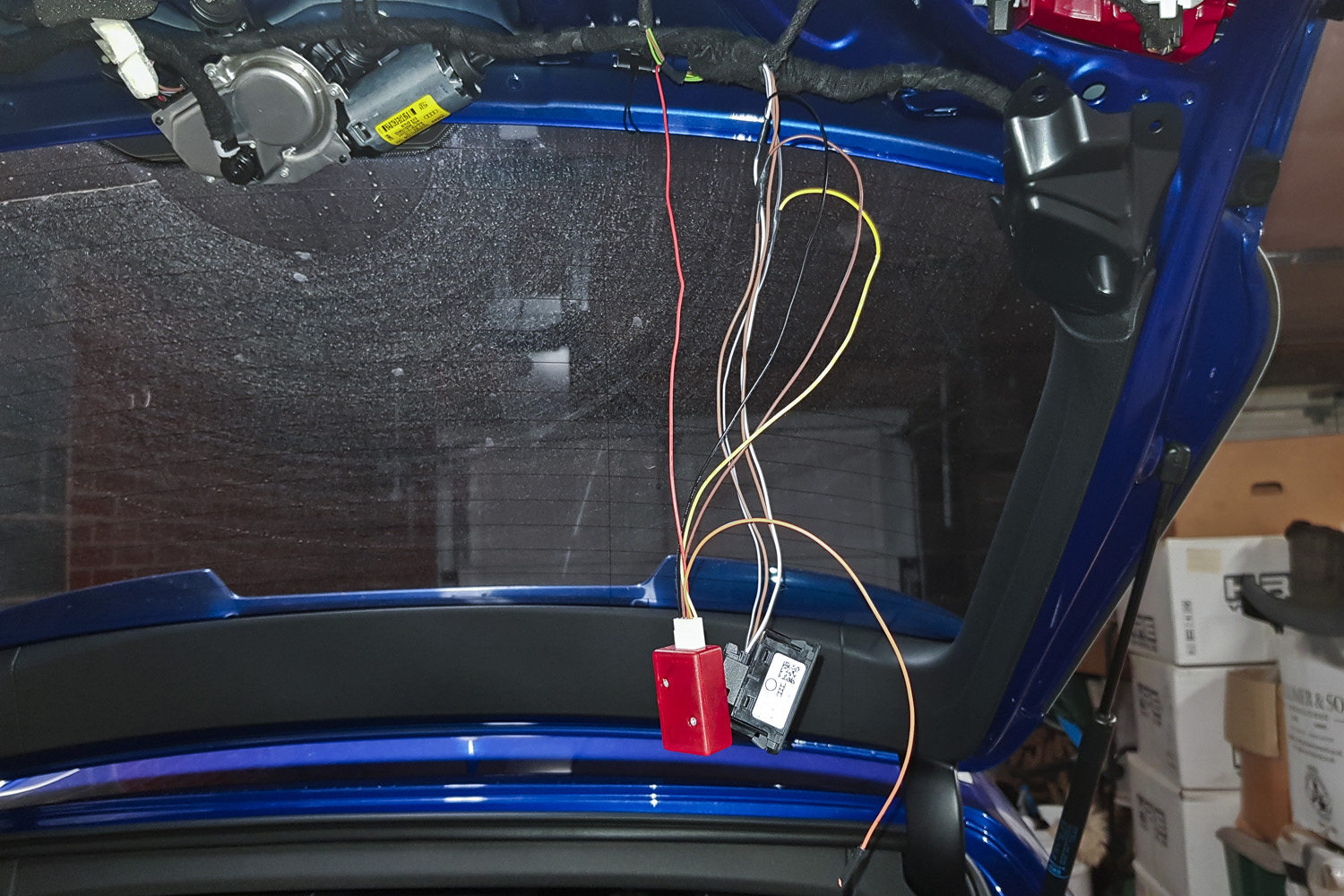

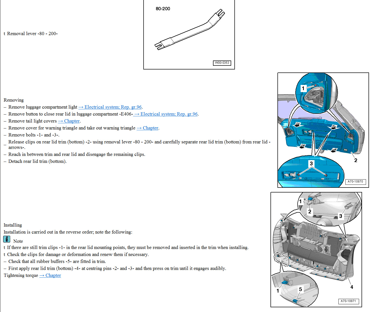

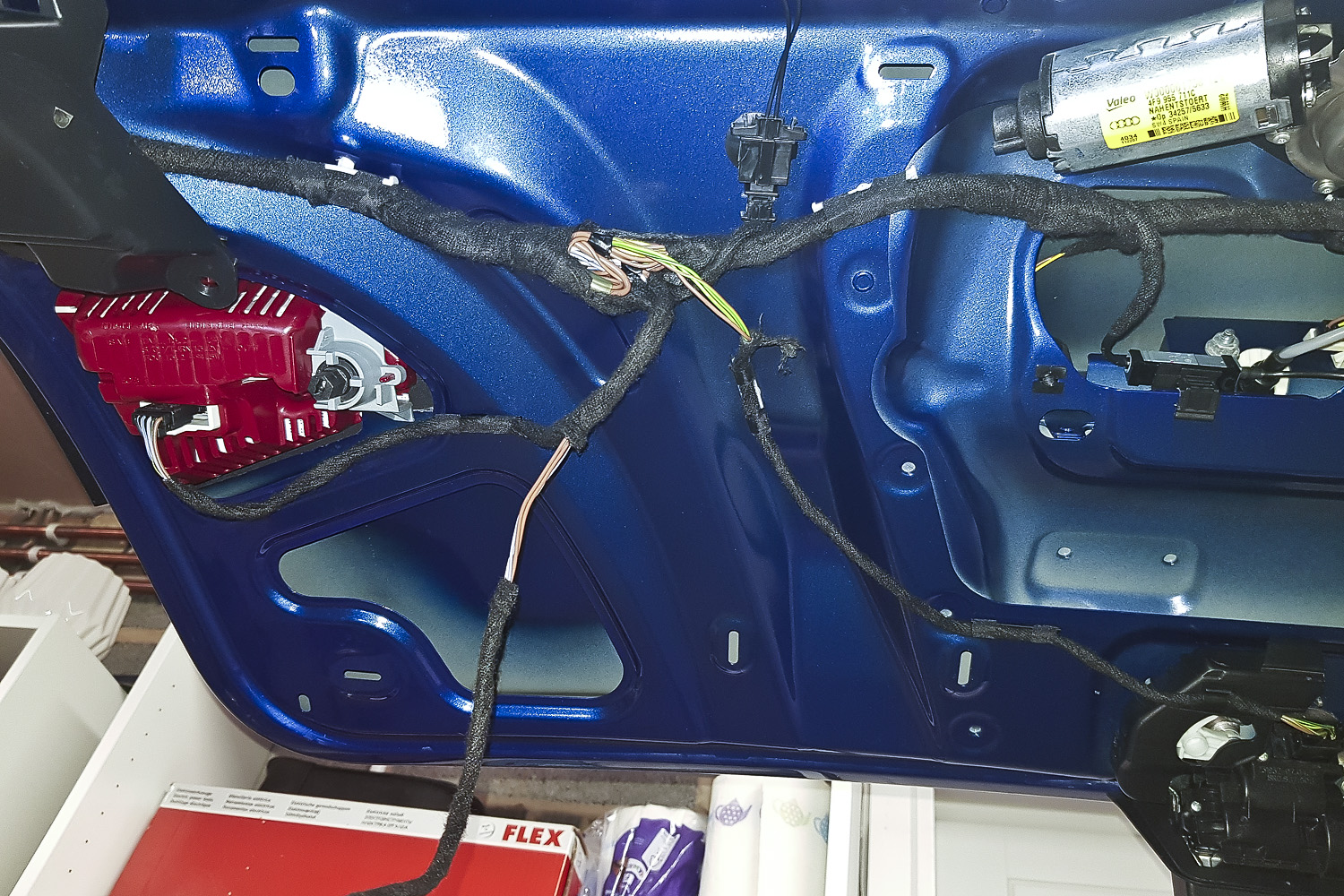

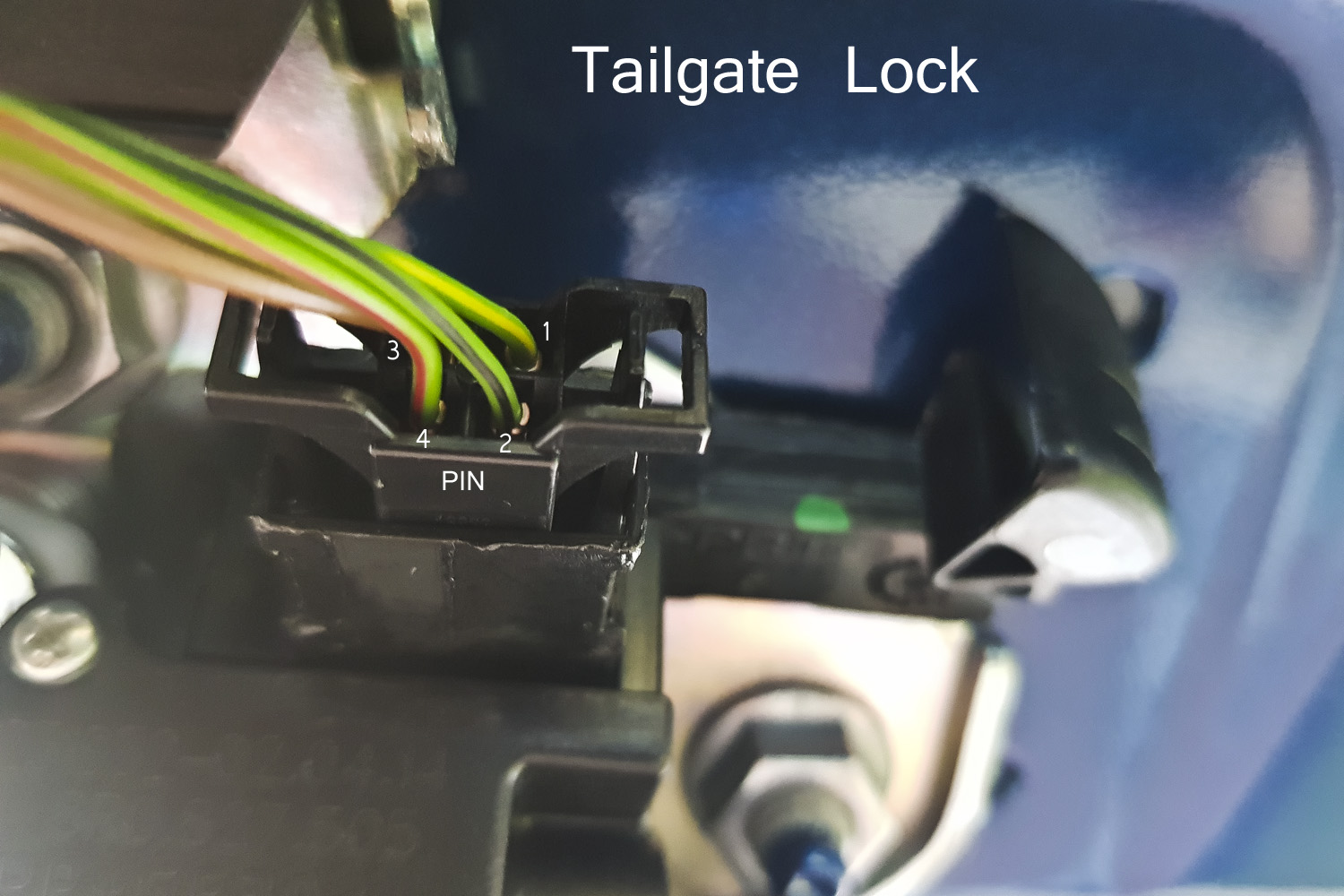

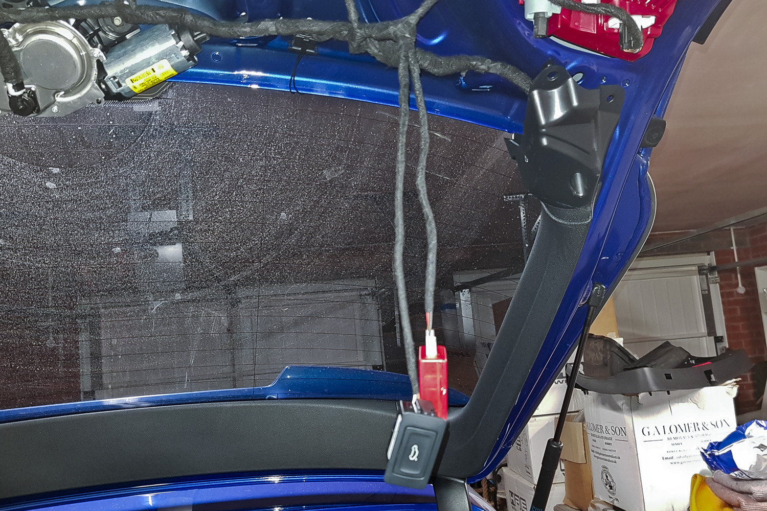

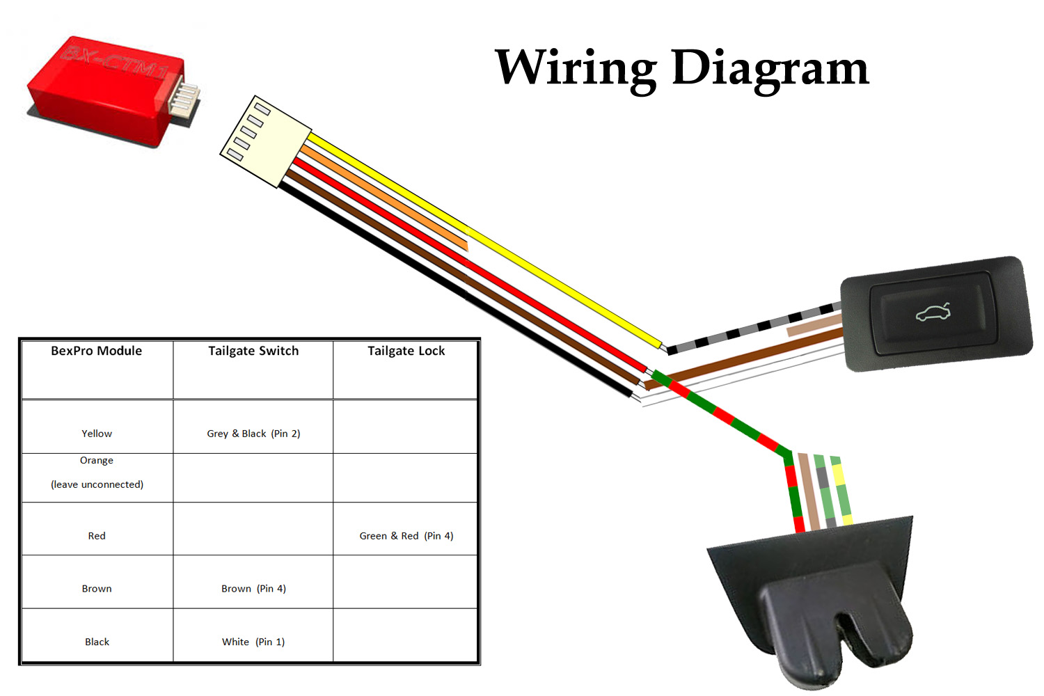

Right, got the images off my phone and created some guidelines to help anyone intrested in this.
Click on the images for full resolution:
ElsaWin instructions to remove the tailgate trim panel.
Wiring Diagram
Tailgate Switch Pinout
Tailgate Lock Pinout
Label BexPro Harness
Unravel wiring harness to expose necessary wires to splice and solder into
Solder connections - Cover your boot floor with an old rug to protect from any solder spilage otherwise it could burn through your carpet.
Connect the Black and Brown first which should power module, then connect Red to the tailgate lock wire as per diagram. Turn the ignition on and press the tailgate unlock button. The module should blink quickly as it takes the signal. Now turn the ignition off and connect up remaining wires, except the orange which should be isolated. Use good quality electrical tape to wrap solder joints.
Re-wrap wiring harness using fabric tape - Tesa manufacture some.

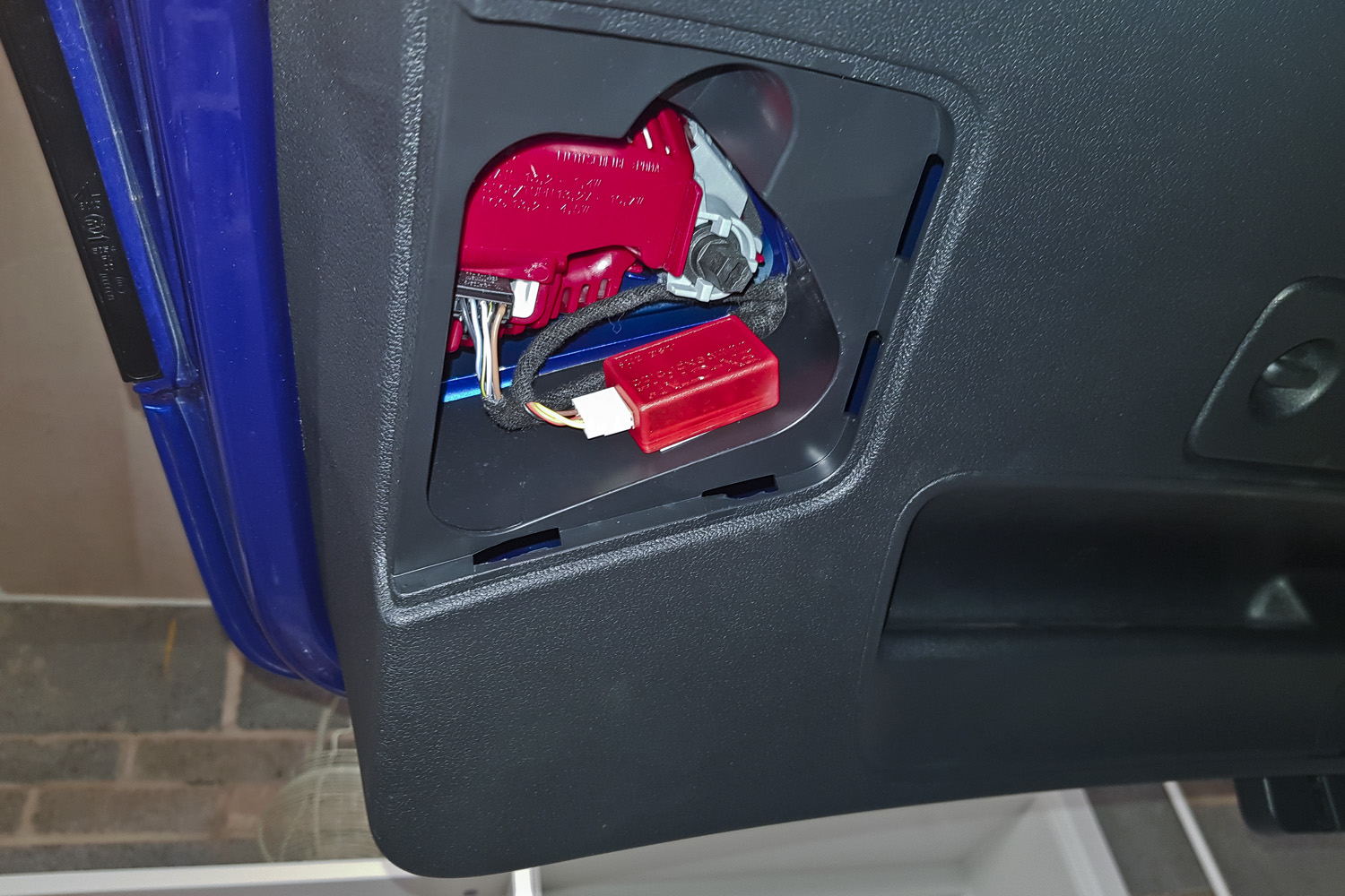

Re-assemble trim panel and locate BexPro module - I stuck it inside the offside rear light access hole, using a cut down double sided padded number plate Sticker.
Job done
