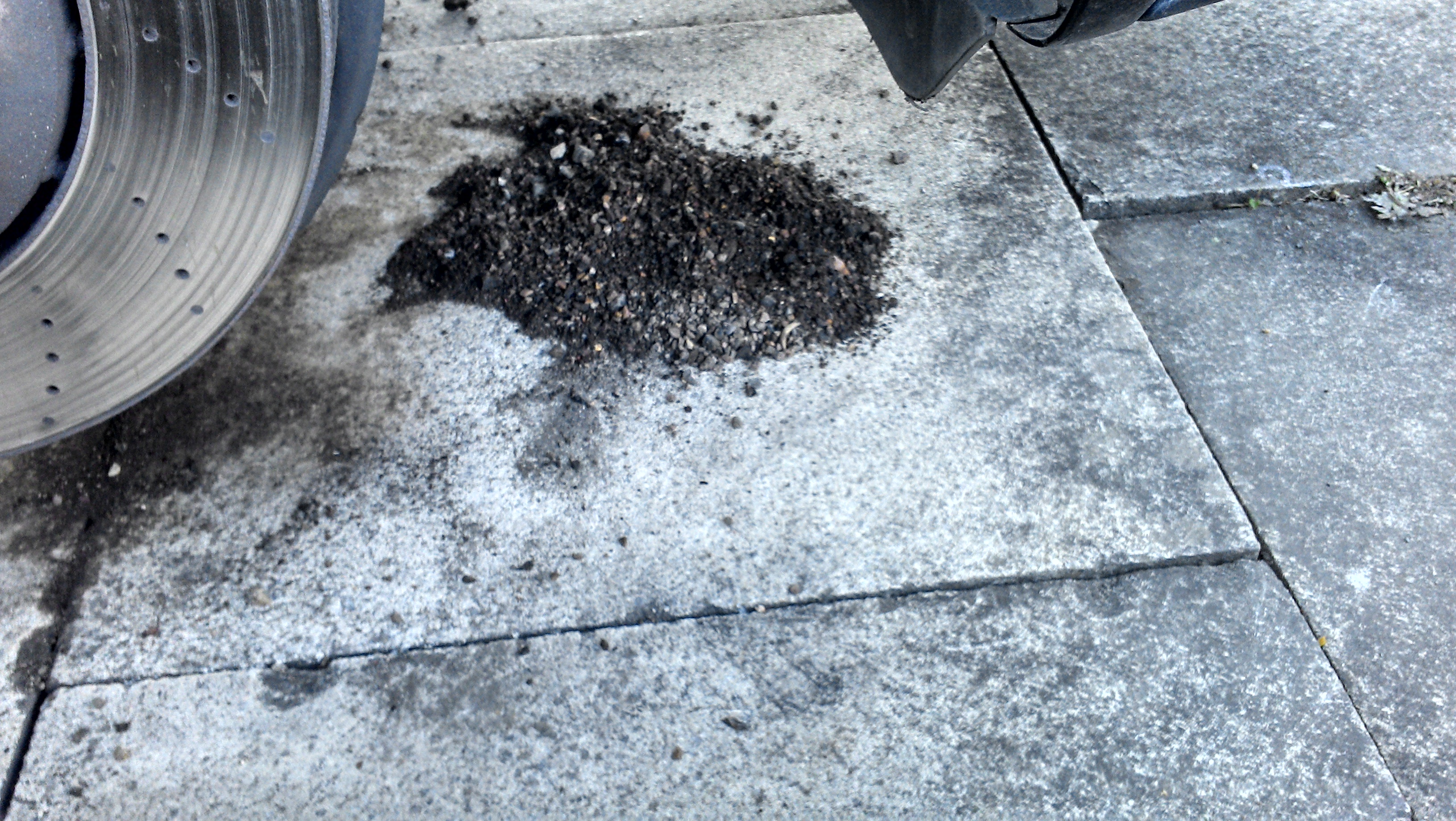

The amount of road grit I've found where the pipes run is amazing - it's going to need a bloody good clean out in there.

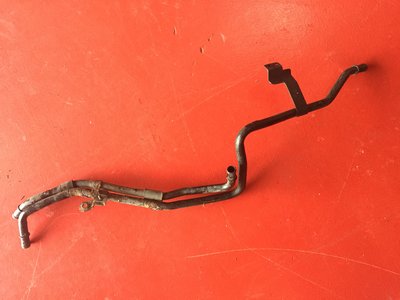

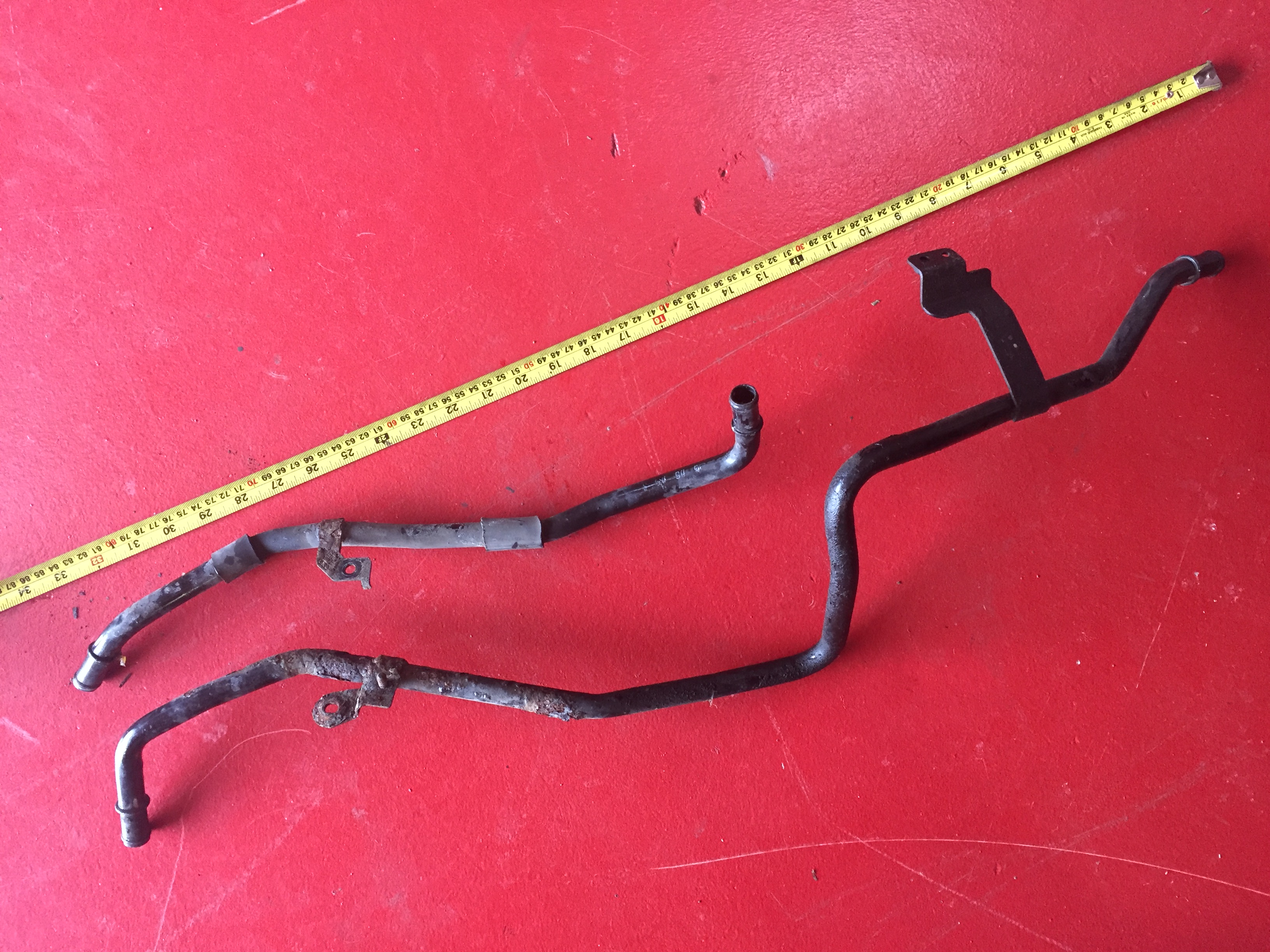

Inner wing yes but I'm guessing you already have that removed . If you mean the metal wing then no.
If you need some pictures of the two pipes out on the bench let me know.

BTW - the short pipe was unholed but the bracket had corroded and cracked, whilst the long pipe appeared to be solid but gave up in three places when I removed the expansion tank pipe so I reckon it wouldn't have had long left in regular service. That's 9 years and 90K+ miles - the new pipes have been stripped and powder coated with the same stuff that that the MoD specced for Wolf Land Rovers so I hope I won't be doing this job again.
