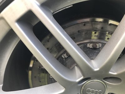

Just picked up a nice B7 with 43k on the clock.
Car has just had an MOT with no advisories.
However, when going through the history and looking at Audis comments from the service last year they mention discs being scored and corroded and needing replacing.
Now I know they sometimes just want to make money but now I've actually looked at the discs they do look a bit rough.
They have no lip though.
I've attached some pics. One is front and one is rear.
Can one of you guys give your opinion on if you think they need to be changed?
Many thanks.

Brake pads look like they've worn uneven and not creating full pressure on the disc.

To me it looks like the car may have been sat outdoors unused for quite a while and rust had built up. I would measure the disc thickness and as long as there's plenty of meat left I'd get them skimmed and fit a new set of pads.

I think it has been sat.
Only 300 miles between last two MOTs.

There you go. There's the problem.

I'd be looking at the callipers cause they aren't working properly. You might just get away with having the discs skimmed afterwards, but i'd possibly just replace the pads anyway.

I'll probably replace the discs and pads.
If I can get them skimmed I will but would rather change them.
Just hope there isn't a problem with the calipers.
