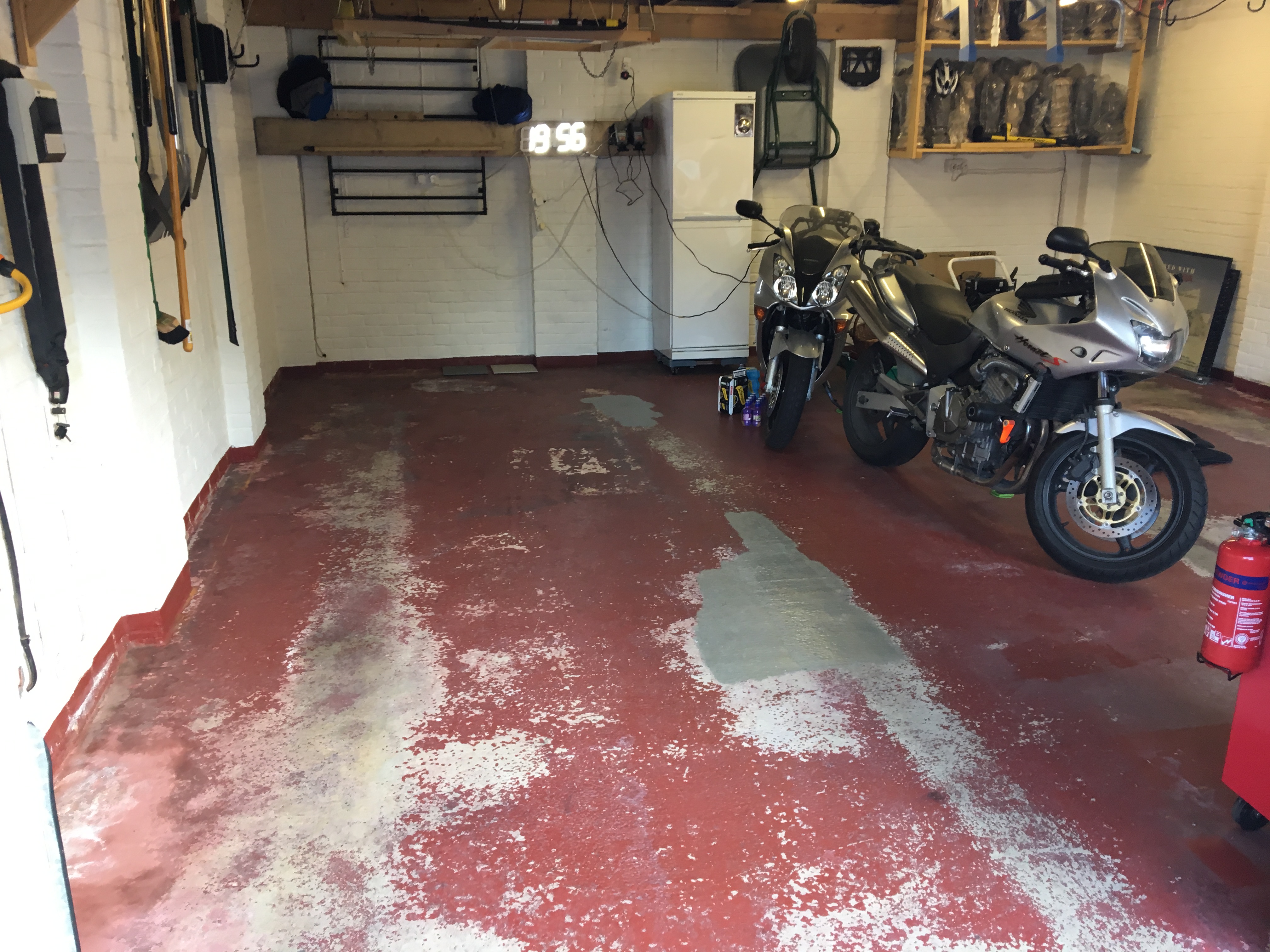

My garage is 14 years old, and painted at the start with specific paint but a few years in the paint started lifting and any other paint i've tried hasn't lasted.
I likeed the idea of ceramic tiles, but haven't found a local tiler that has any experience in doing a garage (saying it's be the same as any other floor didn't give me great confidence but what i know)
plastic tiles make sense, but trapping dirt and dust might hide the problem, but easy to do myself
have thought about some type of vinyl or carpet tile approach, but can't see that putting up with the abuse etc.
Am thinking of epoxy, end result looks amazing but cost is a little scary, however if it last and works, maybe...
So what's everyone else done, or going to do?
(pic of current floor attached)

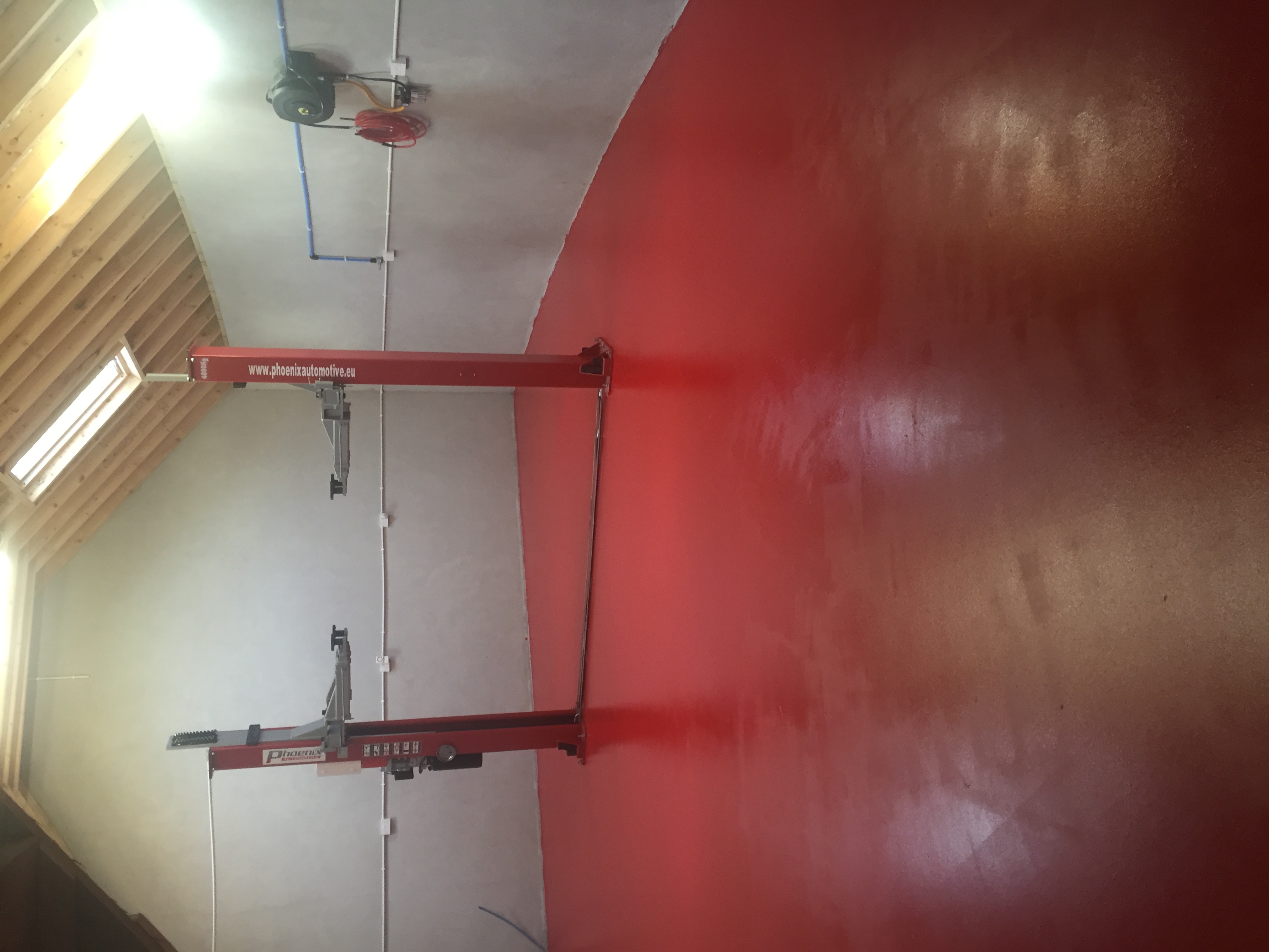

photo.... i like blue

the normal approach seems to be 'shades of grey' so i'm going to try something different to be... different.
so thinking bright red at the mo, we have a white audi cab and the black C6, so should work. blue was a very strong contender, like the way you'll have a blue car on a blue floor, does it work well?
