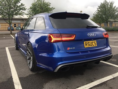

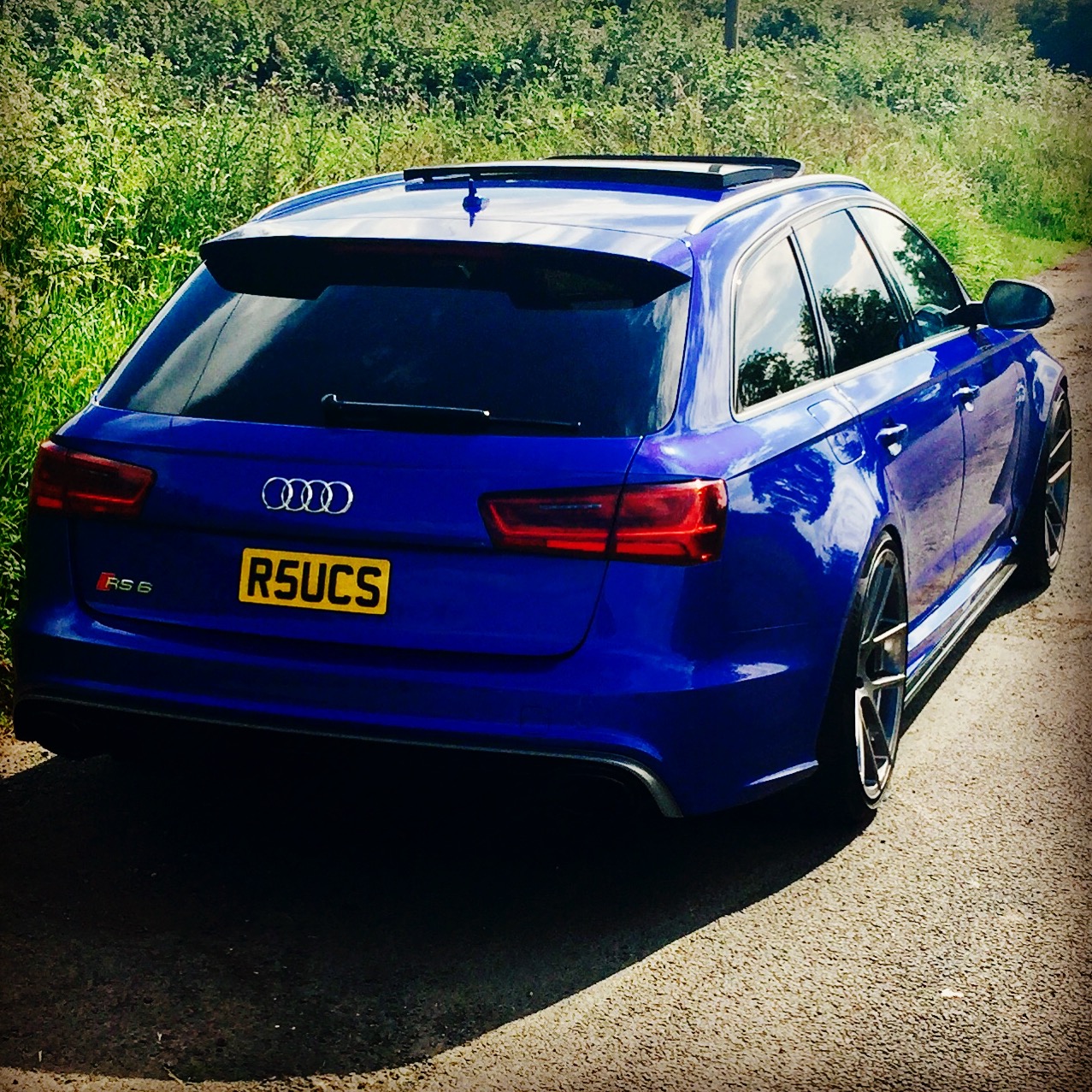

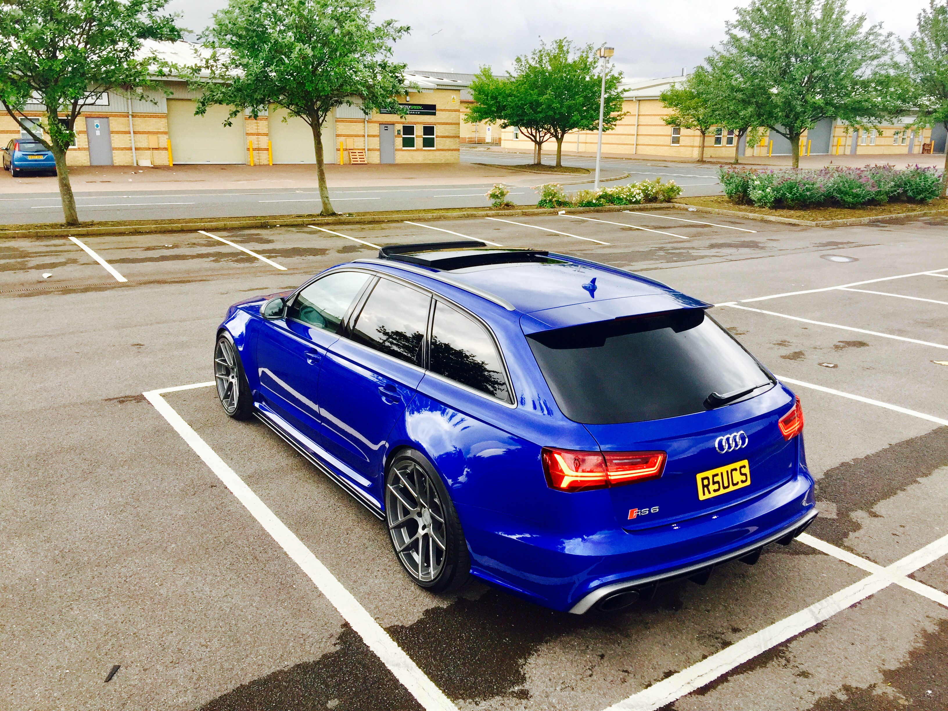

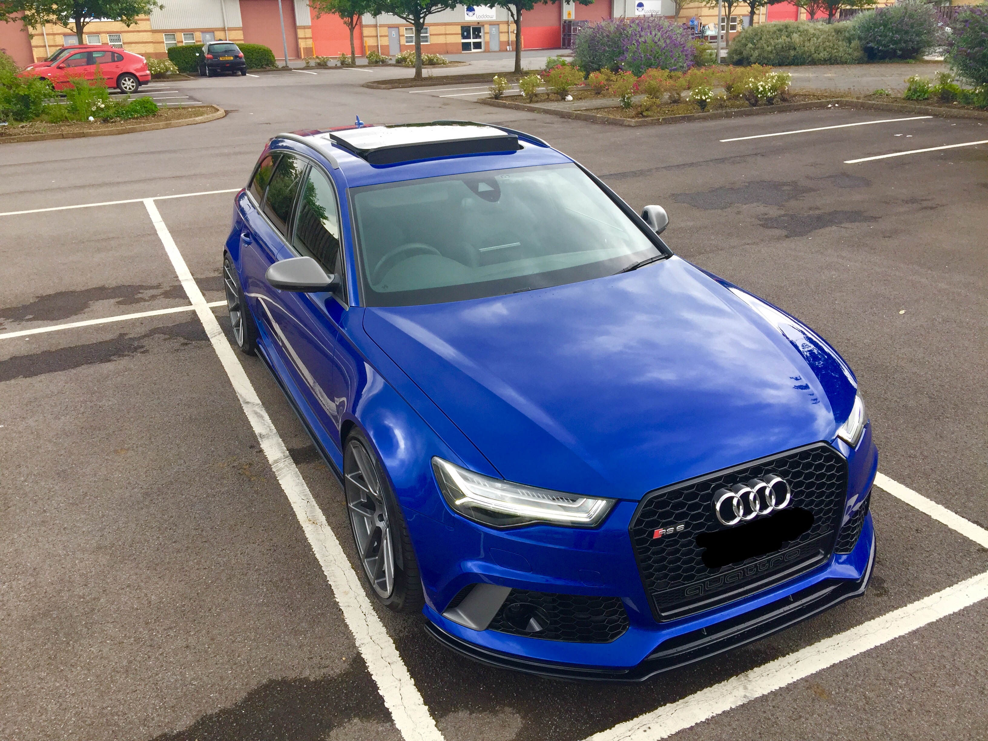

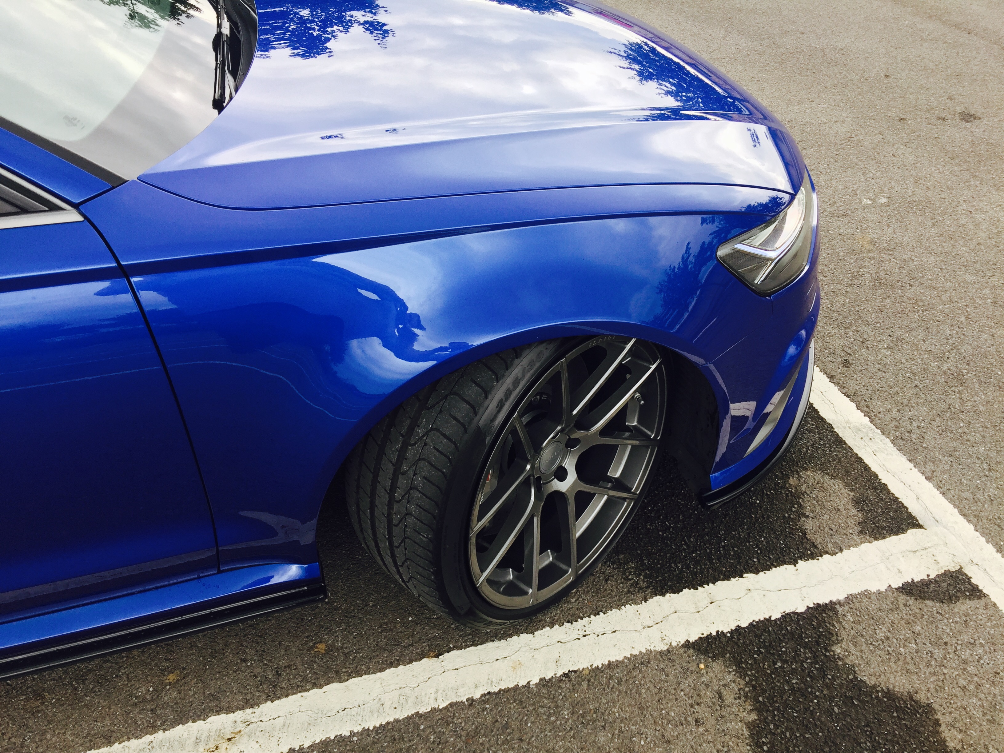

Re: Custom wheel specs
Ispiri ISR6
21 x 10.5 offset 30
20mm rear Spacers
15mm front Spacers
No rubbing or issues at all
Pirelli p zero (although I feel a little stretched that's why I recommend Dunlop or Michelin)
21 x 10.5 offset 30
20mm rear Spacers
15mm front Spacers
Nice Chris!
So zero turn in issues etc with that width on the front?
I am hoping by running a lower offset somewhere between +17et to +22et I can achieve more concave/angle on the wheel, however not compromise with caliper clearances.
But yes I am confused as to why HRE are claiming huge issues with 10.5 fitment on the front? They wont warrant it.
Here is what they've said:
"10.5 front won’t fit according to my data.
94467 and 90206 ran 10.5 fronts but I don’t know what they did to make it work.
Expride (Japanese distributor) ran some 11” front/rear setups as well –needed modification on the vehicle
There is probably more room made available after lowering that the measurements we have did not account for"
Deffo no turn in issues
I'm in a what's app group where most of the boys are runnng 10.5 width wheels....no one has issues....most run Spacers too
However...most haven't ceramic calipers....I have and again no issues...remember rear calipers are same size whether Steels or ceramics...
Of course I can't commmet on other widths etc...but 21"x 10.5" seems to be the sweet spot for non OEM wheels
