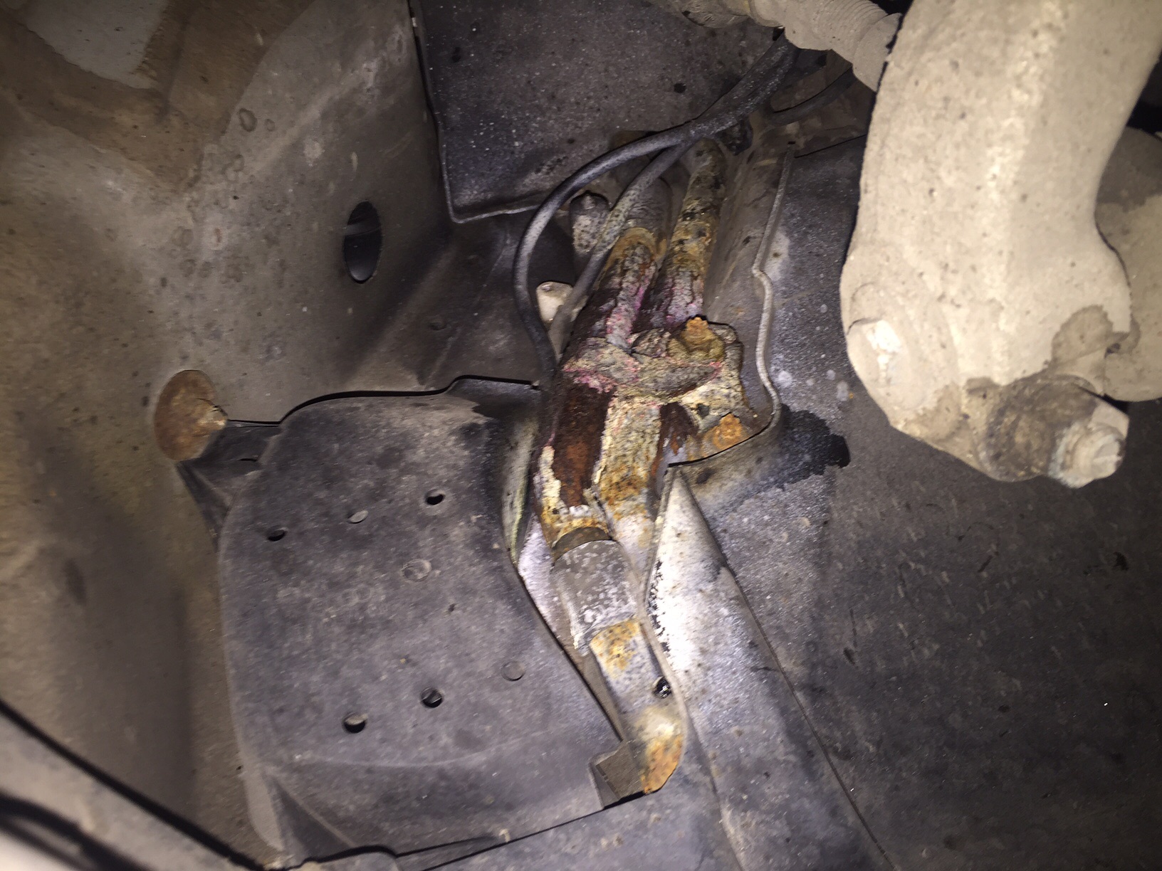

discostu49 wrote:Funny you say that just wiped a little of my lines with a bit of kitchen roll and they were covered in some oily grease ...bear in mind my pipes have been replaced. What's strange is that a wee sleaved wire has nothing on it in terms of the oily residue pic below
Nice pipes Image mine look nothing like that...wondering if I should just coat them in grease and hope for the best of would that just be pointless? Audi gave them a clean bill of health and looking back at my photo it looks like a past of the pipes is corroded the rest is the metal clamp.

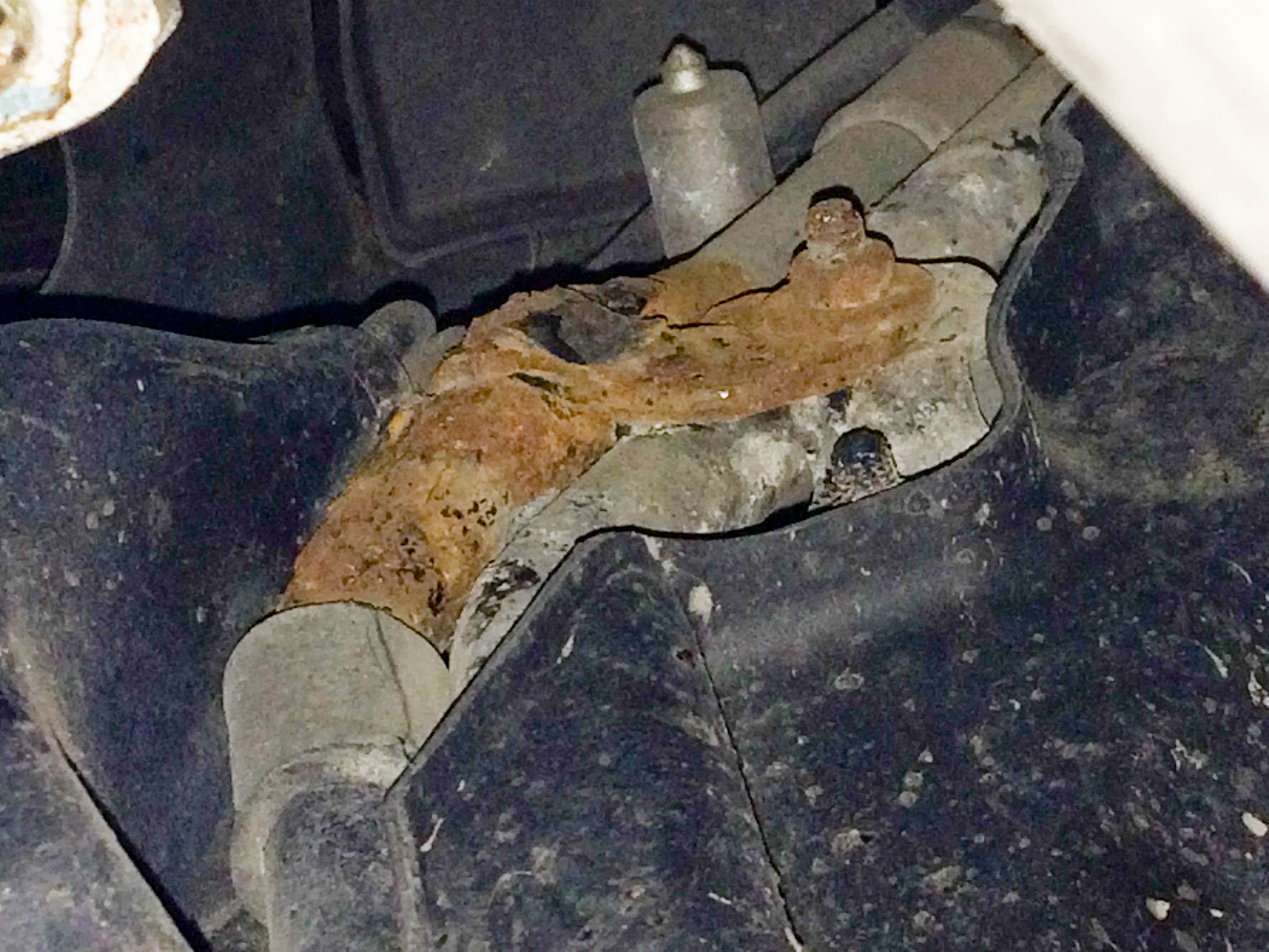

Just had mine replaced! They were nasty, car's a 2008 on 46k miles. Basically every C6 needs this doing asap, its not an engine out job and Unit20 had in done in a morning! I regularly covered mine with white grease to protect them too

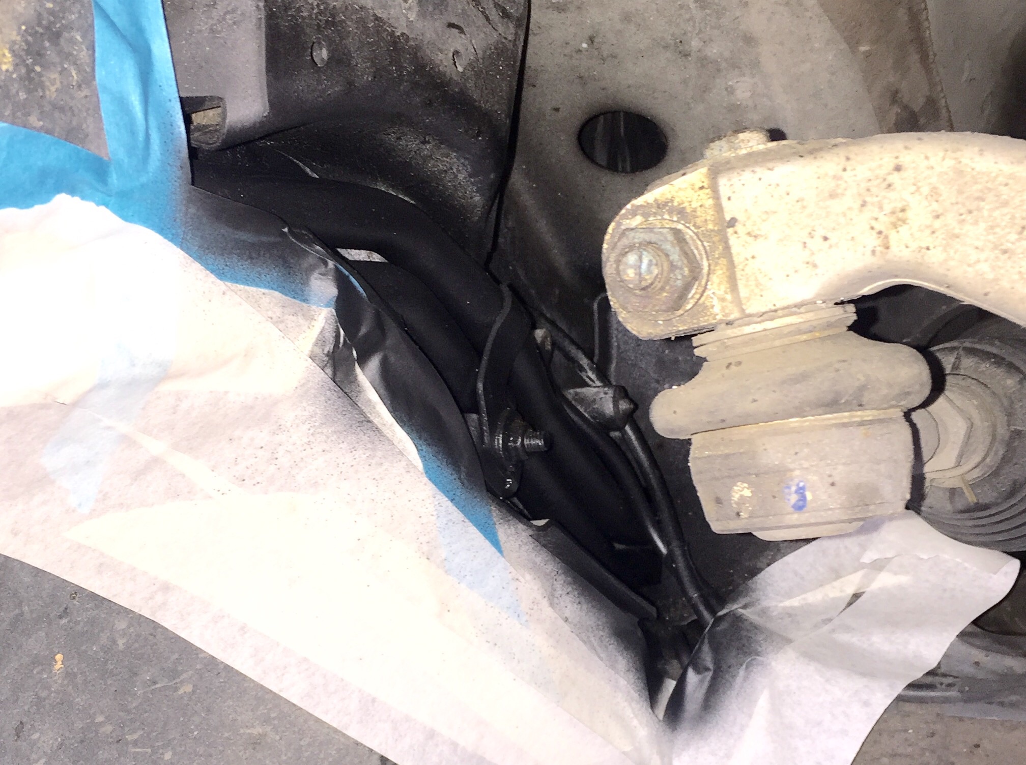

I'm just painting my new ones with stone guard. Unit20 have fitted genuine parts not custom and there's no evidence of cutting and joining.

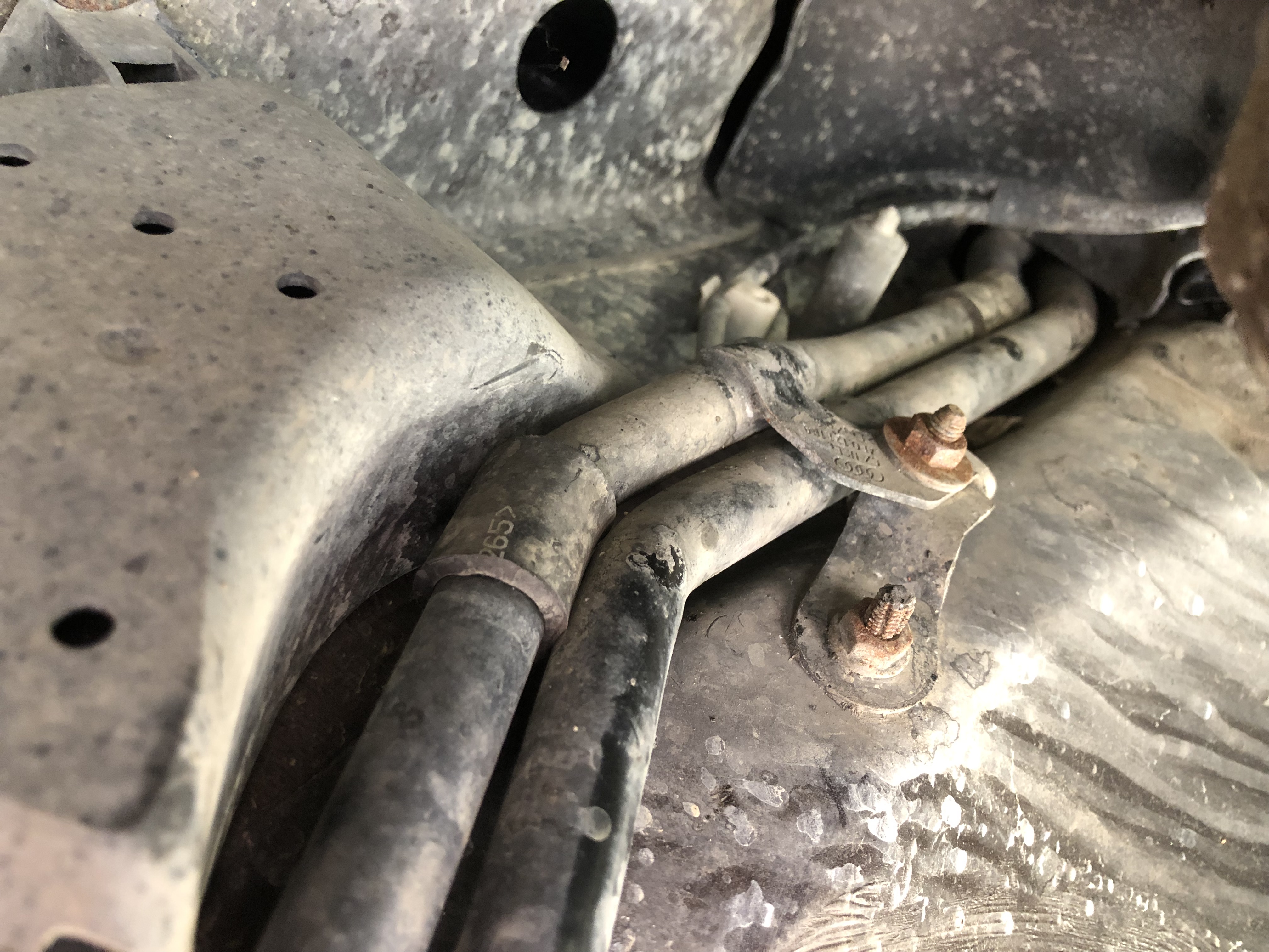

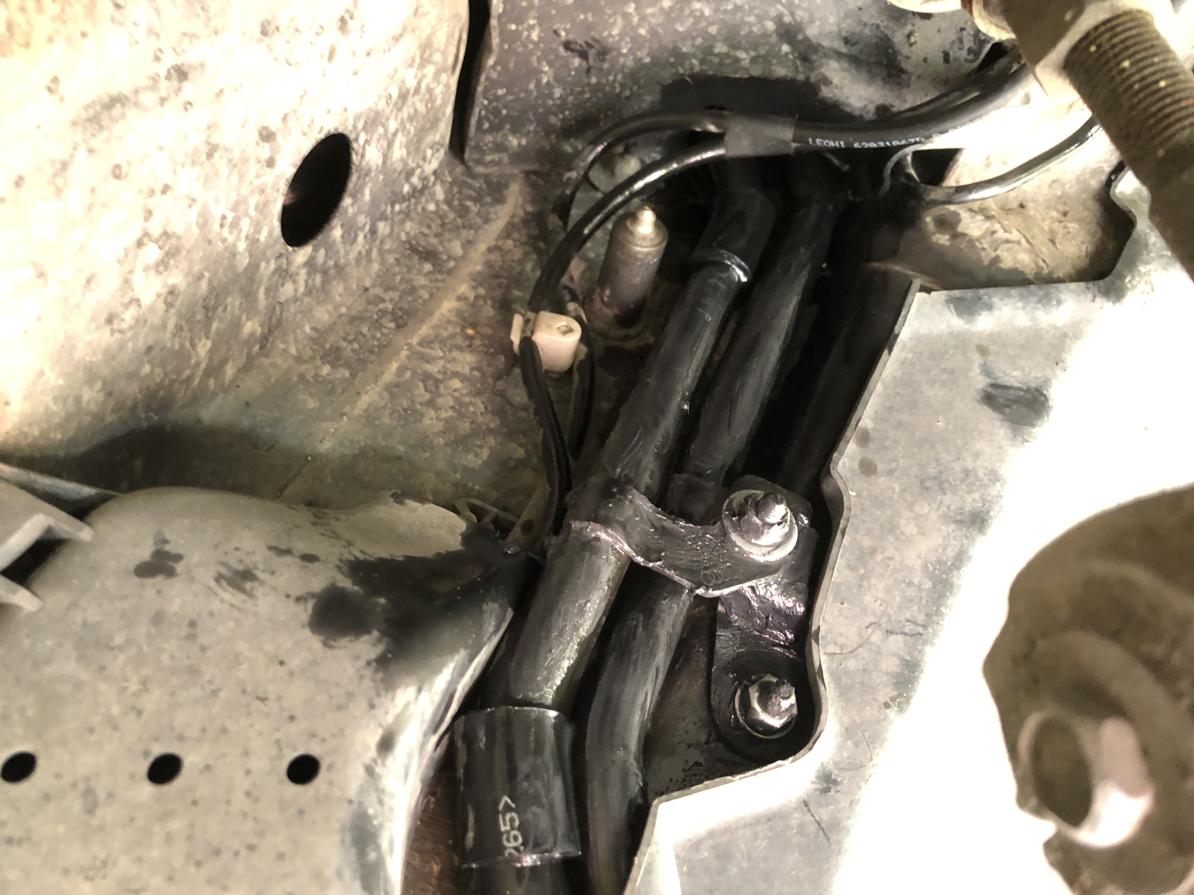

Does anyone know what colour the original coolant pipes are? I took my offside wheel off today to take a look at the condition, mine look black but in some of the photos the pipes look silver. All cleaned up nicely so I will perform annual checks. Car is on 31,000 miles but have seen some need changing around 40k so I was expecting to see a lot worse. Before and after pics below.

Post by Jim Haseltine » Sat Jun 22, 2019 2:27 pm
They're black. The OE coating is poor stuff to put things mildly - the guys who coated my new ones were less than impressed and also slightly surprised that the original pipes on my car had lasted as long as they did. Yours look amazingly good compared to most.
