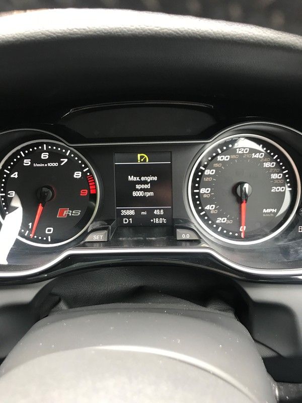

I am absolutely loving it so far. However, once it was at home and had cooled down, I then had to jump in it to meet my wife from the station. When I started it it came up with a warning light saying Max. Engine Speed 6000 Rpm. I let the car idle and it went away. I removed the key from the ignition put it back in again and the warning did not reappear. The car also did not feel as if it was in limp mode or anything. The car has been running like a dream and I have almost done 500 miles in it since picking it up. Today however the light came on again when I fired it up. I did same trick as before but the light came on again on the second start. I called the dealer who I bought the car from and he said it maybe because the car is warming up (seems strange) and that they hadn't heard of it before (they are a performance Audi specialist). I was on my way to a meeting so carried on, however when I was crawling around the corner from my road the revs started hunting and dropped down to a stall when I stopped the car. I restarted. No warning. Drove off and again all fine. Does anyone have any ideas what this could be? It is going back to dealer for diagnostics but I just wanted to see if anyone had experienced similar. Car has not done 36,000 miles yet...

With the RS4 you can't rev it hard until its warm, it won't let you but in over 2 years I have never seen this message. When they are cold they just short shift preventing you going into the higher rev range.

When you fire it up, are you by chance hitting the gas and the engine revving high?

Nope, foot on brake, key in ignition, push it in to start, fires up then warning light comes on. I let the car cool down completely from my drive earlier, started it up again tonight, no warning light. Seems like a computer or sensor fault. Need to get it on diagnostics. It had a major service before handover so surprised nothing was flagged up.

Other thought it is a warning that could be added using coding by a previous owner?

It's a fault but I'm afraid I cant remember what
Nothing to do with the cold soft limiter

A quick google on the same issue almost always ends up at the oil pressure sensor or switch. A quick scan will reveal any codes but if still in main dealer warranty I would pop it in to get it checked.

That might ring a bell!
It was quick enough to fix - half a day mayb

They think they know what is causing the warning light to come on and when I said about new software for the DSG box, they also acknowledged that and said yes there is a newer software available which should cure that, apparently SQ5's suffer from it badly.
