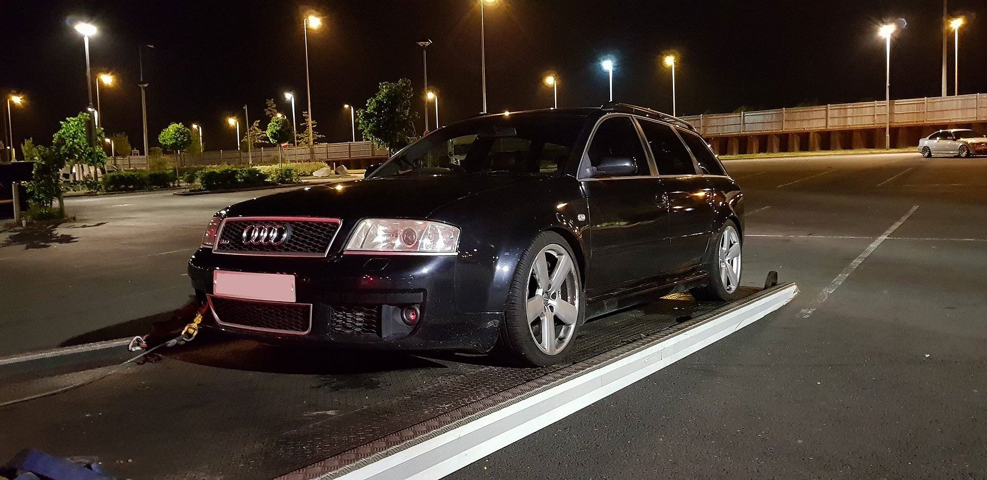

Yes, I've gone and done it again... didn't I learn anything last time??
It's yet another dead gearbox'd C5 RS6 but this time... it doesn't move at all no matter which gear you select so I suspect the torque convertor or oil pump.
There are a host of faults in the car so there's work to do.
Does anyone know this car previously?
It's black, black (white pinstripe) interior with carbon effect trim. First registered in Jan 2004 and needs a lot of TLC.
I'd be keen to find out as much as possible about it's history. Yes I did an HPI on it so I know some but it has no service history at all.
