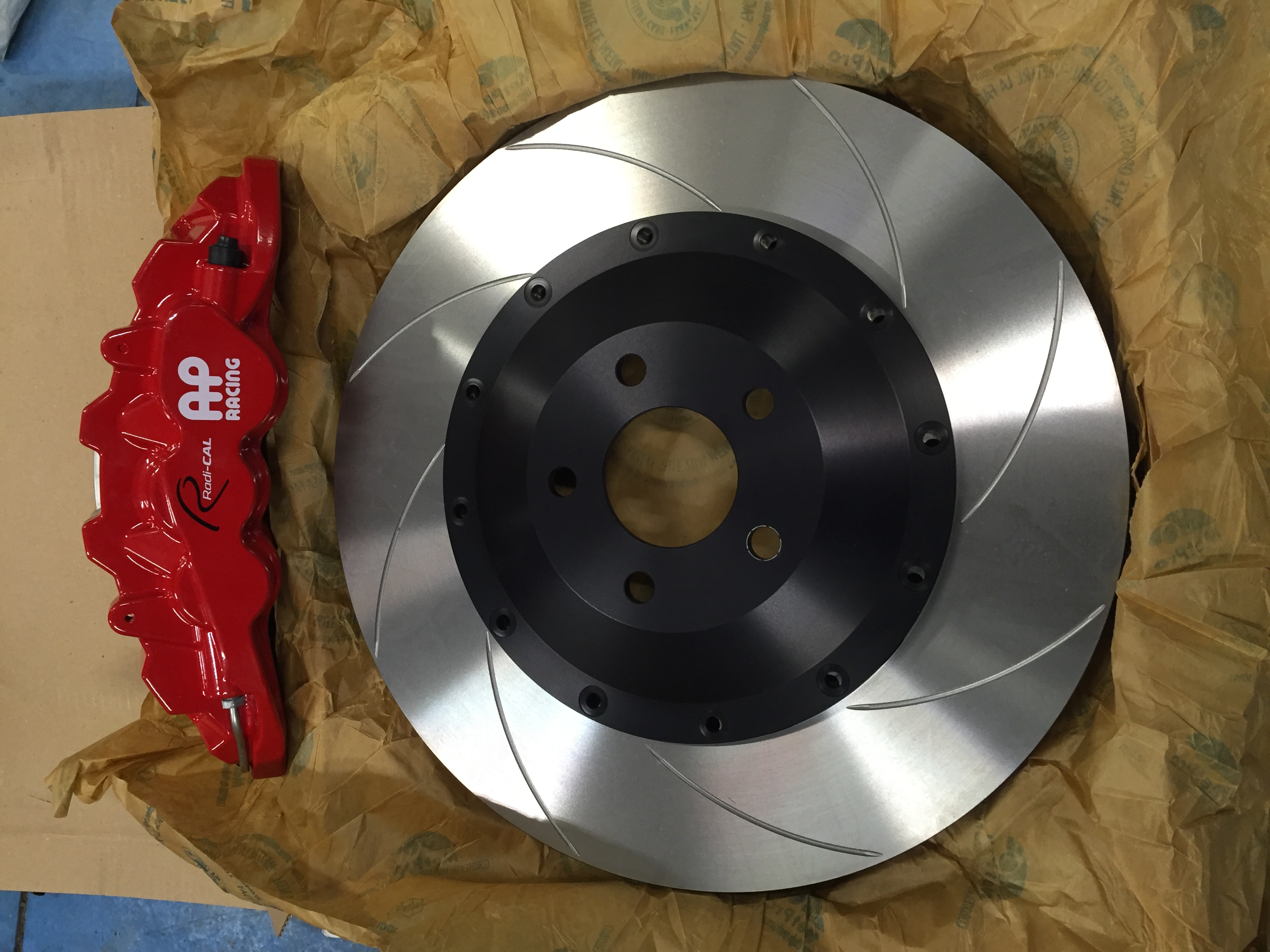

What do you get in the kit - 2x Discs, 2x calipers, brackets & mounting bolts and 4x AP DS25 pads with fitting kit (Ferodo DS2500 compound on AP backing plate)

Pictures
Brand New -

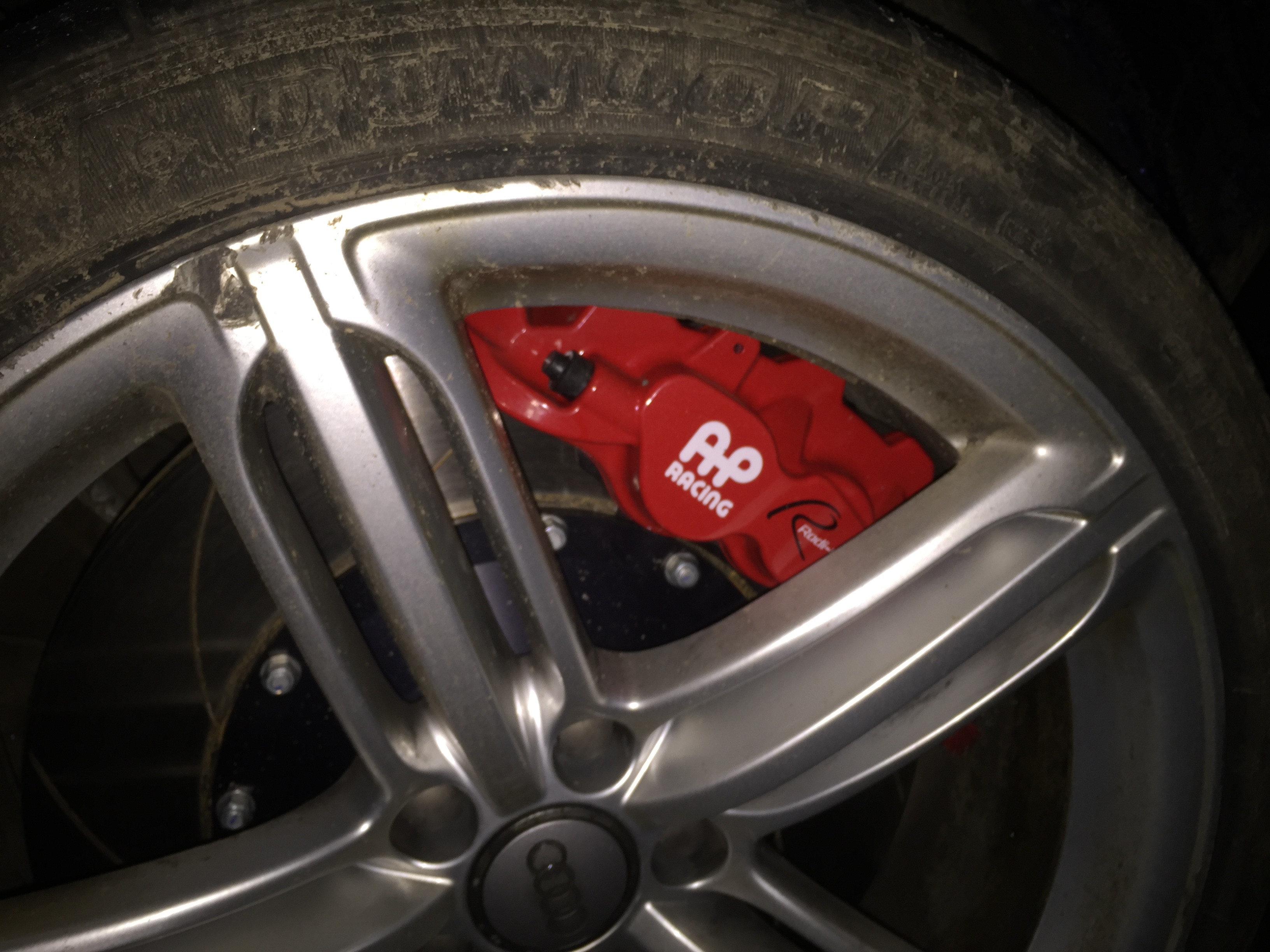

Post by RossH14 » Sat Mar 18, 2017 12:20 am
a quick night shot for those nice RED (sorry Ian, i know you like to be discreet) calipers
- i apologise for the truly awful state of the wheels - they need a refurb!
