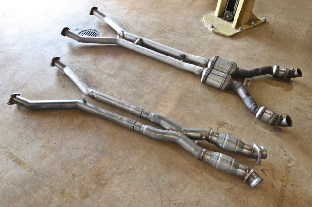

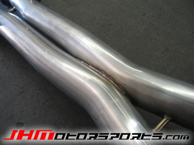

another thing to note is all x pipes are not created equal, i have seen some x pipes on here that are probably more restrictive than the standard center section.
you want a smooth long "X", no sharp bends not to much crossover. a well designed x pipe will help a NA v8 breath.
here are a couple of examples-
not like this...
bad
x pipe bad.jpg (6.05 KiB) Viewed 2898 times
bad
bad x.jpg (8.98 KiB) Viewed 2898 times
more like this...
good
good

Re: X PIPE
Post by MikeFish » Sun Mar 12, 2017 2:35 pm
Even more reason to stick with straight pipes. I really can't see there being any notocable difference for the more complex x pipe arrangement. Audi decided to keep the pipes separate in the centre resonator so that is good enough for me.

Post by sar » Sun Mar 12, 2017 4:57 pm
while i agree expecting random exhaust Shop A to throw in a "off the top of their head" x pipe design isn't going to increase power over just straight pipes, the benefits of a good x pipe(read that as many hours of design, many prototypes and dyno testing) on a v8 really are not up for debate. it has been proven time after time on american muscle and even on our rs4's.
as for what audi decided to do as being good enough for you, you didnt agree with their choice of sound system, or the wheels, or the........... :bigblink:
