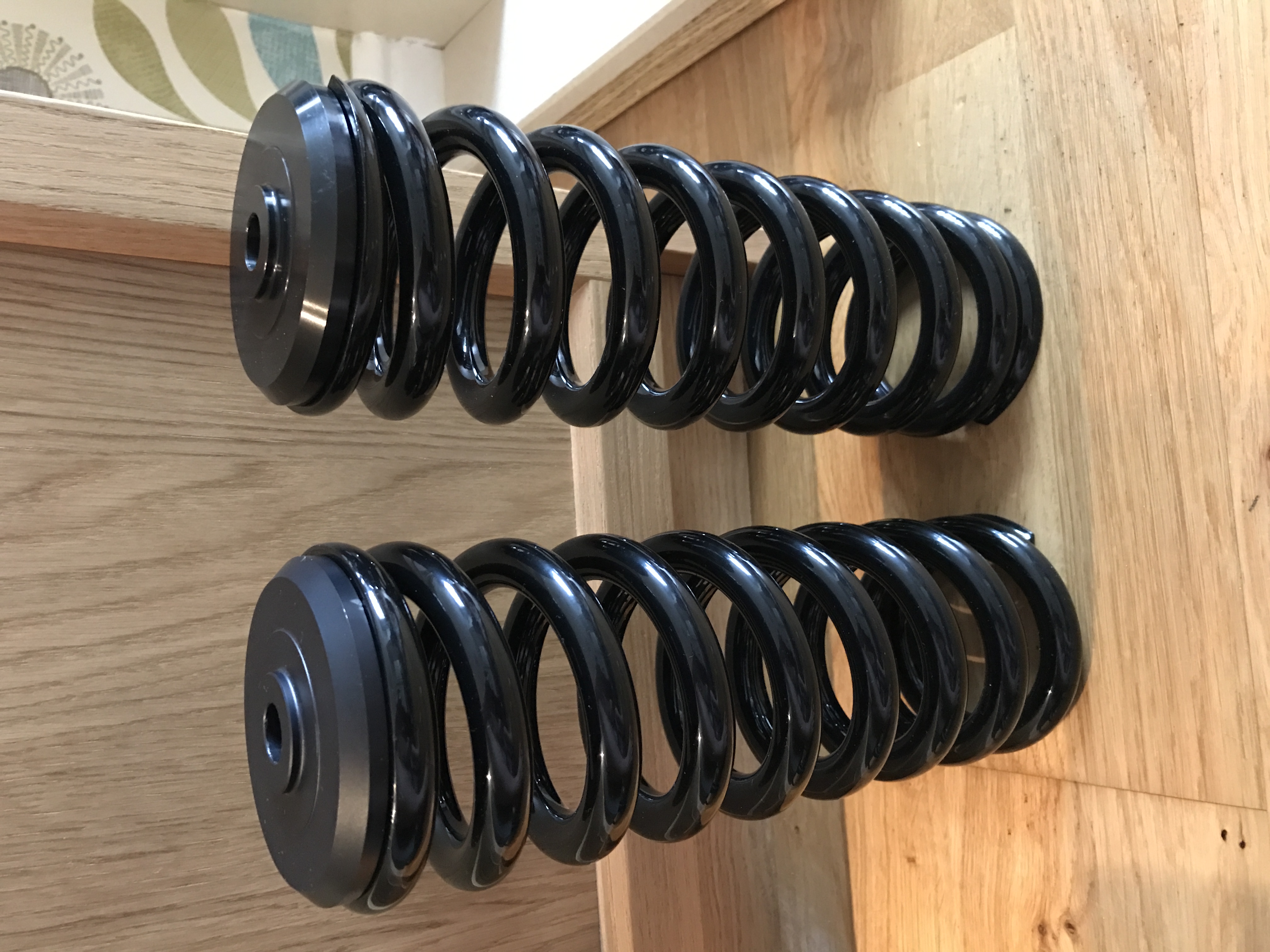

I've just ordered some custom rear springs for my h&r's as they have sagged a lot. Spec'd the same as bilstiens and only £40 a side, I gave up on the hunt for standard springs as it was taking too long.

Post by Cbardell » Thu Feb 23, 2017 8:53 am
To be fitted this weekend....

I got the spring rates for the PSS9 from Bilstien, they gave them in Nm at 100 rear and 90 front.
The 100 rears work out arround 575lbs but the closest I could get in 2.5" was 600 at the time I ordered as I didn't want to wait lol
Ordered from D.Faulkner. http://www.dfaulknersprings.com
I used to work for a support race team to the BTTC and these guys were recommended by my old contacts.
They do a bulk buy discount scheme so depending on this weekends outcome it might be worth organising a group buy for all the saggy H&R owners as I'll probably do my fronts too.

Today didn't go to plan, epic fail on the spring length measurement before ordering. :bash:
Car now sits like an allroad and the spring seats touch the drive shafts! New shorter springs ordered will be fitted Tuesday.
