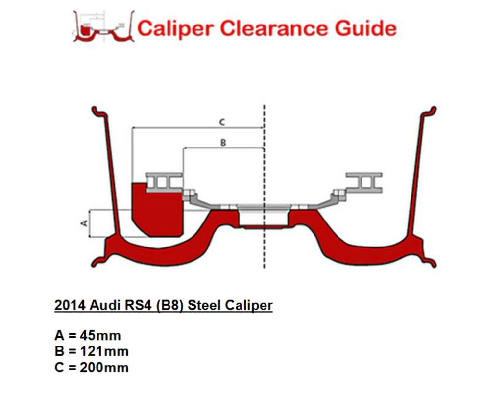

Here's the steel (i.e. non-ceramic) caliper measurements for the B8 which I tend to use when buying alloys...
My current summer alloys are a similar 20 x 10 ET20 fitted 265/30 R20 though I DID experience rubbing at rear under load and during spirited cornering. This was overcome by introducing a -2 degree camber which is, apparently, the maximum negative adjustment. I haven't notice any significant uneven tyre wear as a result. They are nice & flush.
