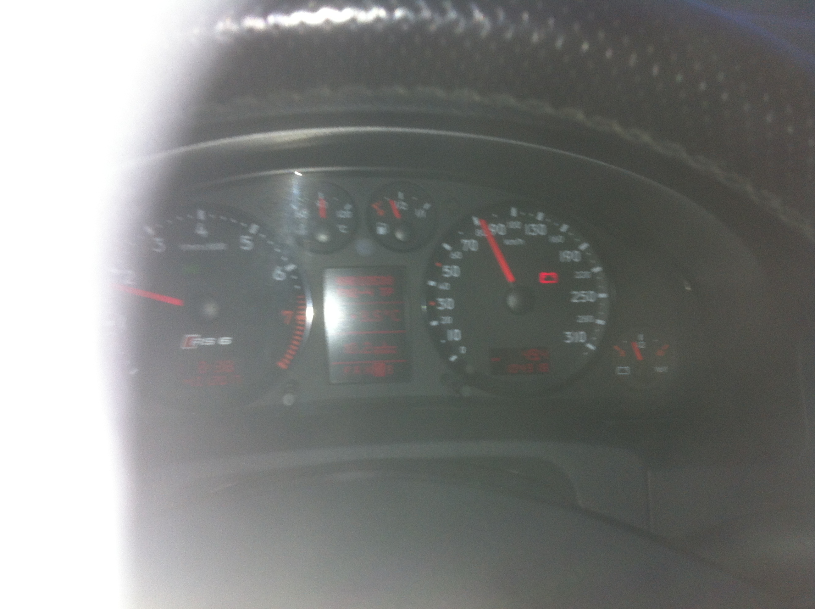

Now using the 6 as a daily driver, the battery light and voltage drop (as shown in the pic) issue is seen while driving.
I thought it was because of a bad battery and replaced that some years ago, but now the car isnt connected to the battery charger/conditioner at night, it looks like the Alternator is the culprit.
Will have a look to take it out and see if i can just replace some bits and pecies or order a New one....

You can buy a voltage regulator which includes the brushes. Don't forget to check the connections on the bulkhead under the expansion tank.

Most likely the regulator.

Part number: 077 903 803A
Equivalents:
Beru 0190005093 or GER 093 http://www.topersatzteile.de/motoroel/beru/7020835
BOSCH: F 00M 144 138 or F 00M 145 247 or F 00M 145 357
/actually that link will give you a load of other equivalencies.
Equivalents:

I bought this regulator - it was a genuine bosch part.
