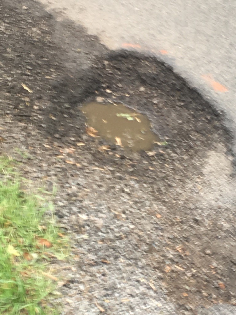

Hit a pothole and did this to my wheel. Gutted.

Re: Deformed Wheels Register
Sue the council.....rental car, new wheel £35 issue fee, small claims court; probably so inept, that you will get judgement in default as they won't turn up!!
