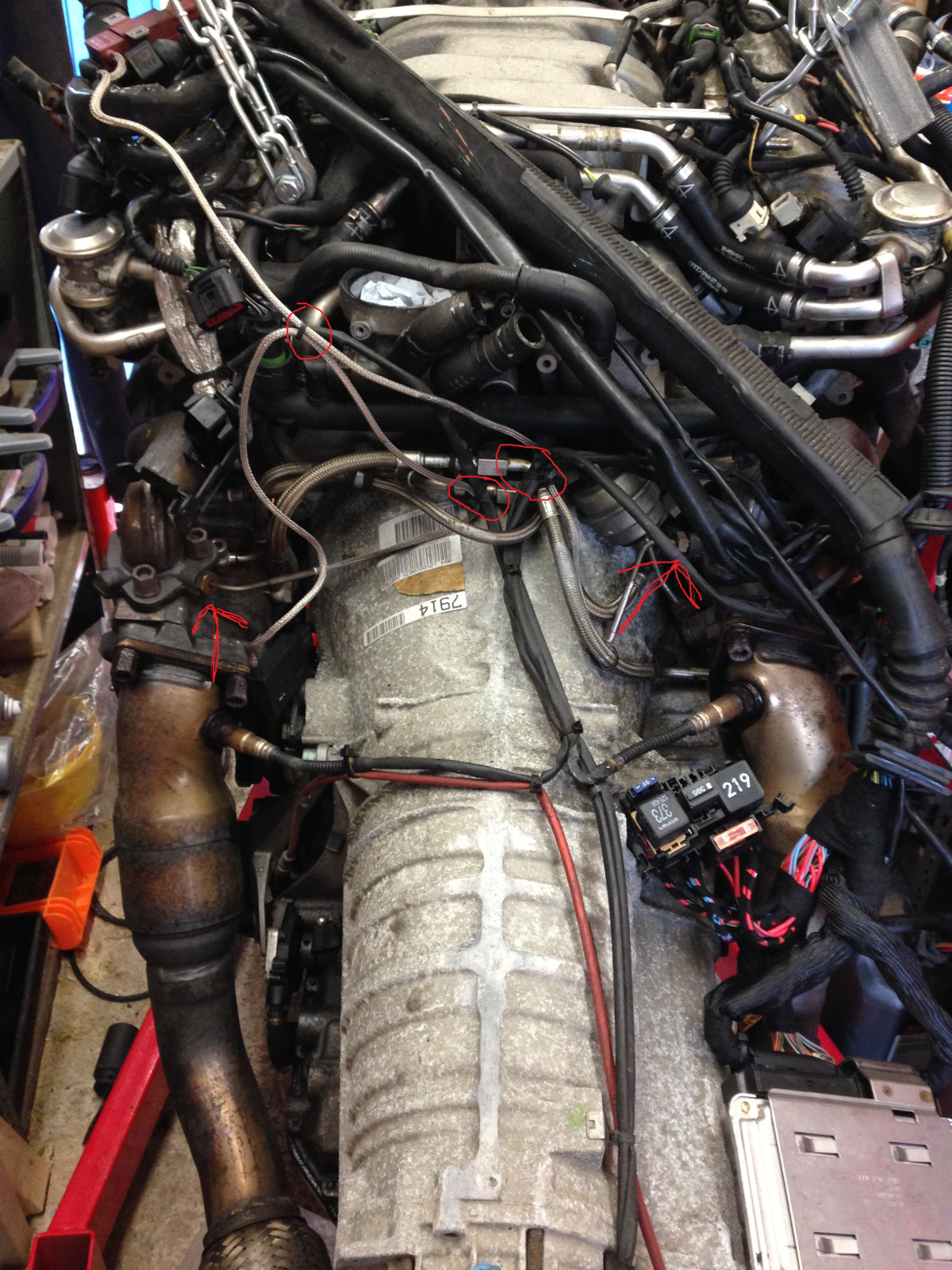

Just for reference, here is a pic of them in situ (engine out). I've marked the sensors and the points where mine were cable tied.
They are easy to undo (not like the turbo bolts) but they have a long rigid bit for the initial part of the cable so not sure how hard it will be to manoeuvre out.
Also, as shop said, could be the electronics up top that have gone. The sensor itself is fairly simple in construction and so might be worth trying to splice a new top end first before spending hours on pulling the actual sensors.

Yeh, I know what & where it all goes having taken my engine & box out 2x before (Once for box, 2nd for turbos). I have an almost identical pic of my box & motor on the garage floor. :) It's just a question of working out the easiest way to do it. On stands too, I don't have a lift.
