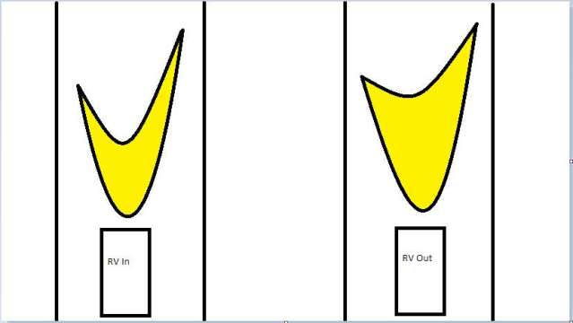

This is what removing the RV shield does (shows LHD not RHD):

The RV shield is the shiny bit stuck on the main shutter with RV on it:
It has a few aims. 1) to reduce the colour at the cut off, 2) to blur the cut-off so it is less distracting and 3) to make the gradient of the ECE beam pattern more shallow.
Problem is you lose some beam throw in the centre as in the pic above because the light that passes the shutter from the reflector in a downwards direction is blocked by the shield which is a bit further out. This downward light = upward light after it is flipped in the lens.
