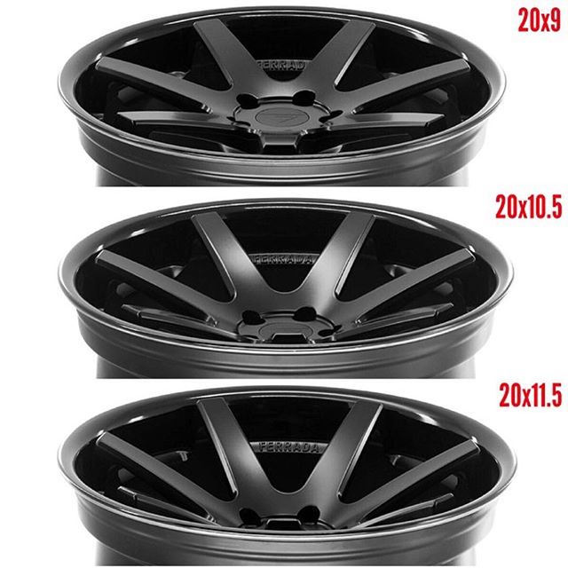

The following image is of the Ferrada wheel design and demonstrates how concavity can be enhanced by using a wider rim.
So, in answer to your question, the reason for going from a 9" (or 10") rim to a 10.5" rim is to improve appearance by deepening the concavity.
