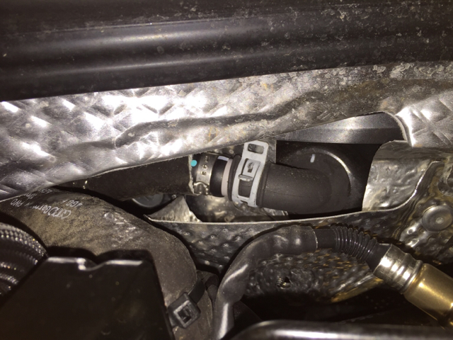

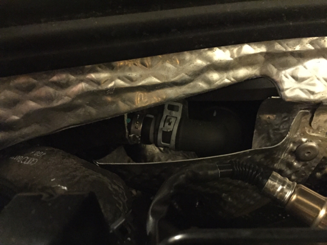

Post by CH3OH » Fri Feb 12, 2016 2:55 pm
Before
After

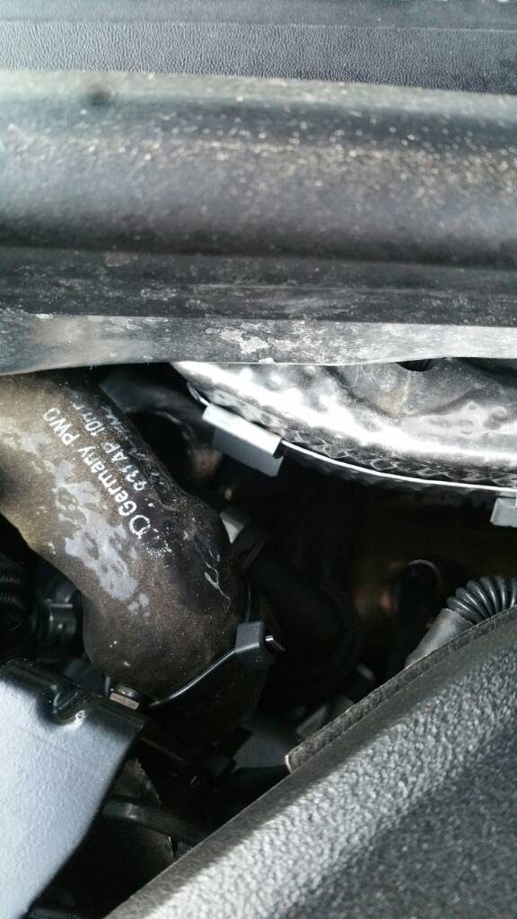

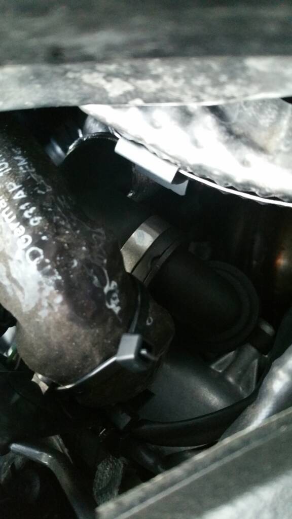

Post by Needmorespace » Thu Mar 17, 2016 11:09 pm
Can't find any sign of the clips or the metal cover near the hose through the firewall. I wonder if Audi removed this when it was back for other work. See photos, am I missing something?
