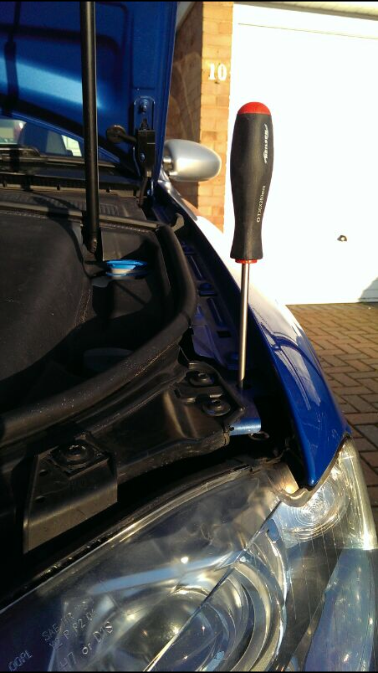

Just been on Google and many people have said the same , my passenger headlight where it meets the wing feels lose and is slightly sticking out front the wing not sitting flush and when you tap it its wobbling about ?? is there a clip behind it to hold it in place ?
Sorry I've never removed these headlights before , there is no marks on the paint to suggest someone has hit it either which is odd !!

There's a screw that holds the headlight down this hole. Try see if it's loose.
