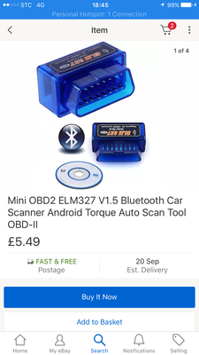

I read somewhere on google you can buy a diagnostic tool fairly cheap for audis is this true do you know?

Get one of these and download the app 'Torque' from the google play store. Allows you to read the fault codes and also reset them if you want.

Markwes wrote:Get one of these and download the app 'Torque' from the google play store. Allows you to read the fault codes and also reset them if you want.
And these work ok yeah?

Yes they do the job and are cheap.
