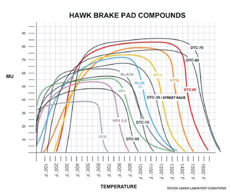

Initial impressions on the Hawk HPS
I'm comparing to the OEM pads that came off the car. They still had a bit more life in them, but I wanted to change them anyway.
I knew from seeing the graph below, and forum feedback, that the Hawks would underperform OEM when cold.
hawk-2004-2014-lamborghini-gallardo-2003-audi-rs6-v8-2007-2008-audi-rs4-2008-2011-audi-r8-hps-[3]-56533-p.jpg
Well, I wasn't expecting just how much they underperform when cold! The brakes feel completely wooden the first time they are applied. I nearly overshot a junction over the weekend pulling out of a car park, as I temporarily forgot about this!
Looking back at the graph, from stone cold it looks like the coefficient of friction of the HPS is about half of that when up to temperature - certainly feels that way. I should have expected it really. Note the "OEM" line seems much flatter in comparison.
That's the bad news. But, fortunately it only seems to take a couple of applications to get them working. .
When up to temperature though, they seem to grab the discs significantly better than OEM. Great bite, and the car feels like it's had a much more significant brake upgrade than just a new set of pads. Had a good run up the A3 yesterday with an Evo behind me, up to some naughty speeds, when we hit completely stationary traffic ahead of the the M25 junction over the crest of a slight hill, so saw it late - got on the brakes hard and in my mind I went from "oh sh!t" to "oh sh!t these brakes are awesome!" Could have been brown trousers (well, shorts) with the OEM pads.
No squeeks/squeels noticed so far either.
Hoping I'll get a chance to try them out on track at Audi Driver. But so far, I'm liking them (apart from the cold performance).

Glad it worked out, yeah cold or wet takes a few bites... and since I am in warm climate the rain is my only issue for a second or 2. And agree with you on bite when warmed up - very good, and no noice issues.
