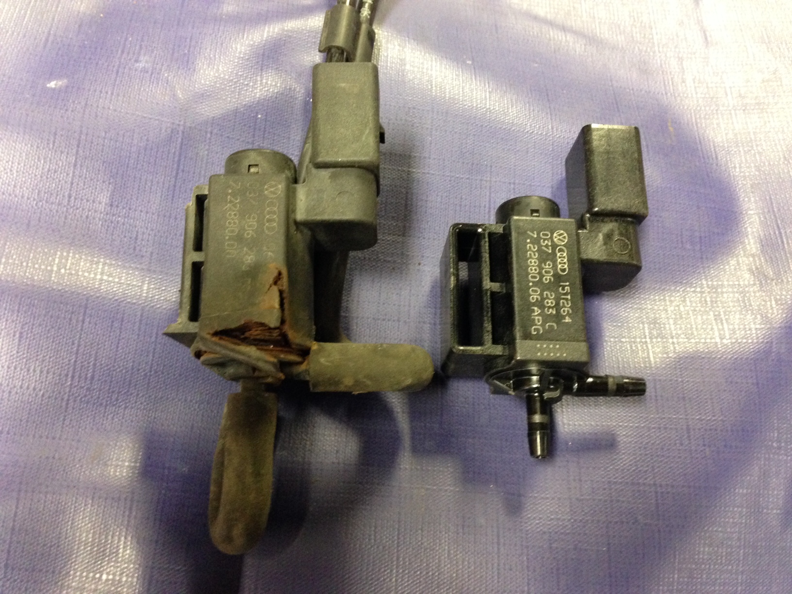

On mine the relay that controls the vacuum to the power flap had rotted and was leaking the vac so both maniflod flaps and power flaps were not opening. This relay is low down under the airbox so not the cleanest driest place so rotting is not a big surprise IMO.
The vac line to the left from the double T at front of engine goes to the power flap only. So if you suspect the power flap relay then you can remove this line and plug the open end of the T. This isolated the leak for me and manifold flaps were then working. Replaced the rotted relay and was then all ok.
power flap relay

PaulT wrote:On mine the relay that controls the vacuum to the power flap had rotted and was leaking the vac so both maniflod flaps and power flaps were not opening. This relay is low down under the airbox so not the cleanest driest place so rotting is not a big surprise IMO.
i supose in a way finding something like this is nice in that it's a clear cut failing.
