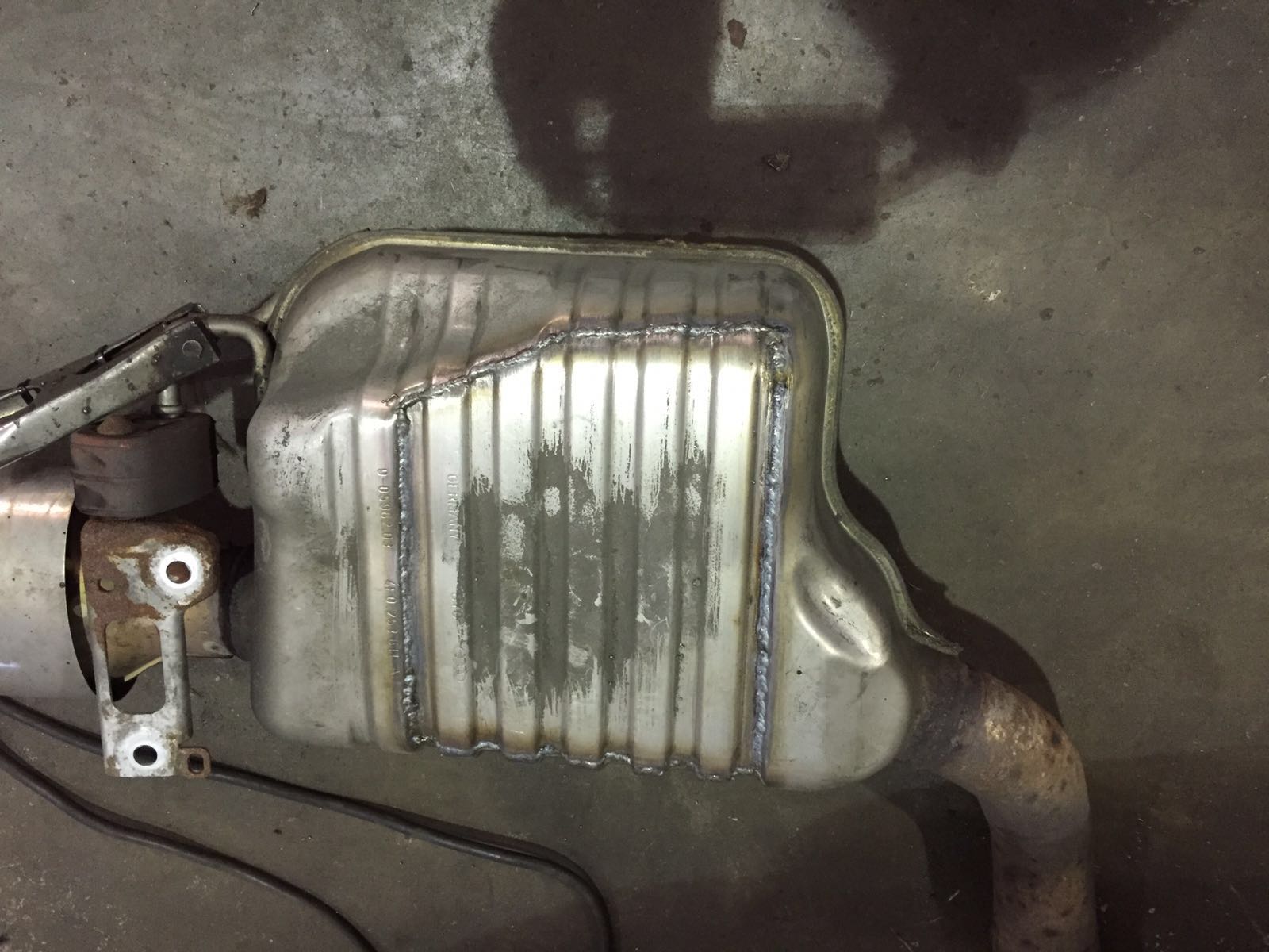

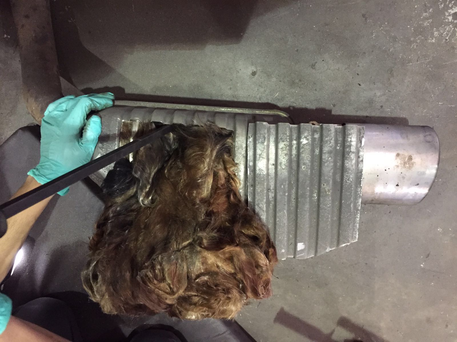

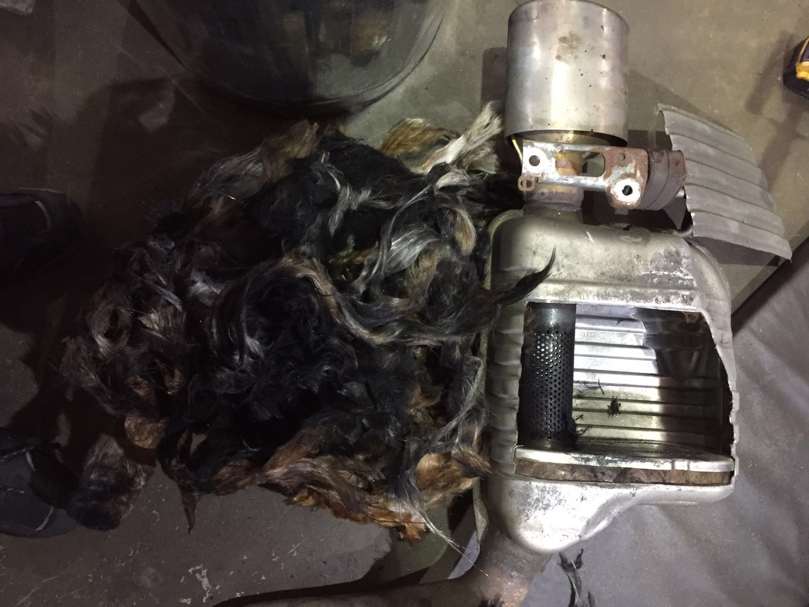

After reading through this post i decided to have this done.
A much better sound than stock. Full throttle accelerations sound the business, and very minimal / no drone at crusing speed.
An inexpensive mod and personally I think it sounds better than offerings from milltek.
Best thing about it all is it all looks stock as opted for gutting the mufflers, so all orginal hangers and mounts for exhaust have been used.

Ah good work Bhav.
Am I right in saying that you've removed all the material from inside the back box then??
Thanks, yes all the insides are now empty.

Post by longman h » Thu Jul 28, 2016 9:34 pm
So the pipes within the back box are still there but everything else has been removed?

longman h wrote:So the pipes within the back box are still there but everything else has been removed?
Yes mate the pipes are still in.
