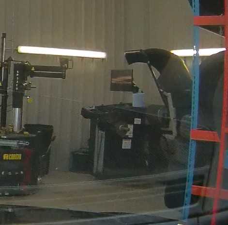

this is the unit they balanced the wheels with.
Not sure what it is.

Looks like that balancer has a roller so probably RF, albeit usually red.
