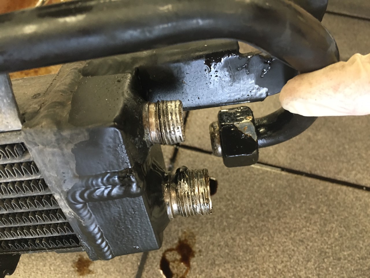

Cambelt done, no problem but the oil cooler pipeworks so corroded not able to refit ( alu on alu fittings don't work and i'm not an engineer)

Now have these images

Check this thread out by MattV8 which works out much cheaper than Audi! - viewtopic.php?f=2&t=113332&p=744584&hil ... er#p744584
Re: oil Cooler pipework
And >12 months on is still pukka.
Just suggest you do use teflon hose - it's smaller so should be a bit easier to work with.

Looking at the pics above, a bit of careful use with a needle file (with the end's plugged with some blue Shop towel - not a rag) wouldn't go amiss.
Also looks like you may need to replace the hard line with a hose too - shouldn't be too much of a big deal though.
Looks like the top thread is mostly stripped. Maybe damaged inside the nut, too. That's probably why Audi don't want to fit it.
Sounds like they're charging you full retail for parts. Maybe try negotiating the price down a bit?
Or you could try recutting the threads but I bet Audi won't want to do that.
I wonder why they removed it. Don't think it has to come off for either cambelt or rad but haven't checked the procedures so could be wrong about the rad (but not the cambelt, definitely).

You should be able to have the oil cooler reworked by someone with a little welding talent - cut the old ends off the cooler and fab some new ones.

"Reworking" - yes, technically possible. I know a man who is an awesome fabricator & tig welder. But I figured, to cut the end off would be with a hacksaw, which'll create lots of debris, some of which you won't be able to avoid getting inside the cooler. And debris in the the cooler is a bad thing.
"Replacing" - yes, also considered this. Quite easy to do, although struggled to find one of pretty damn close to the right dimensions - and I didn't want to rework all the front end ducting. Remember our coolers are dual core - 1 for engine oil, the other for gearbox, so you'll need to buy 2, then build brackets etc to mount them and so forth.
