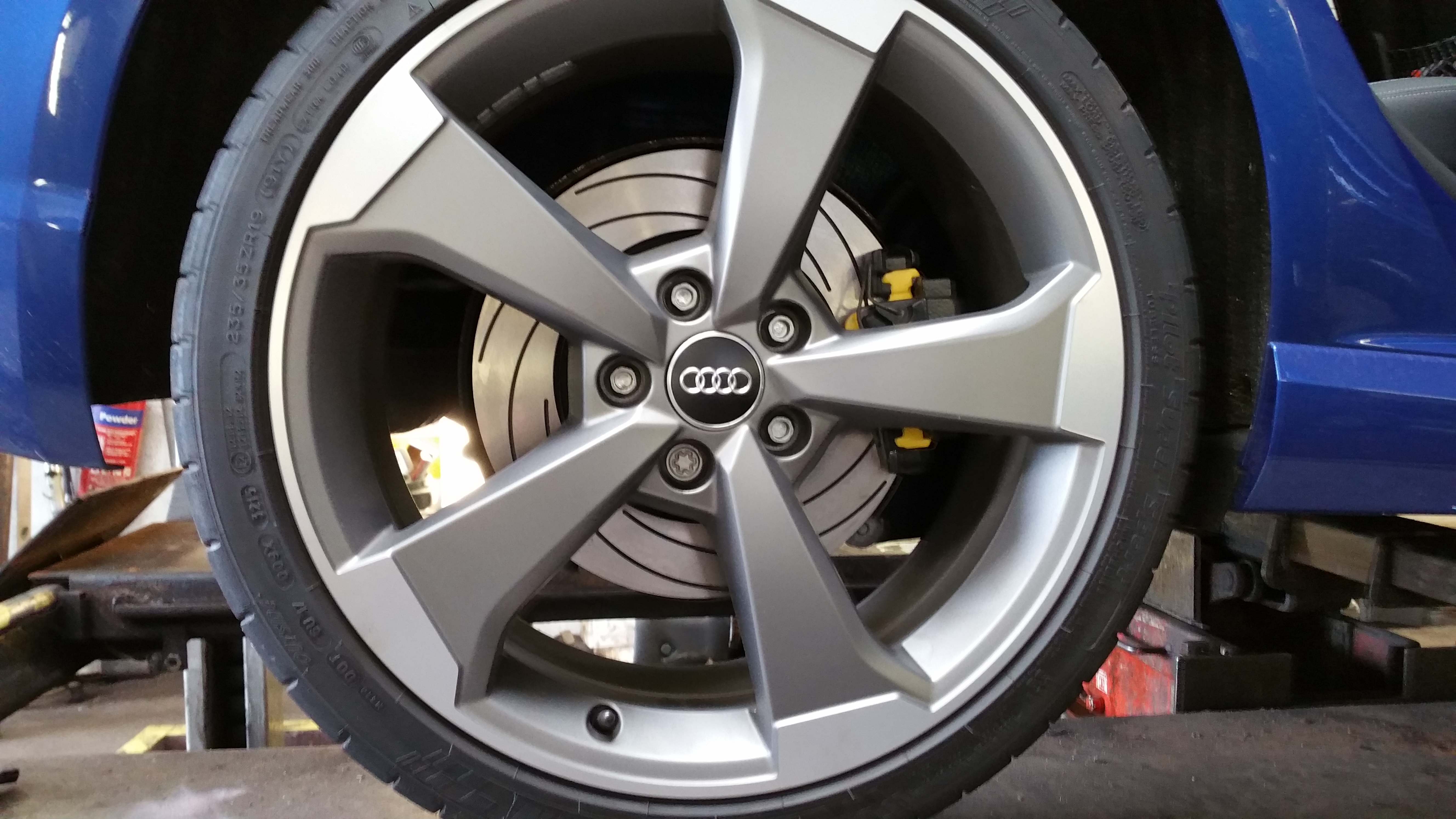

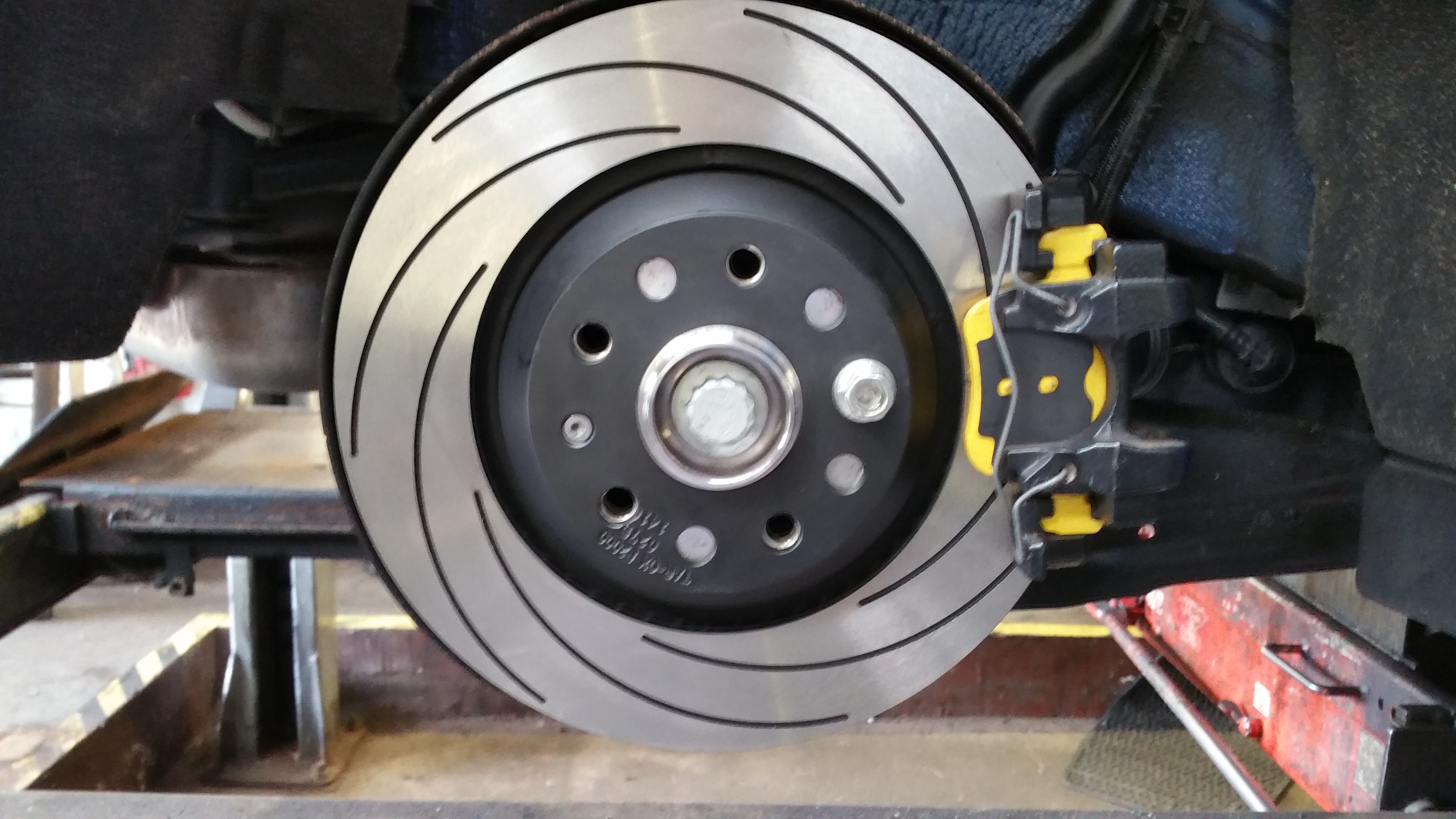

I picked these up yesterday to replace my knackers fronts discs - I believe there are the first pair out in the wild:
Front inside:
Front outside:
Front cooling:
Rear:
I just need to get the VCDS cable/software am my Autel VAG505 has failed me on my RS3, it will not work on the ESB :(

I thought I would post up my rear discs swap that I carried out today, just for the record on the 8V chassis the rear caliper brackets do NOT need to be removed to replace the discs, only the caliper slider pins which makes the jobs much less painless :)
I think you will agree that they look a lot better than OEM, particularly with the matching front Tarox discs.
