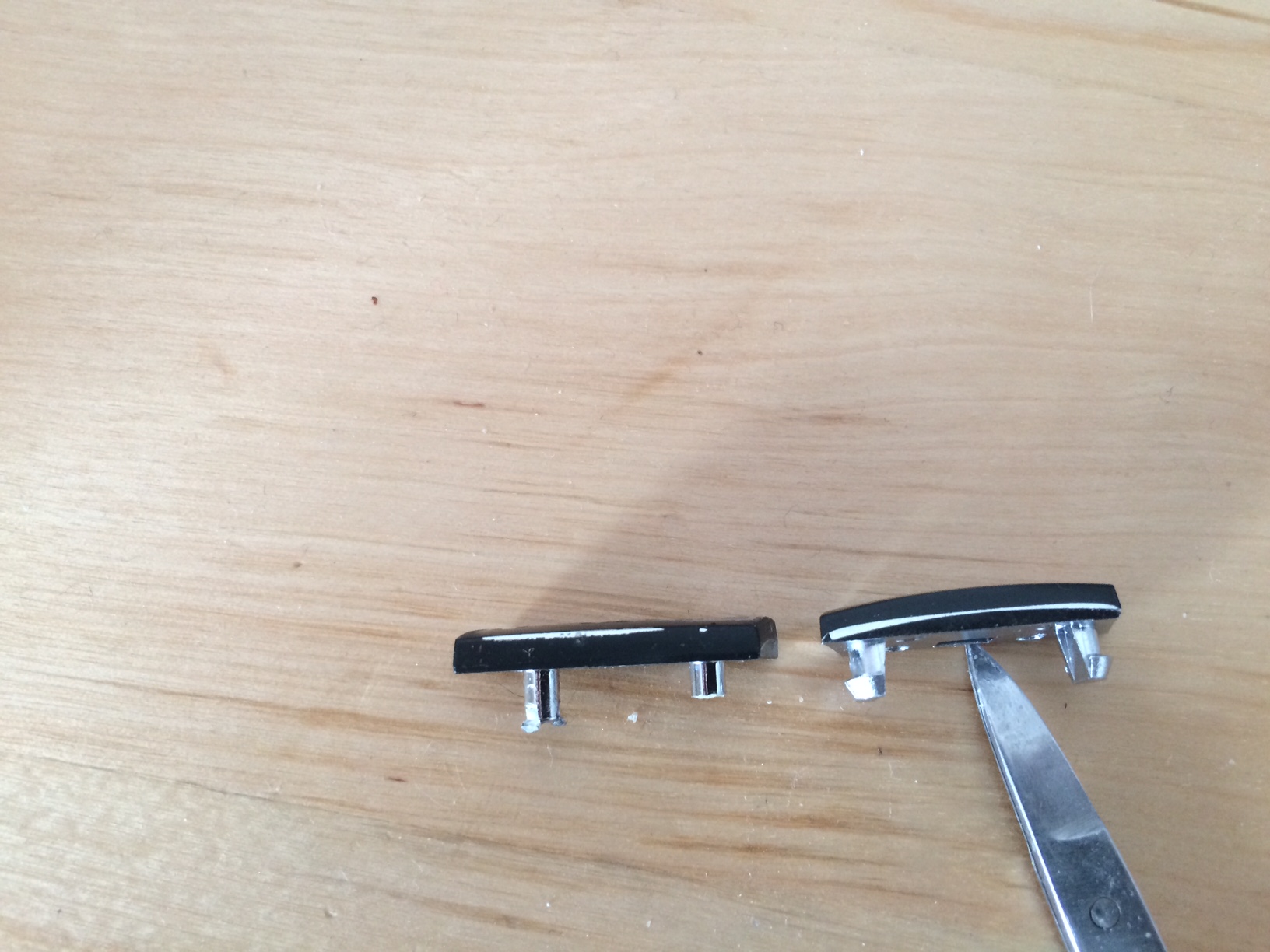

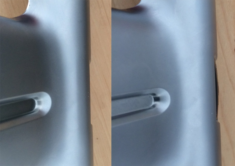

Couple things, your dead right about the stand alone badge part(8D0419685A). Whilst it is the correct width/height and the fixings lugs are different as you mention, the surface of the badge is slightly concave, whereas the original badge is completely flat and it sits recessed in the silver trim. You'll only know this one you remove the old badge and compare them side by side(pic below). So even if you modify it to fit(which is quite simple), they'll be a slightly curvature to it that the original badge doesn't have.
I removed the bottom section of the steering wheel with some trim tools starting at the back, you don't need to remove the air bag to get it off.
Photo's below show the original badge and the non original 8D0419685A installed. Once installed you can feel the difference of the curve more than you can see it. I guess it depends on how anal your are about such things. Price difference between the parts is £55 or so. Guess it depends if you can get the silver trim off without causing any damage as to whether you have the choice.
