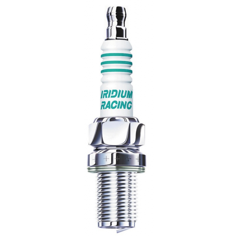

TBH you be nuts to run std heat range on stage 2 plus (below is the premium option but std plug but one cooler is fine),
we use these in all our in house tuned cars (modified stage 2 plus);
DENSO IK01-24
or NGK
R7434-8 (i use these in my own car at 645hp at all 4 wheels)
Both have the better electrode design, which reduces the chance of det damage and is a few heat ranges cooler.
STD setups or stage 1 or 2:
DENSO IK01-22
or NGK
R7434-7
Better tip design but only one heat range cooler.
