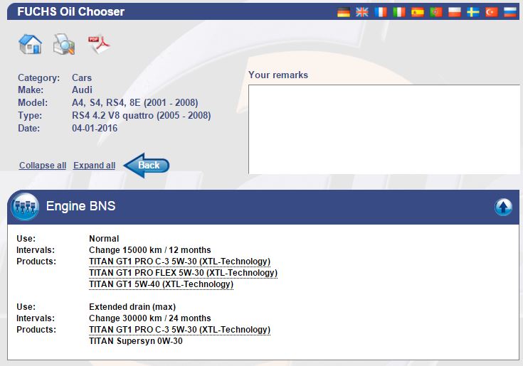

£87 for 20L Titan GT1 5w30 on the link below. I'll be ordering this when mine needs a service in a month or two:
http://www.ebay.co.uk/itm/271450729828? ... EBIDX%3AIT
EDIT: Just re-read and see you were after 5w40, and also didn't realise there are actually different variations of the Titan GT1. I'll keep my original post here and allow myself to be educated by someone who knows these oils better than I.Which one's the one to go for?
