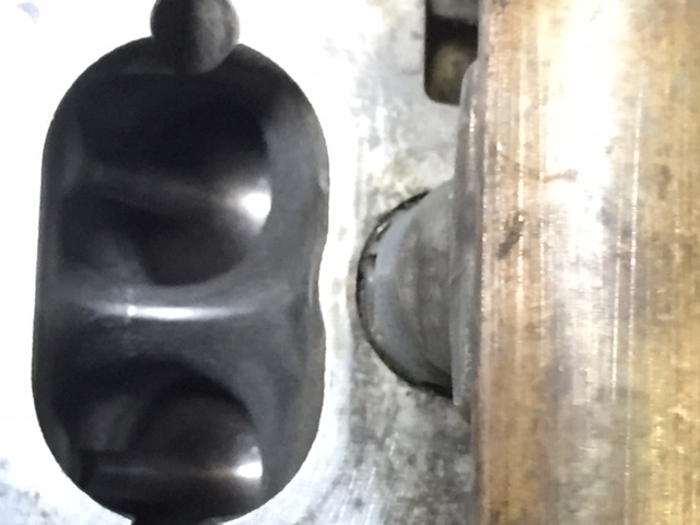

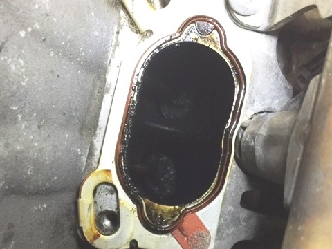

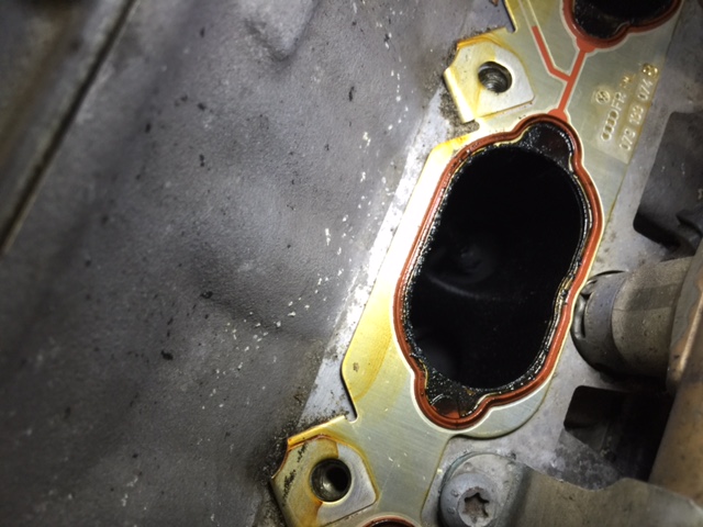

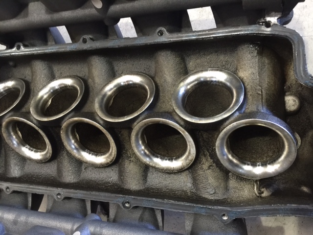

So manifold off, and here are the pics. :audibash:

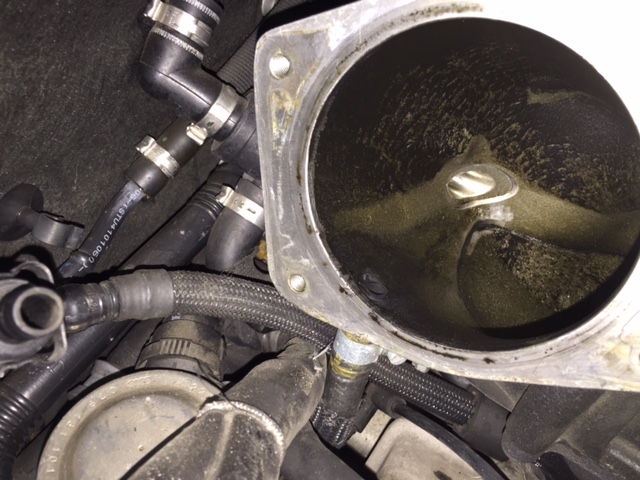

They've advised a quick (basic) carbon clean, and replacement of the cyclone breather pipe as apparently there is oil/grit everywhere.
Manifold has already been deflapped which is good (Kev said it was, but MRC didn't have a record of it being done by them so weren't sure.)
Once that's done, they're going to tweak the map to suit my intake and exhaust and we'll see where we are.
The pics reinforce the view I've had since having the clean done. That is, that the hydrogen clean does nothing for carbon buildup in the manifold, but registers improvement (which I can't ignore completely) by virtue of the italian tune effect and possibly cleaning inside the combustion chamber on back.

Without wanting to piss on the hydrogen carbon clean fire - to anyone who has scraped this stuff out there is no way on this earth passing a gas over a running engine is going to remove the carbon build up, sorry but that is just fact. Even if it did you wouldn't want that dropping in your cylinders!
We use a BG product two stage chemical for cleaning the carbon with the inlet off, it softens but doesn't help that much and still needs scraping to loosen the chunky bits then we use a walnut shell blaster to finish the clean.
The hydrogen gimmick is right up there with the oil additive that replaces worn metal on your piston rings and the magnets on your fuel lines that give 20% mpg increase :rant: over :)

I had a 'hydrogen carbon clean' done a long while back..... the difference wasnt very noticeable and while its chemistry sounds impressive, theres no way it will remove solids.
During the cleaning process, the operator does around 10 red line revs and holding them for about 5 secs each time..... made me cringe.... but i suspect that does an effective job of blowing the cells through in the CAT...... and thats about it. An 'itallian tune' effectively.
Ive recently had the full manifold off carbon clean and porting done..... and the difference was intense!
So, i wont be bothering with the voodoo of hydrogen cleaning again.

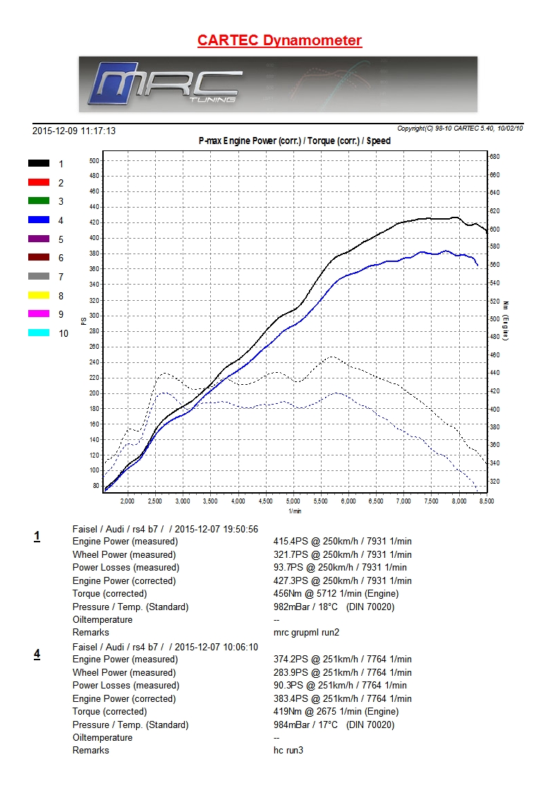

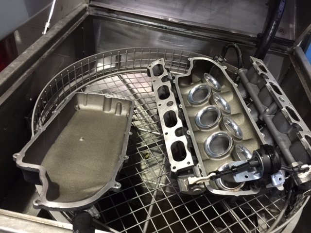

So the (proper) clean has been done! +44hp --> 427 PS :biggrin3: :jump:
Pics of the cleaned parts, and before/after dyno
The guys at MRC noted that my intake really didn't help dyno figures. Even with fans on and bonnet open (which they do for all runs), intake temps were 15 deg higher than they would expect with a stock airbox. Hopefully different on the road!
I'm undecided now whether to a) keep the intake for the great noise and not worry about dyno numbers, b) go back to a stock airbox and decent filter, or c) double down and get a cold air feed next!
Something else interesting. They watched my hydrogen clean vid and they noted the dyno runs were done with bonnet closed and fans not best placed. They think those are the main reasons the power registered lower.
Seems these cars are really really sensitive to intake temp!
Draw your own conclusions about the hydrogen clean....

Just drove it home...holy crap!!! That made the world of difference! I actually enjoyed slow drivers pulling out into the outside lane of the motorway, so I could floor it when they pulled out of the way! Every time I looked at the speedo though I was doing 10-20mph faster than I thought I was...
Anyway.
I had a good chat with Doug when I picked the car up. Some useful words of wisdom from the man himself.
On the revolution intake; he thinks it costs 10-15hp on the dyno, but might not be so bad in the real world. Reason for that is they can't get enough airflow to keep the intake temps down with the intake on the car. Optimal setup (for dyno at least) is standard air box with cold air feed, intake temp might be within a degree or 2 of ambient. He also reiterated that the MAF misreads once you have the intake, so he applies a correction factor on the map to compensate.
On the hydrogen clean; he thinks it might well clear out some gunk post-combustion, but he also thinks it might have actually spewed some crap in the manifold! There was oily gunk everywhere, including on the throttle body and breather pipe which he said was odd.
I'm pretty convinced now and feel I have enough info to confirm that I don't want another hydrogen carbon clean! I can see it having some benefit for some cars, but it does nada for carbon in our manifolds.
Sorry for boring you all with repeated posts on this topic, but I think I'm done now. Off to enjoy my MRC restored 427 PS! :-)
