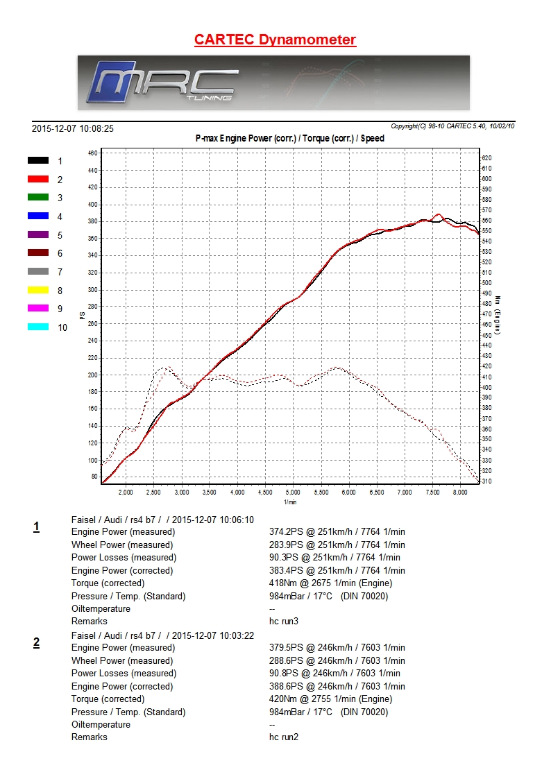

Post by FaisalJ » Mon Dec 07, 2015 1:09 pm
My car's at MRC for a couple of days, to diagnose why it's down on power (made 380ps ~ 375bhp on their rollers this morning).
On the advice of Doug and Ben, have given the go ahead to pull the manifold and have a look inside. We're also not sure if the car was previously deflapped. If not, might get that done too. Good opportunity to get some pics, so we can see what's going on inside with regard to carbon following the hydrogen clean a month ago
Place your bets now...

Did they confirm there were no vac leaks? Kev would know if it was deflapped surely?

I'd be surprised if even an MRC cleaned engine wasn't coked up again after a month of normal usage.

Post by S4Player » Mon Dec 07, 2015 3:18 pm
Seen pics on Instagram seems like the hydro clean done absolutely F all
