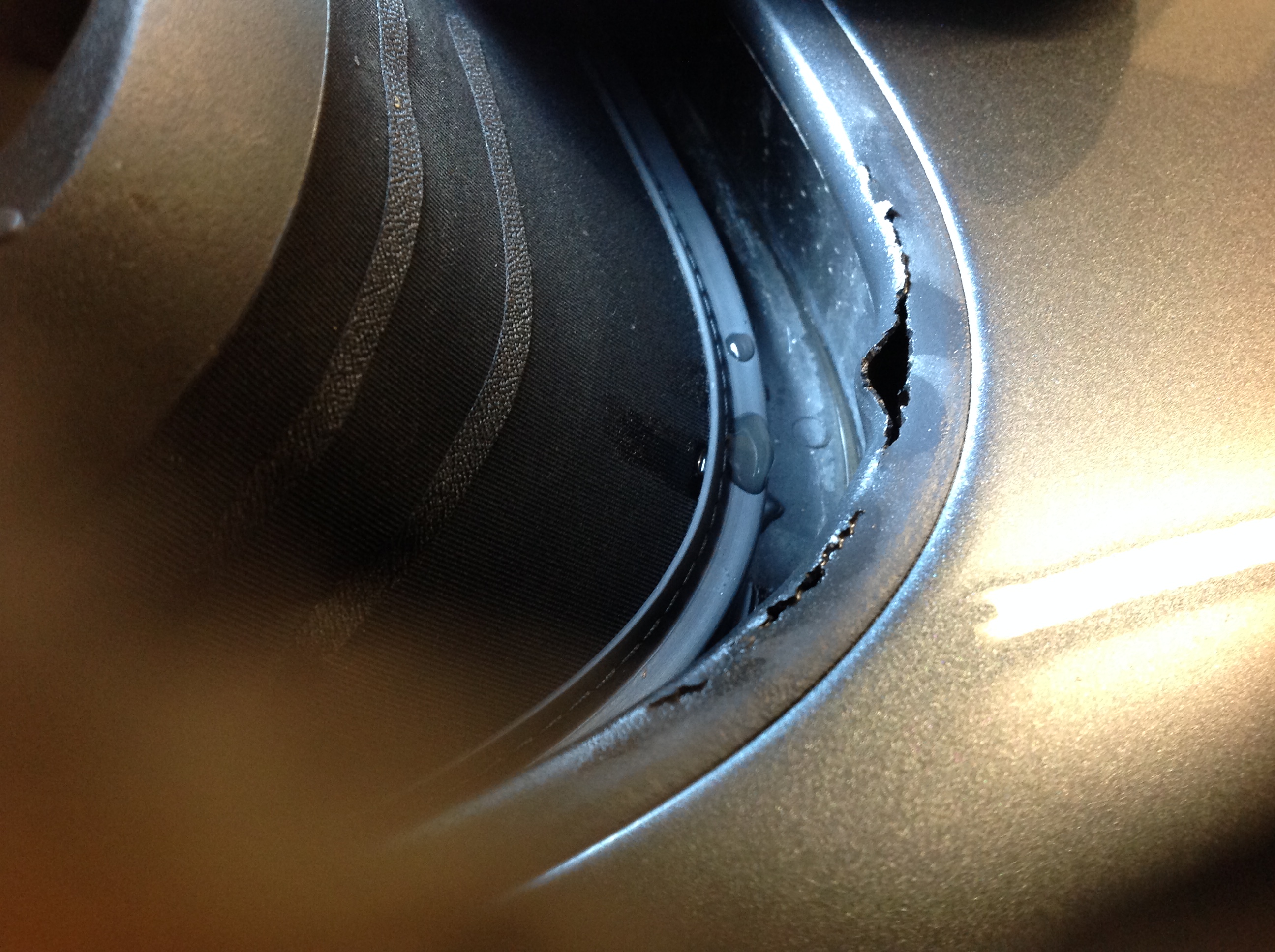

Has anyone got a b8 with a pan roof ? Mine are basically splitting and disintegrating with 8k on the clock, just wondered if anyone has tried Audi on this one.

Tried to get a pic of the seal in this not sure if it worked !! This car is only one year old !!

Dont look good take to audi before water gets into car. was told by audi when next in for service need to do sunroof as part of service.

Mine seem ok in my car(23k miles), but my first B8 had lots of squeaking from the pan roof, which Audi initially silicon greased, and then it came back, so they ended up replacing them
I did note that when I had my first service at around 7k miles on the second car, you had to pay to have the pano roof serviced too, which I didn't on the first one.
If yours is splitting, then they should have no problem just replacing all the seals under warranty

Many thanks guys for your input, I phoned my nearest dealer highland Audi and they have asked me to take the car in to them for a look on Monday. They did say that they havnt come across this before so I'll see what they say when they see it.

Just got mine back from Jack Barclay and they silicone greased the roof for me under warranty.

Update on my pan roof seals disintegrating problem.
Took the car into Inverness Audi last Monday and they took photos of it. Phone call tonight to tell me that it is not an Audi /warranty problem.
There conclusion is that the cracks in the seals are caused by birds or some other outside influence ! They have also said that they have never seen or heard of this before. Am I the only one that this has happened to ?

Re: Pan roof seals
Sorry to here of that outcome, maybe you've got to argue it stronger to get anywhere.
