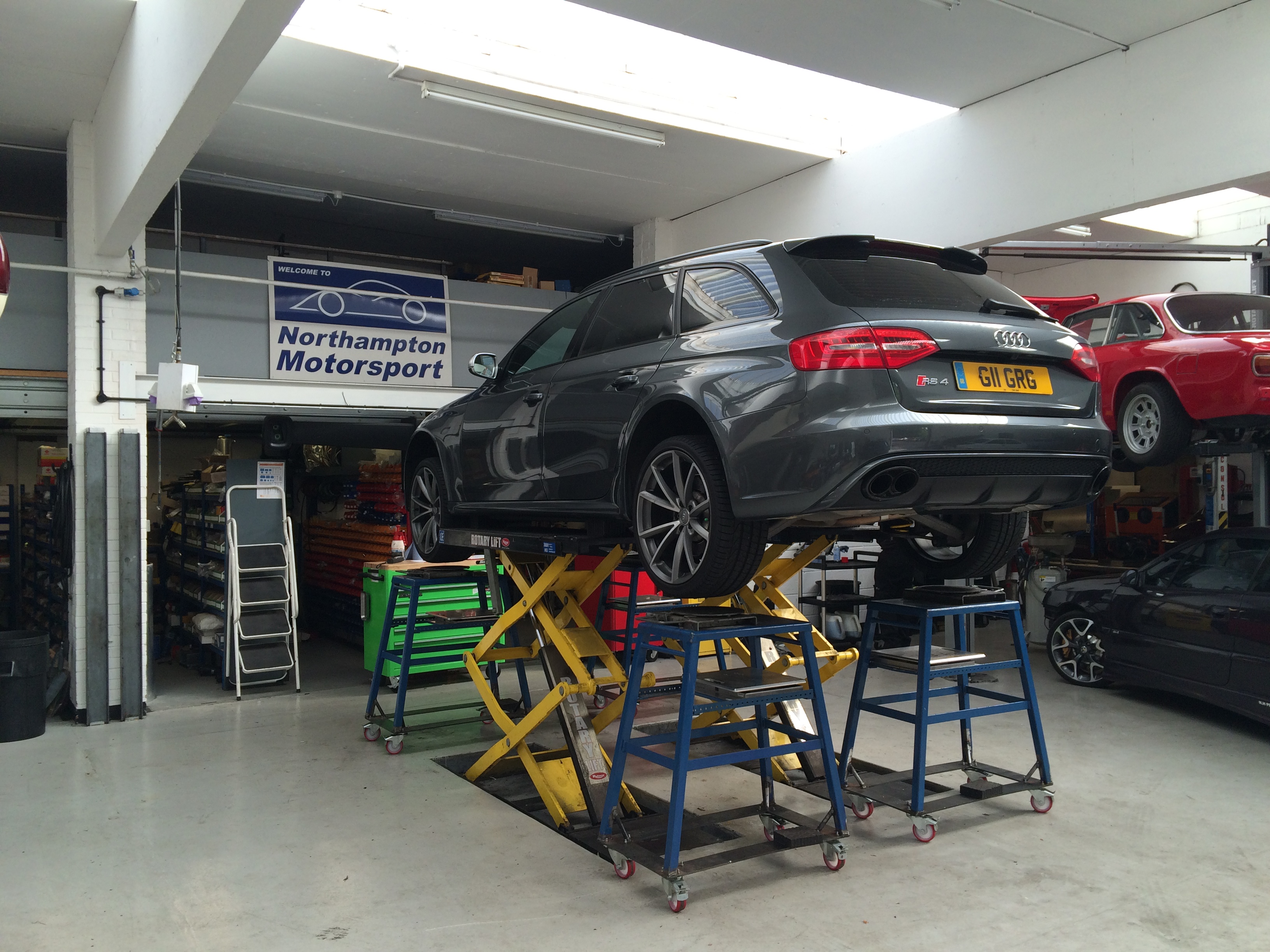

These lot!
Amazing what the real Issues were after dropping it, besides corner weight balancing.
I'll do as the rest do and keep it to myself!

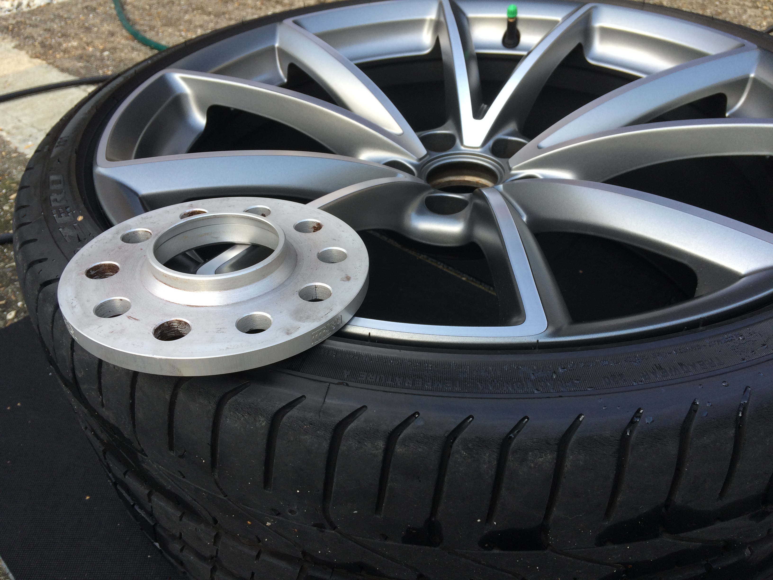

One thing for sure the spacers are a bad bad idea,
Even after fitting Eibach control arms there are other issues!
Depends on whether the look is more important than the handling!
I chased the handling!

Daytona Greg wrote:Corner weight balancing !
Let us know if you have any additional work done and how it feels / handles on the drive home. Looking to do this shortly too.
Audi fitted my control arms, I have to say mine drive spot on, what are the other issues they have found ?

I had 034 Motorsport arms fitted, then 4 wheel alignment,it's not rocket science to set it back up
Cant see why you should have any issues with spacers as long as they are the same dimensions front to back, ran them on my b7 for best part of 5 years with no issues

Did Northampton Motorsport tell you spacers were bad? If so, what reason did they give? Assume you are now running without spacers? You mentioned there were some issues, what issues have you had with your car's set up? Did they need to adjust via corner weighting much? How was it it balanced in stock form? How does the car drive now?

You had the cheap adjustable control arms fitted then ! (O34 motorsport)
You had them fitted relating to just the spacers?
No alignment is not rocket science, but if you've only had spacers fitted why would you need adjustable control arms? Although if you haven't had the vehicle dropped on coil overs you may not understand all of the issues I've had, and I assume so as you don't know what the issues are with ALL of the alignment data!
I'll say no more because I find this site is full of everyone that knows everything, although no suggestions came from this site what so ever, King sarcasm site.
I've had so many B7 owners quote I've had no problems with spacers, mine is a B8, the spacers have affected the TPS and likely to have had some effect on DRC, there are sensors in ABS and wheel speed sensors, guess what spacing the wheels from the sensors created issues, let alone (10mm) the handling and turning charactistics are altered, and this effect increase with speed.
